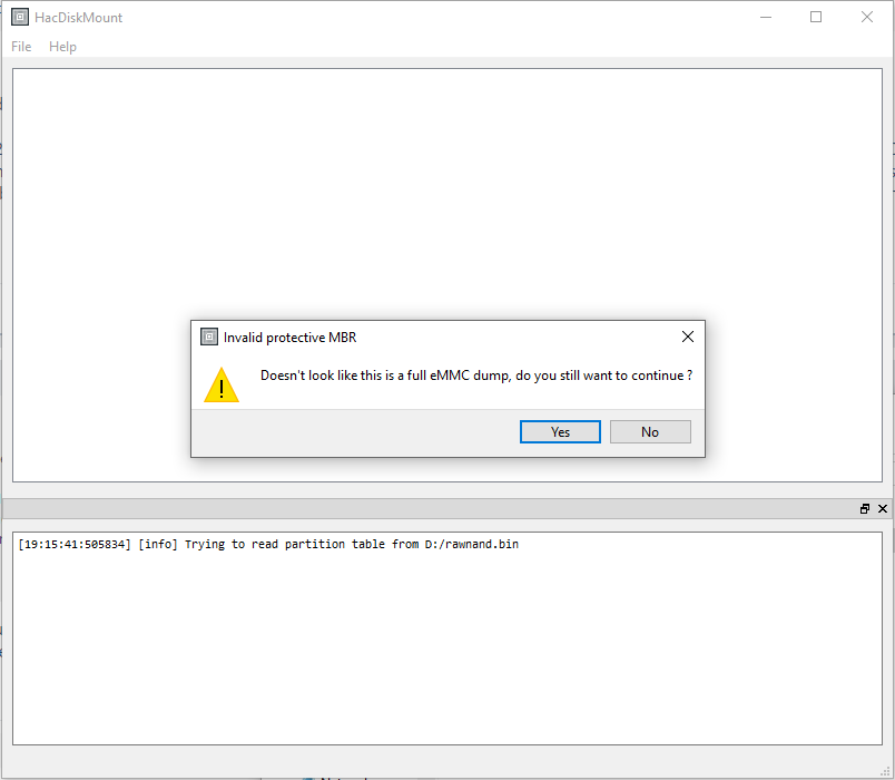

  20. deanspeed
    deanspeed Member
    Apr 24, 2018
    When trying to mount my rawnand with hacdiskmount I get this error messages:
    After hitting yes, I get this message:
    Any ideas what the problem could be, or how to fix it? I am trying to retrieve my saves.
