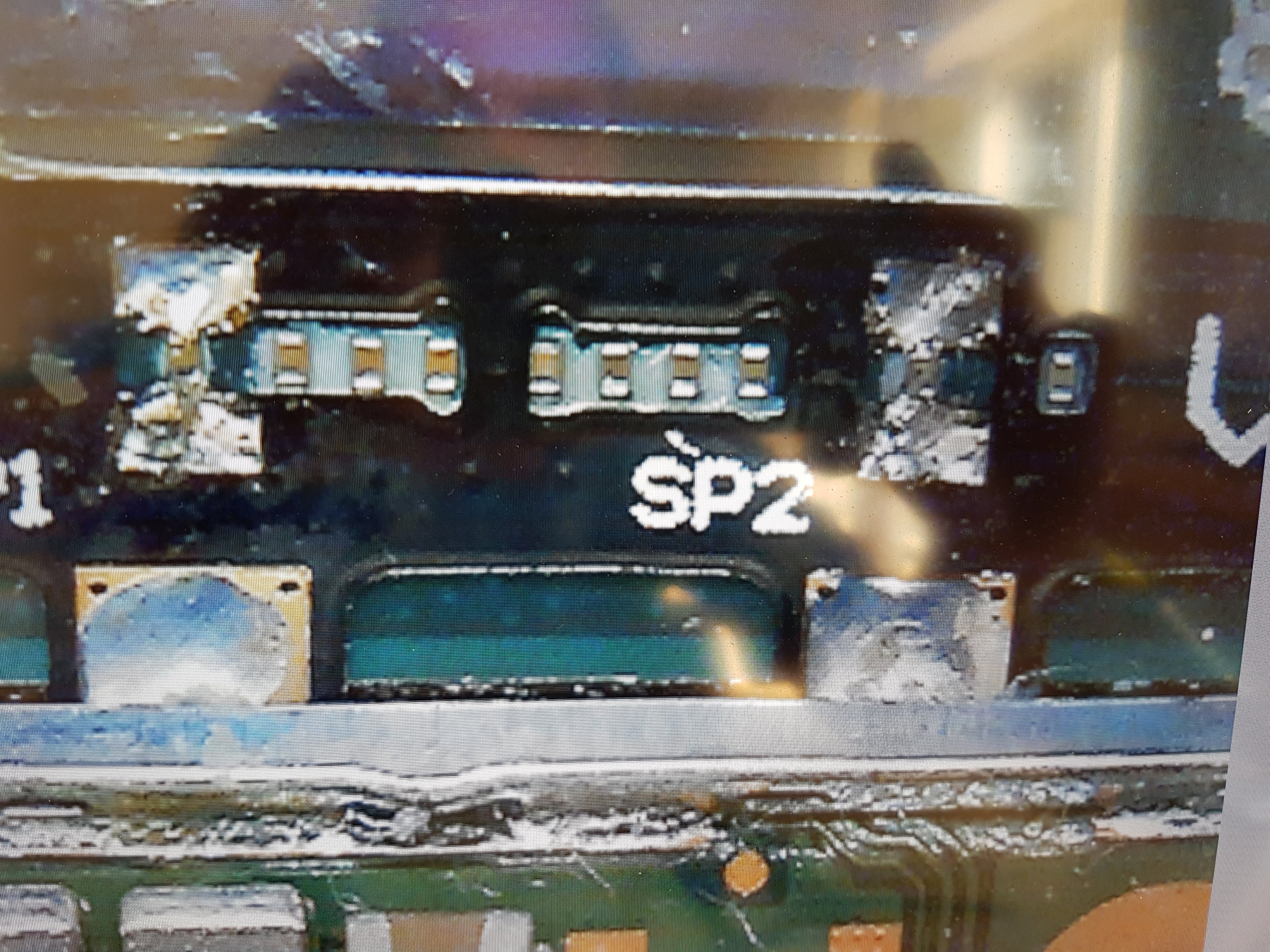

View attachment 215786 Hello iv'e just soldered the core on a v1 but now it wont turn on even with charger in
so it's not because lack of battery.Any ideas about what im facing here.
is it because it wont run if it's to hot.it's pretty hot in my room.
i have this pic if you guys can tell anything from it.hope not it is bridging

Did you plug the nand chip on the modchip and not on to the motherboard? I also heard that people plugged the nand chip on to the motherboard and the Switch doesnt power on without giving any leds on sx core. A overall picture would be nice

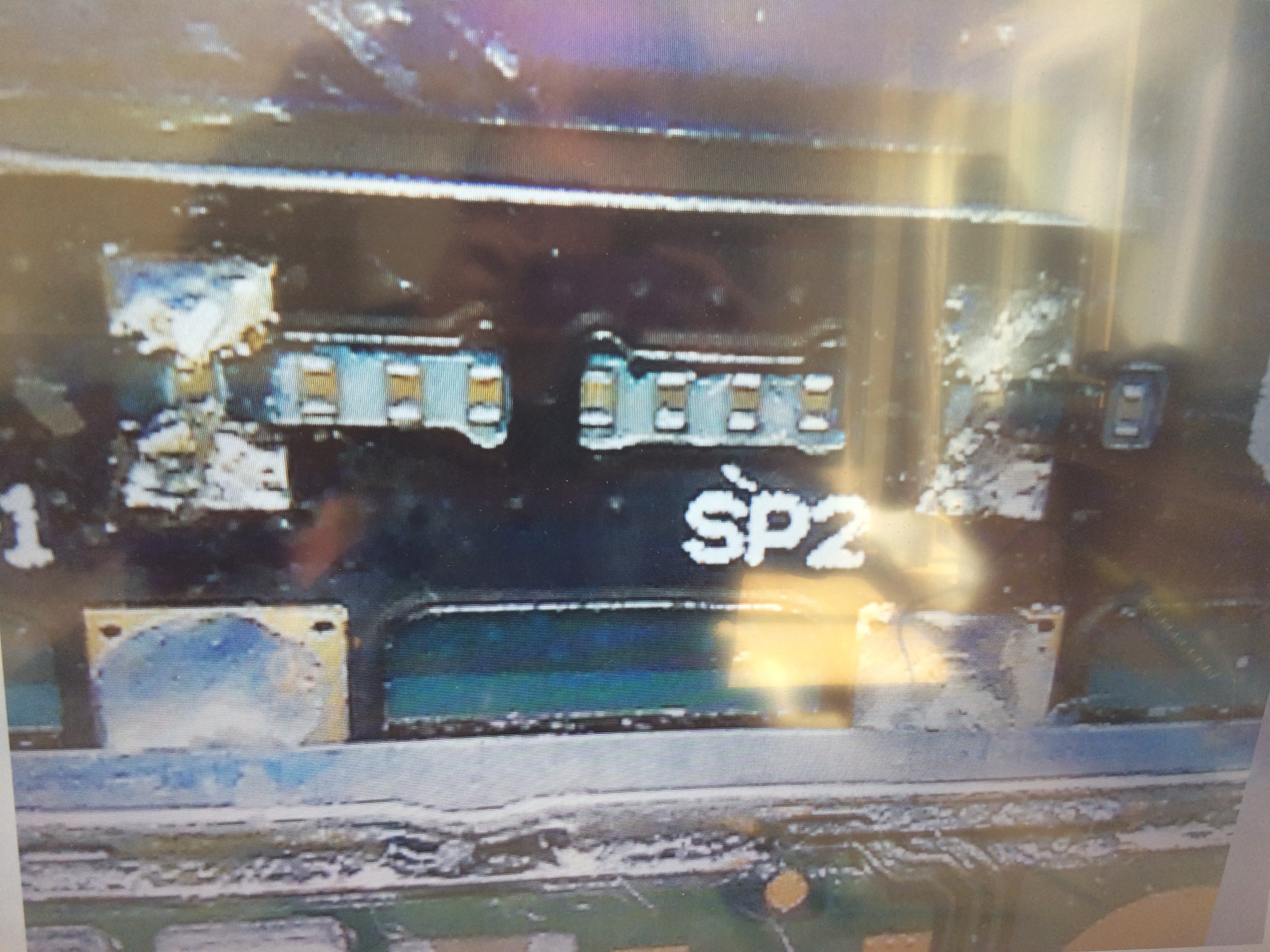

IMG_0162.JPG IMG_0165.JPG sorry about the quality of the solder pic
tried to resolder because i thought the solder wasent touching the capasistor points.

you should take off the metal shield from the nand. you may have shortcut the modchip.
yes but it wont turn on even with the chip attached
View attachment 215804 View attachment 215805 sorry about the quality of the solder pic
now tried to attact the nand back to the motherboard but nothing still wont turn on.

On the second picture, you already plugged the nand chip , where it belongs to but you must take the silver alu-shielding off. You can shortcut the modchip or maybe because of the alu-shielding, the nand chip does not connect properly.
ok will try that.but is it normal that the switch not turning on without the chip attached

It may be normal, I did not test it with mine but if you want to check your soldered connections, use multimeter and test the connectivity on both solder points.

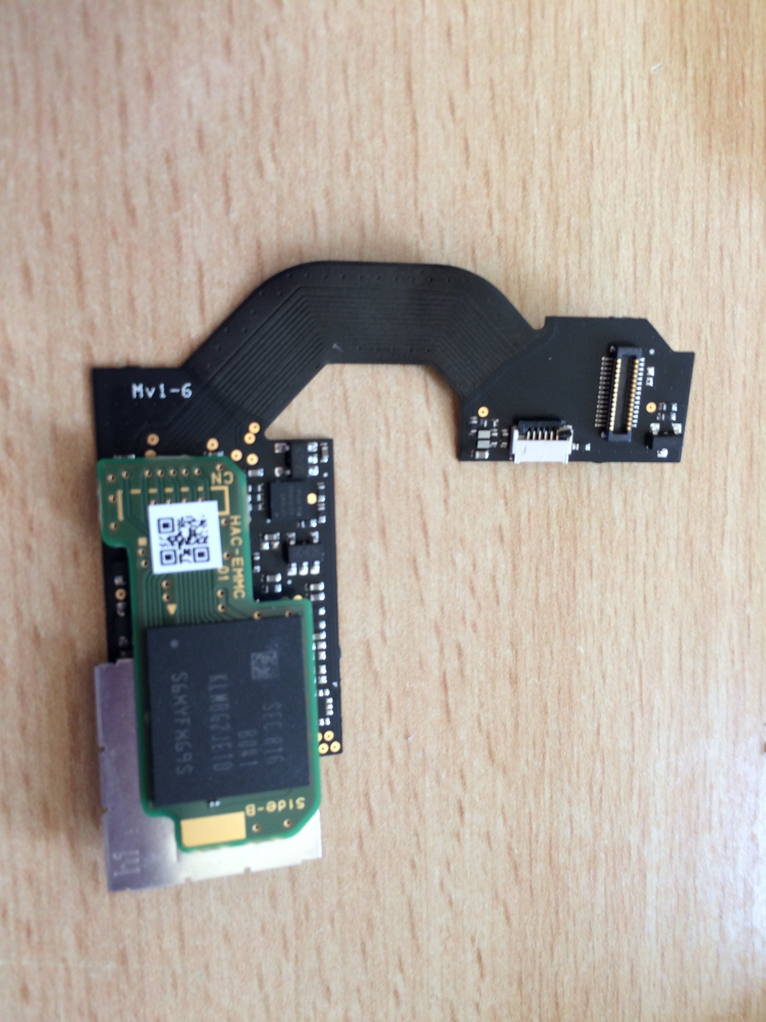

There is the problem, you did not connect the first connector, near the cable where it says "up" to the motherboard. From the image I can see it is not connected
I marked it on the picture with a red marker, there is the second connector on the modchip, that you have to plug it on to the motherboard. then it should work
CWNTV4R
I marked it on the picture with a red marker, on the motherboard there is the second connector on the modchip, that you have to plug it on to the motherboard. then it should work
Jesus..Your right now i got blue light what does mean and do i have to turn on the switch to test.
