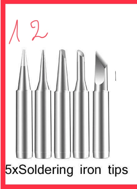

    38
    Country:
    Please which soldering pin should I use..while installing the SX Core B35B251F-7B80-4D10-B92A-536F78B9D425.jpeg
    I have joined a picture please
    Thanks
  3. Nerdtendo
    Nerdtendo Your friendly neighborhood idiot
    Joined:
    Sep 29, 2016
    Messages:
    1,395
    Country:
    Thinnest is best. It's a small solder pad and the tip wont run as hot.

  4. WackyRaces
    WackyRaces Newbie
    Joined:
    Jun 20, 2020
    Messages:
    4
    Country:
    Personally, I’ve had the best experiences with tips 3 and 4. Get the pads pre fluxed, and with the tips straight edge, hold it against the component and feed the solder in. Pointy edges don’t tend to hold heat in my opinion as the straight edges. Besides, you can rest the straight edge against the component whilst you fumble with the solder lol!
