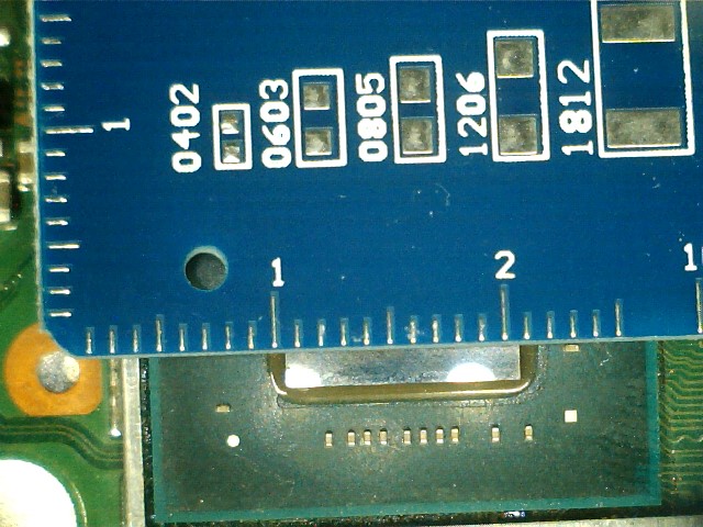

    I wouldn't mind knowing this for certain so I can get some extra practice in (without unnecessarily cracking open my switch ! )
    Dimensions are..
    Size Length (mm) Width (mm)
    0201 0.60x0.30
    0402 1.00x0.50
    Which are they? They look like 0201s to me :-/

  11. MrSandstorm
    MrSandstorm Advanced Member
    Joined:
    May 17, 2020
    Messages:
    59
    Country:
    Brazil
    Because of the corona situation?
    Careful, in a convenience store you'll probably find rubbing alcohol. While that is mostly IPA, it's not the same. For cleaning electronics you ideally want 98% IPA or better.
    OK, definitely 0201. Thank you.

    wait so the caps next to the die we have to solder too are even smaller than the 0402 size SMD's ?
