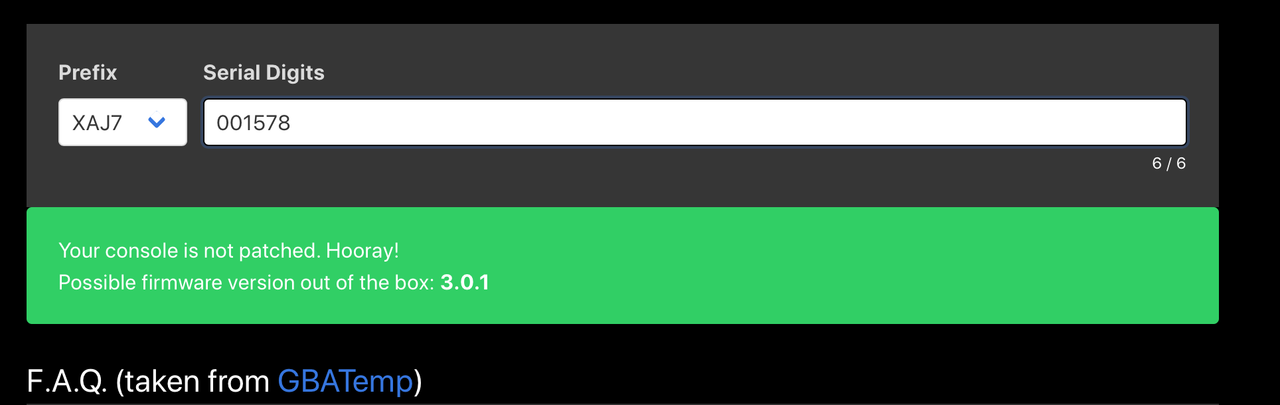

Why are you using XAJ1 as prefix when the serial is XAJ70015785476
I press wrong one. Sorry.. Now here it is.. Yeah. It is not patched.

I don't know what you entered, but for me it shows that the Switch is unpatched. Also, wouldn't a patched Switch be recognized by the RCM tools as well but just wouldn't be able to actually exploit the Switch?
