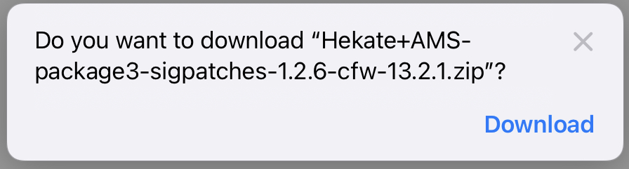

not the sd card, the game card. The Legends Arceus I want to play digitally on my hacked switch so I can trade with my second switch
I just confirmed those are the exact same Sigpatches I’m using. To be sure we can try the iTotalJustice sig patches but nothing we’ve done thus far would have done anything regarding the Game Card.
I also just updated hekate and atmostphere and updated to to the newest compatible firmware. I remember last time I had to change something in one of the text files to read carts again, what was it I needed to do that with?
