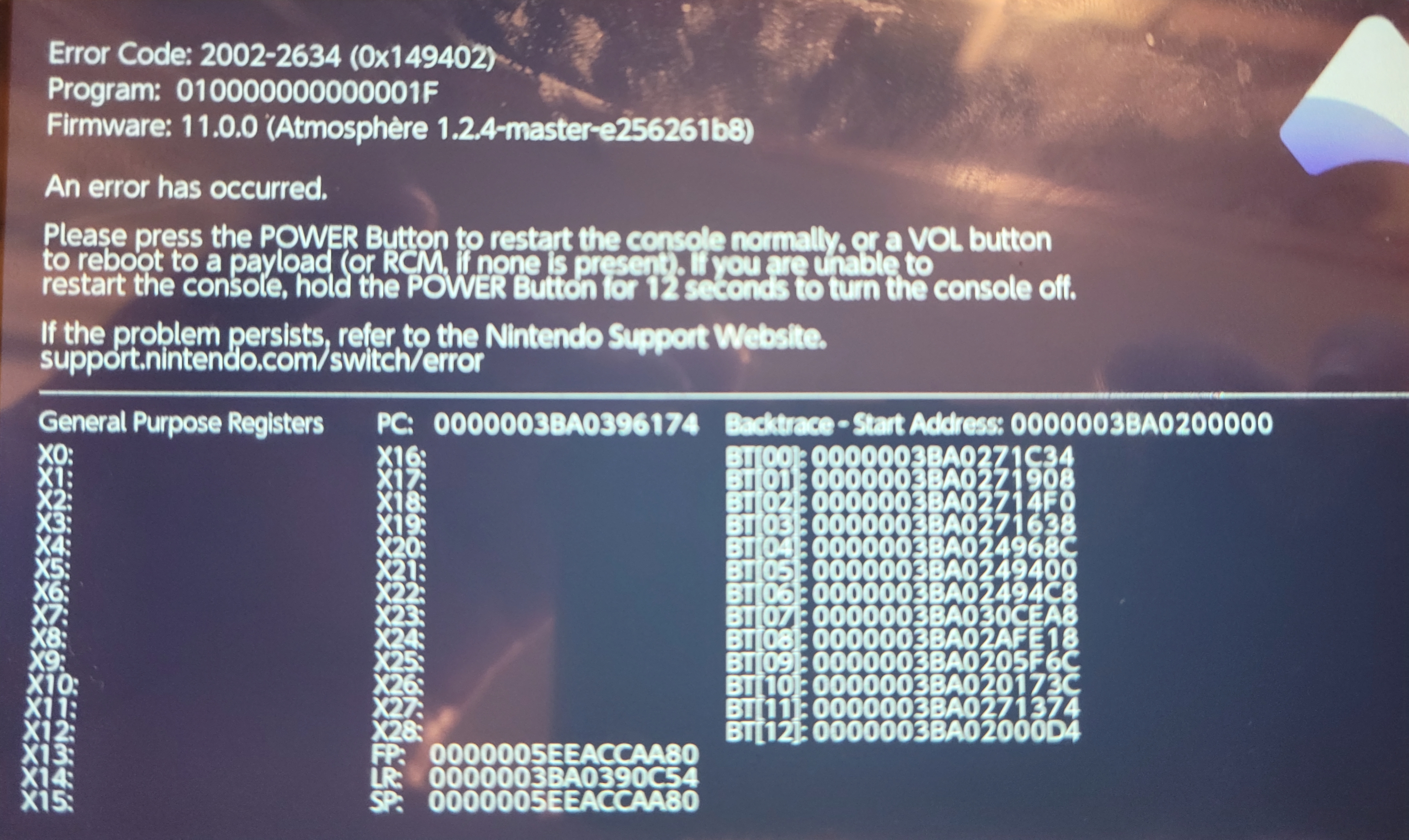

Well what is the error message?

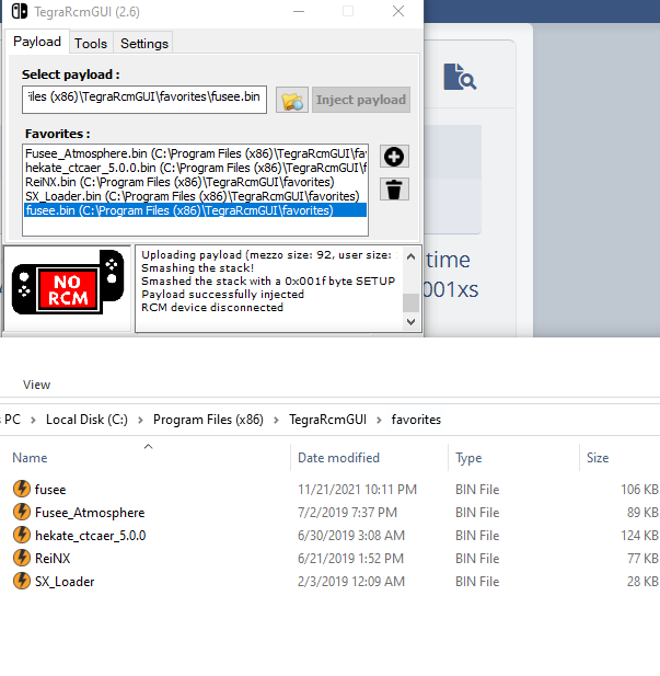

Picture below. Ended up deleting Atmosphere and the bootloader folder and redownloaded them both. Still get same picture
Not sure if relevant, but Im using TegraRCm 2.6, and normally would use payload labelled Fusee.Atmosphere, but that isnt working, and now tried the one labelled fusee.bin and its not working either. Still gets to the 2 Atmosphere logo screens then black screen.
[/SP
Edit: Think I fixed it. Guess somewhere in the past year we arent supposed to have Gamecards in here anymore? Just randomly took it out and started it back up and my EmuNAND loads up now
View attachment 286403[/SP
If your emuMMC firmware is lower than your sysMMC, that would explain why. The cartridge slot firmware on your console is updated and on a higher firmware than your emuMMC. The only 'fix' is to update the firmware of your emuMMC.
