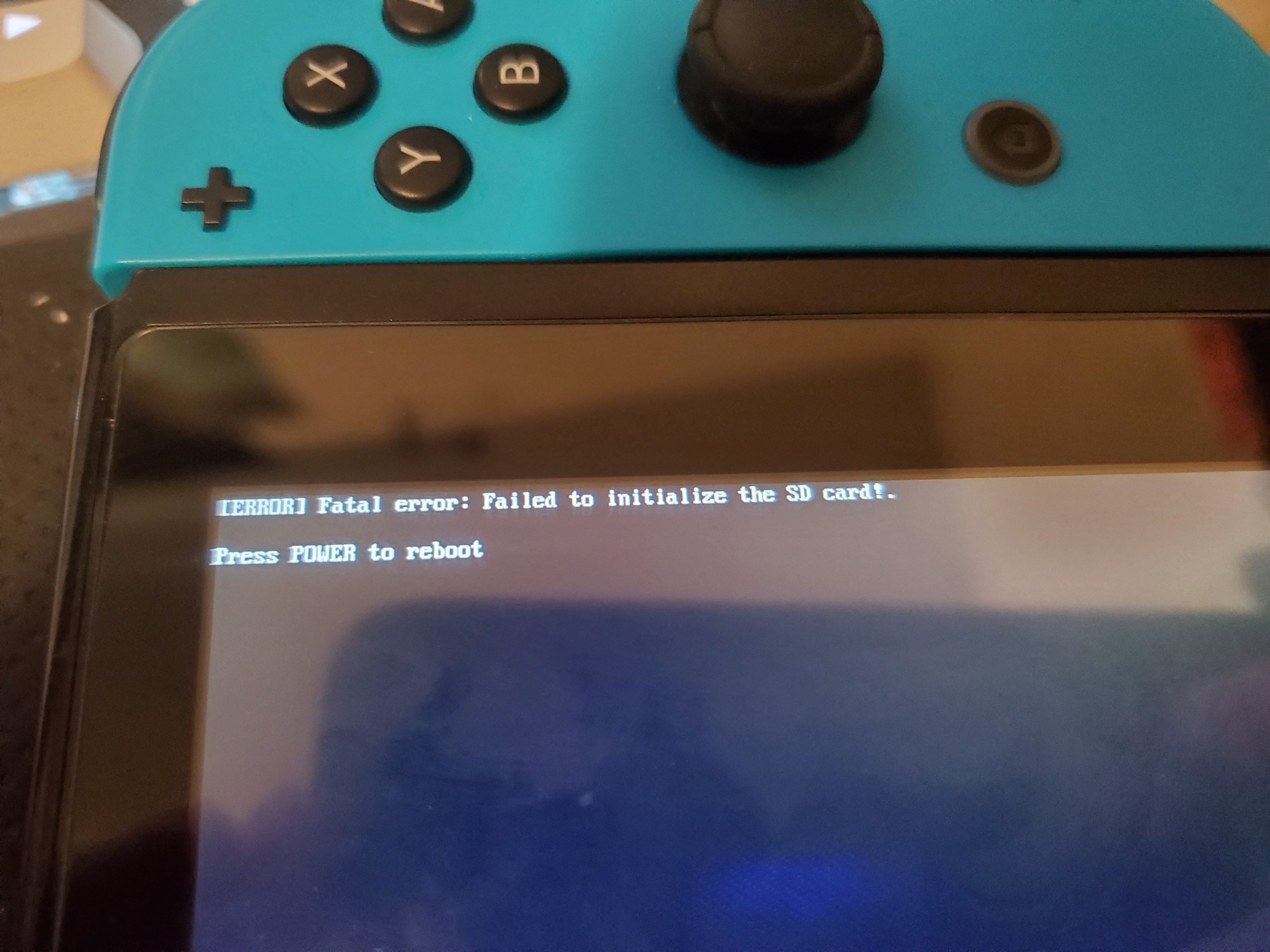

    OK update got a new SD card and now I get this when loading into received_273485760651802.jpeg
    I made sure to use a new download of the newest software everything for atmosphere. Right now I just ordered the part for a replacement for the SD card reader. So maybe that should fix that error. Another thing I just found out that's really weird when I try to boot up and launch the system it will go completely black on the screen but then I found out something weird if I try to replug in my switched it shows are rcm but instead of launching into the switch it goes back to the main page being ready to launch up the screen 20201026_151743.jpg .... sigh it acts like it stuck in recovery mode.

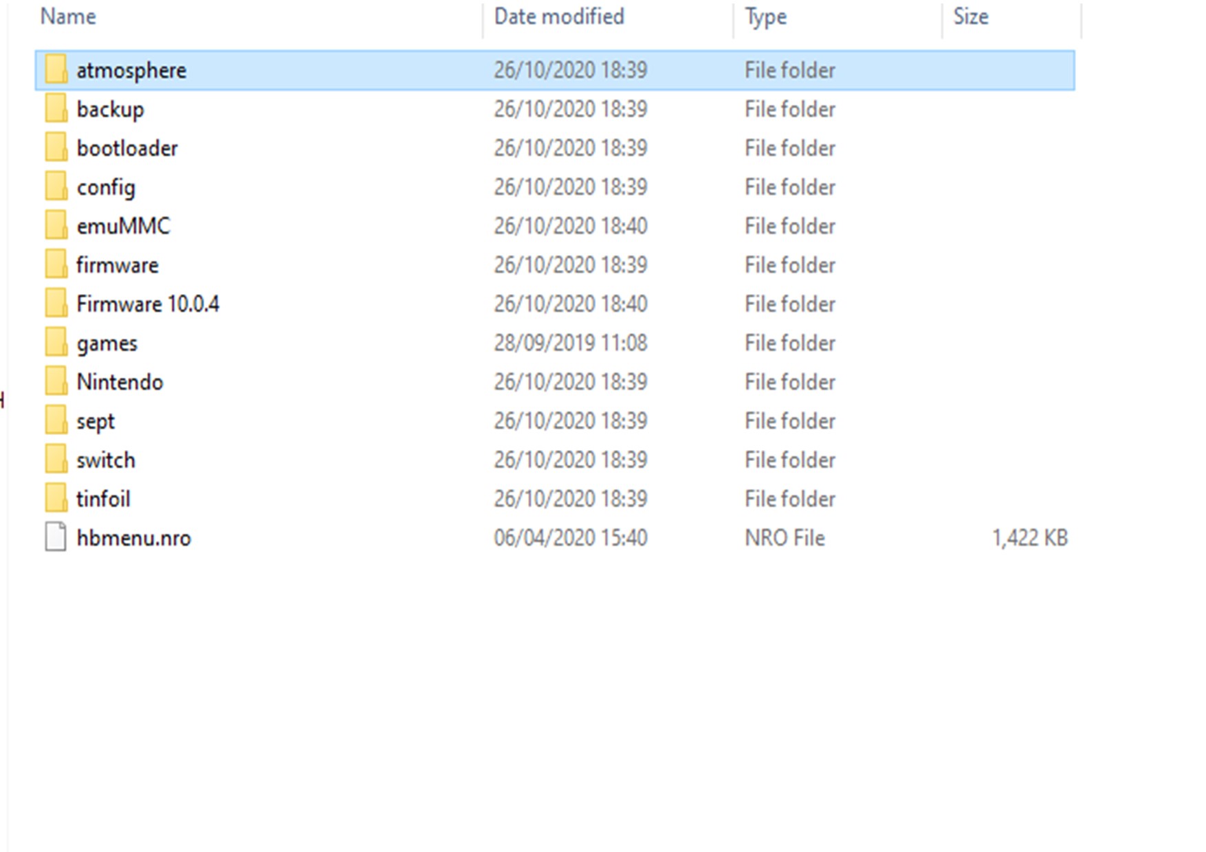

    Hi again,
    so I have finally resolved that my sd card is corrupted and I cannot get the cfw to boot. I have tried an old cfw sd card and it works. Originally followed this guide https://nh-server.github.io/switch-guide/ so I have backups of the NAND and prodkeys and prodinfo, etc. What method would I use to completely clean the SD card and start again using emummc so that nothing is affected and I can restart from scratch.
    Attached is how my setup looked before as a reference
    I would've thought things may be more refined since the guide I used :lol:
    thanks all

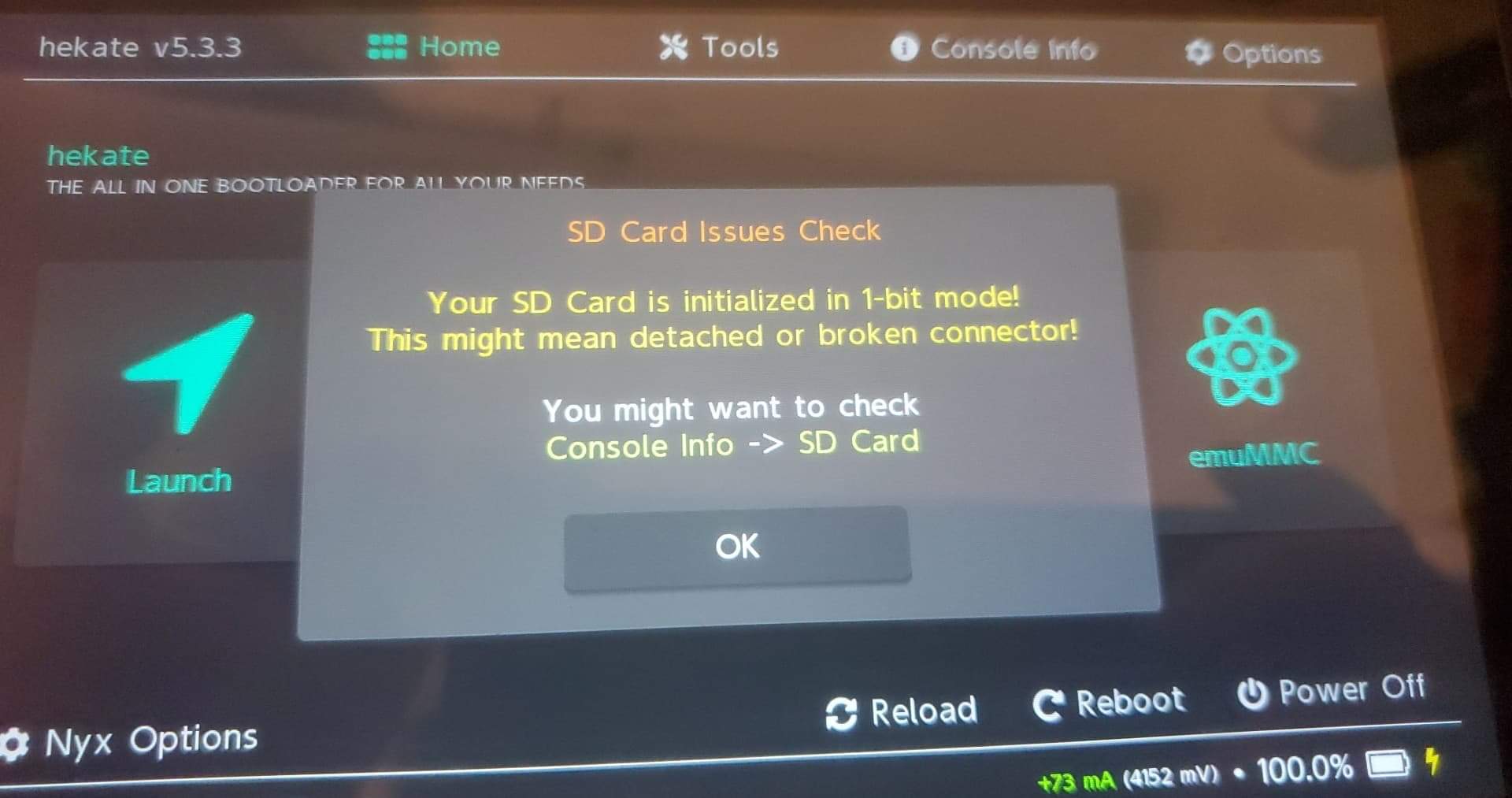

    bad sd card?
    The only way I would fully trust is having an original clean backup you took yourself. They even say it may not 100% work on the github. - in saying that its probably better than messing with a tonne of files manually. Make a backup first.
    Use usb/network install with tinfoil or awoo installer.
    You might have a damaged pin on the actual motherboard side of the microsd card connector, which I've found is the more common issue over the actual card reader itself. There are people that can repair it based on your location, however.
    Use guiformat to put the sd card to fat32, redownload all the cfw files and place them from the new download on the fresh formatted microsd card. do not use the ones already on there as they are likely corrupted. Then follow the guide like normal for setting up emunand

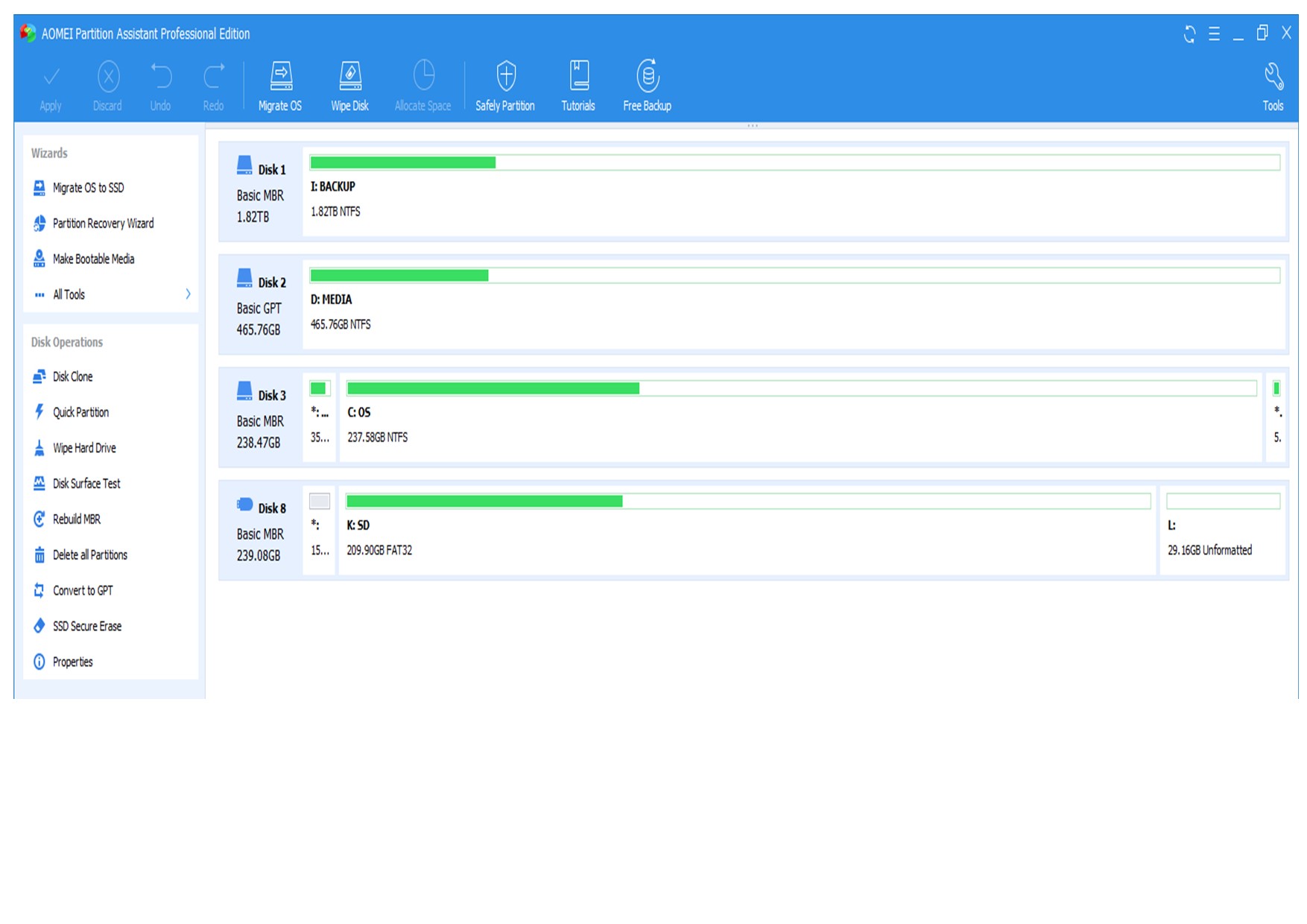

    So just show how my sd is currently partitioned - should i delete all partitions then setup the same way or just use guiformat on a specific partition?
