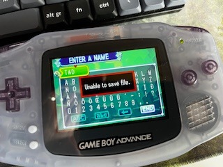

I thought I'd try again with minish, but this time completely deleting the save file.
When the choose a flle menu pops up I get this when a scroll over a save slot
Then if I actually try and create a new save file I get this..
When I put my normal save file on there, it can see it and load it, but again when I try and save I get the unable to save file error.. :(

Hey there!
You guys were right, there's a bug in the EEPROM direct save codepath. I just fixed it :D Uploaded version 0.8
I tested also Minish Cap and now it seems to work for me too (and perhaps a bit faster, even tho it's quite slow for EEPROM).
