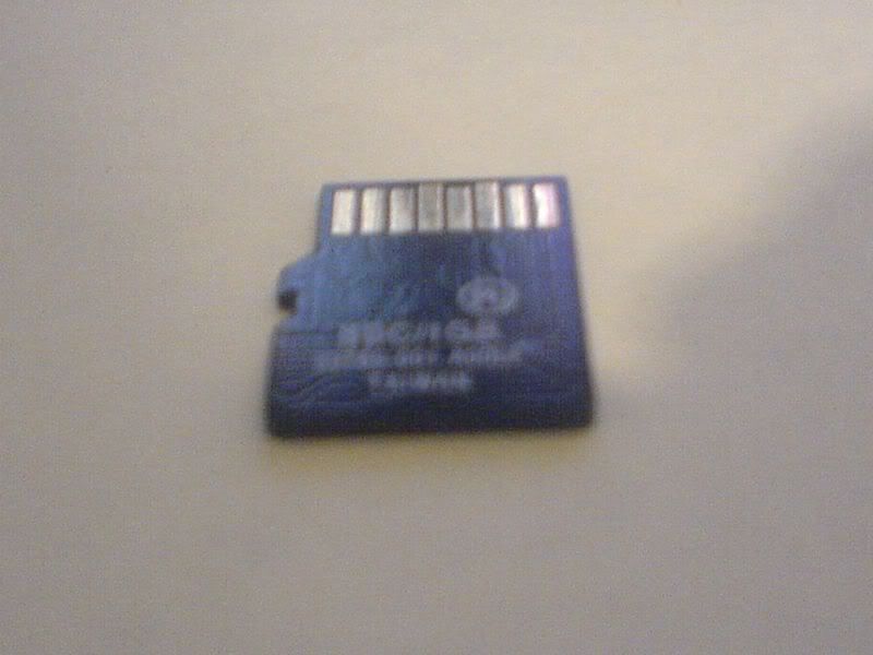

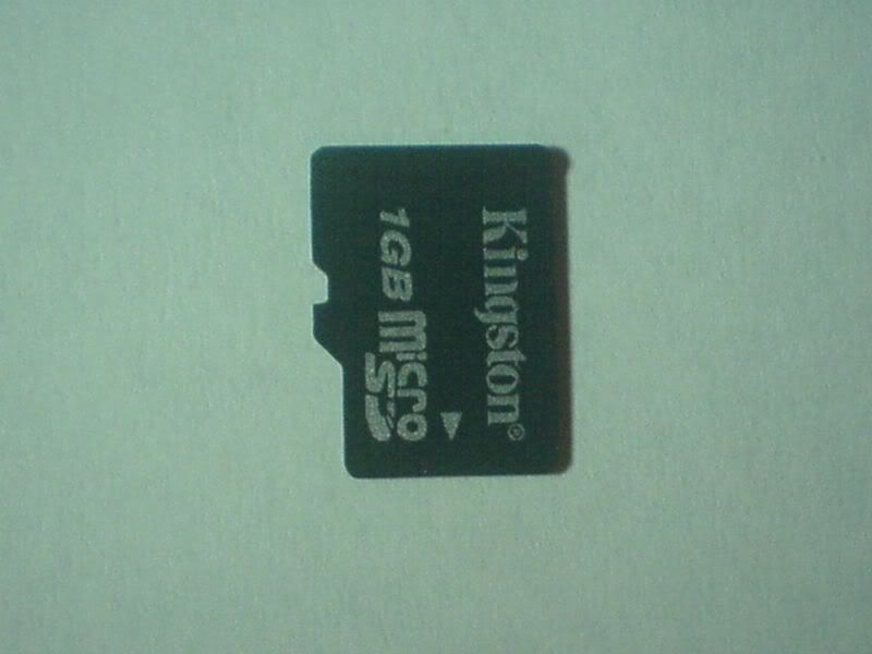

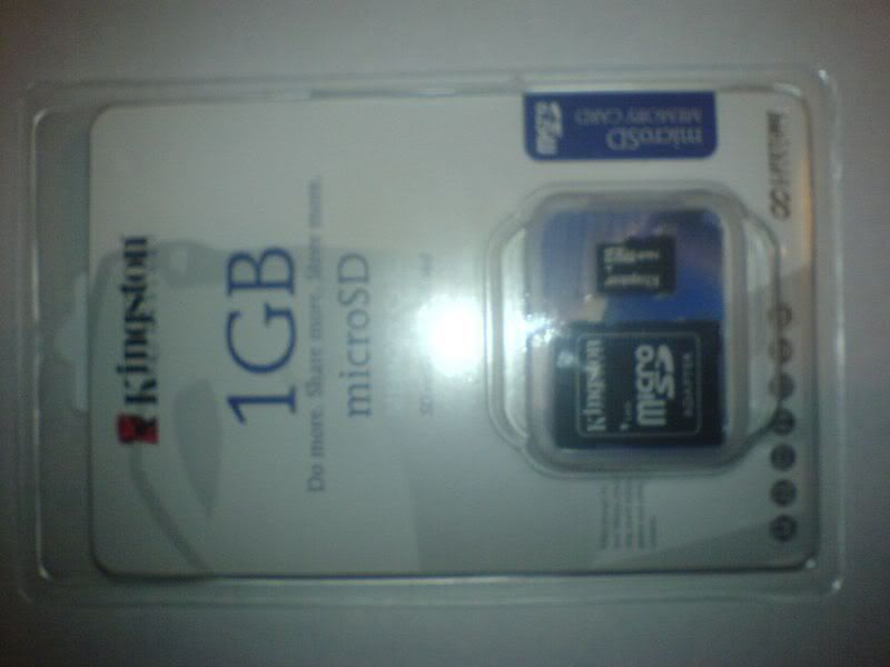

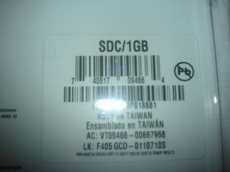

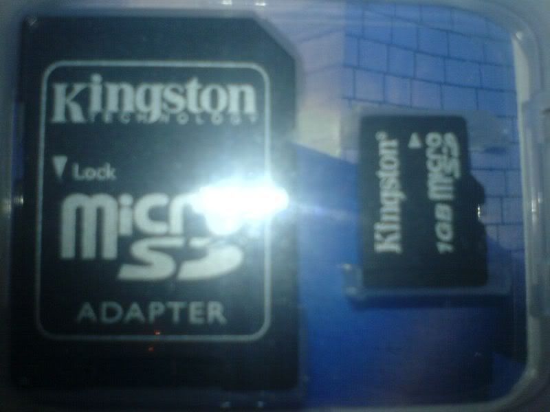

1. the kingston taiwan comes in a case opposite from the japan model taiwan model comes in a case where the microsd card is to the right and adapter is to the left.
2. taiwan model has printed letters on the back (where contacts are). heres what mine says
(Pb)
SDC/1GB
30785-001.A00LF
TAIWAN
3. if you look at the back where the contacts are and use the light you can see the micro circuitry on the card. (no black square like sandisk or other cards)
4. matte finish on the front, and shiny finish on the back
hope the pictures help, will replace with better ones asap.

Mine looks exactly the same so it must be real. Thanks for the pics. When I get it replaced I'll see that I either get a japanese replacement or a sandisk. I don't trust the taiwan kingstons anymore.
