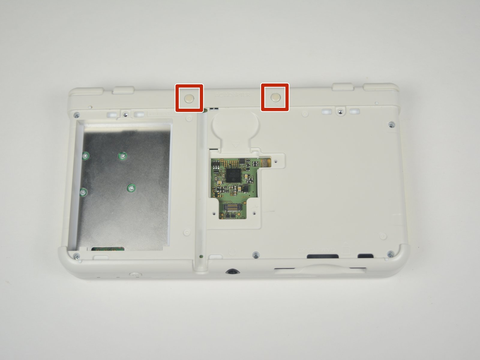

You mentioned in PM your n3DS feels hotter than usual around the microSD slot area since hacking it. Remember that link I showed you where someone's n3DSXL had their microSD card fry?
What you should do is take off the back plate, play your n3DS at full screen brightness, max volume, with WiFi turned on, Luma3DS configuration set to n3DS CPU speeds, and play graphic intensive games like Metal Gear Solid or Resident Evil.
Play until that area gets as hot as possible, turn off the n3DS, remove the microSD card, and feel if it's burning.
Possible causes of the problem you've been experiencing.
1 - Despite your best effort trying to buy a good SD card, your replacement ADATA card is defective. While I don't have firsthand experience with ADATA, my observation and opinion of that brand is that because they're commonly sold alongside with those other no name or weirdly named brands on newegg and eBay, ADATA is probably comparable to quality to your Kingston. Another thing to keep in mind is Venezuela most likely does not receive high quality tech products like other countries, and whatever SD cards you guys do get come from reject batches... Unfortunately, this is something out of your control.
2 - Your n3DS has a faulty micro SD card slot reader. The only way to test this is find a known to be good SD card, use that on a different 3DS system to see if it gets hot, and then switch over to using it on your n3DS. If your reader's bad, you would need to replace it.
3 - The n3DS motherboard is dying, specifically the Texas Instruments AIC3010D audio codec IC chip located right behind the micro SD slot reader. See the black square chip in this picture.
4 - Probably not this, but the heating is actually caused by dying a battery. Only you would know if the heat is coming from battery area or SD card area. Examine your battery for bulging or swelling and observe for premature power cutoff at low battery life (~blinking red light).​
Ok, so I did that, and here are the results:
After more than one hour had passed since I started to play Metal Gear Solid with that configuration (With the additional factor of that I was playing while the AC adapter was plugged in), I turned off the 3DS and removed the MicroSD card, and it was feeling a little bit warm but it was so little that the heat was almost unnoticeable, thus I don't think the MicroSD card is the problem. The MicroSD card reader was also feeling a little bit warm but it was practically the same heat as the MicroSD card, almost nothing. Although there were three areas where the heat was stronger, but they were not hot, just a little warm. And that's, on the back of the console, the area where the game card reader is, and beneath the AC adapter port. And on the front of the console, beneath the touch screen, around the Home menu button.
Oh and, the battery very rarely gets heated up at all. I don't think that it is causing the problem since the console has only been in use for 3 years, and the battery doesn't have any bulging nor swelling, and doesn't get drained any faster than usual.

You have one of the strangest ongoing problem with whatever that is happening to your n3DS.
Game card reader: Was Snake Eater a game cart or digital copy? If it was game cart, see how the SD card can handles thermal stress with your cart's dumped *.3ds converted to *.cia -or- a similar 3rd person game (ie, Monster Hunter series, Xenoblade Chronicles, Resident Evil).
AC adapter port (area): The charging IC is located here. This would get hot if you're both heavily draining and charging at the same time. Nothing out of the ordinary.
Front, under touchscreen, near HOME Menu button: Reference pictures are terrible for the n3DS, but if it's anything like the n3DSXL, that's where the Texas Instrument 93045A4 power management IC is at. Also nothing out of the ordinary.
Battery: Just checking. In case you ever need to replace the battery some day and can't get the KTR-003 model, you can substitute with the o3DS / o2DS / n2DSXL / Switch Pro Controller's CTR-003 battery + some paper wedging.
