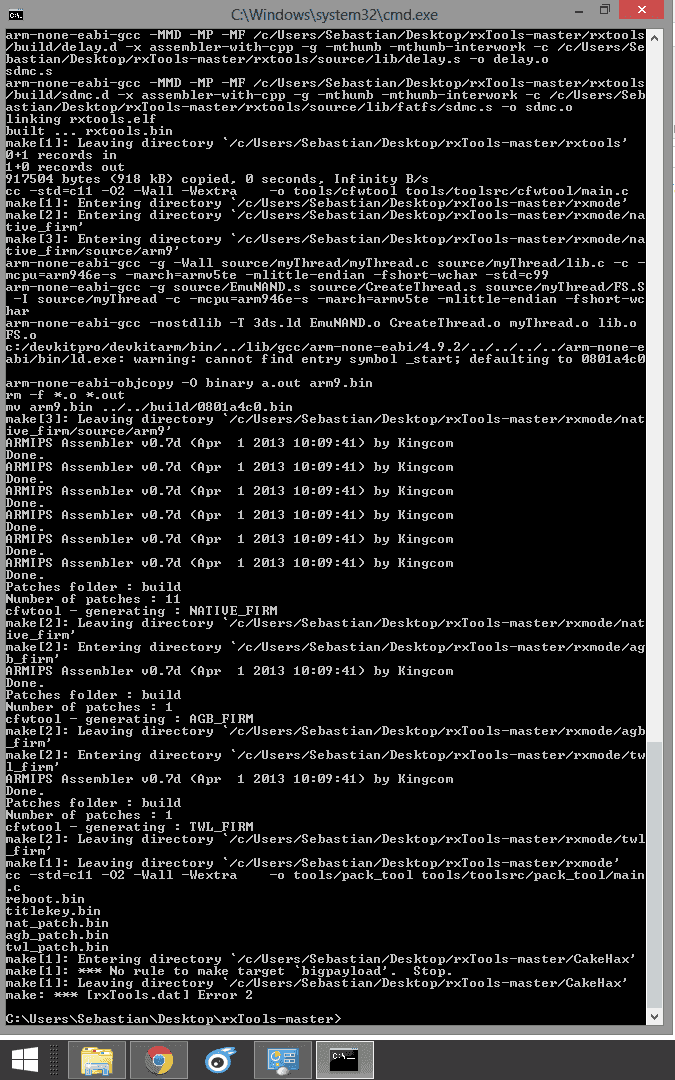

Are you getting any errors when compiling? Here's mine:
reboot.bin
titlekey.bin
nat_patch.bin
agb_patch.bin
twl_patch.bin
make[1]: Entering directory '/home/hle/src/rxTools/CakeHax'
arm-none-eabi-as -mcpu=mpcore -mlittle-endian  -o build/mset_4x/arm11_tools.o source/arm11_tools.s
make[1]: arm-none-eabi-as: Command not found
Makefile:164: recipe for target 'build/mset_4x/arm11_tools.o' failed
make[1]: *** [build/mset_4x/arm11_tools.o] Error 127
make[1]: Leaving directory '/home/hle/src/rxTools/CakeHax'
Makefile:36: recipe for target 'rxTools.dat' failed
make: *** [rxTools.dat] Error 2

You have to export the correct PATH. I've just updated this page: http://3dbrew.org/wiki/Setting_up_Development_Environment
or run this command to change $PATH temporarily: export PATH=$PATH:$DEVKITARM/bin

trying to build the latest commit. doing it from inside a vbox instance of windows 7. everything i need was installed, and i tried to run make on the latest master. i get:

not quite, unfortunately:
2.6 stable (via releases page on main git) source gives:
3.0b (via apache thunder's git link) gets a little bit further:
Everything is in my %PATH% according to that wiki link. is building this just unstable or something?
I was talking about this post.
You need to run
git clone --recursive https://github.com/roxas75/rxTools.git
to clone the repository and its submodules (which are "symlinks" to other repositories) into the rxTools folder, OR
git submodule init
git submodule update --init --recursive
to clone the submodules ONLY.
