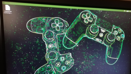

  6. kifir
    kifir Newbie
    Joined:
    May 22, 2020
    Messages:
    Country:
    Belarus
    Hi guys,
    I have installed Gentoo to my PS4 5.05 CUH2116B slim but I have issue with colors.
    Screen on PS4 720p HDR - off , Deep Color - off , RGB - Auto , HDCP - off
    The picture is more "green" as you can see in attached file.
    Do you have any idea what it can caused that problem ?
    thanks in advance
    Leeful likes this.
  7. Leeful
    Leeful GBAtemp Member
    Developer
    Joined:
    Sep 4, 2015
    Messages:
    1,168
    Country:
    I have had this same problem in the past. Try setting RGB to Full. I think that fixed it for me.
    Keep HDR and deep colour off, also try 1080p (if your display allows it).
    kifir likes this.
  8. kifir
    kifir Newbie
    Joined:
    May 22, 2020
    Messages:
    Country:
    Belarus
    thank you for your inputs.
    I have tried with RGB - full and 720p - the result is the same :(
    I dont have 1080p mode due to display ( its only readyHD )
    I have 1080i mode but the result is the same.
    It seems, that the issue with in my display :(
    I alos tried x2go and VNC to make remote connection but the speed is very slow and with lags :(
    Leeful likes this.
  9. Leeful
    Developer
    Joined:
    Sep 4, 2015
    Messages:
    1,168
    Country:
    @kifir What does it say under 'Colour Format' when you go to 'Video Output Information' on the PS4?
    Is there an option on your TV to check what picture information is being displayed when you are running linux?
    On my TV if I had the RGB set to auto on the PS4 it would display YCbCr (or cmyk) on my TV when in linux.
    Setting RGB to full fixed it for me but as you said you have already tried that.:(
    kifir and KiiWii like this.
  10. kifir
    kifir Newbie
    Joined:
    May 22, 2020
    Messages:
    Country:
    Belarus
    Resolution 1280 x 720 60
    Colour Format - RGB
    HDR - no support
    Unfortunately, no info on TV, TV is quite old :)
    So, fixed it by nomachine remote control :D. The best performace between x2go, vnc and RDP.
    Leeful likes this.
