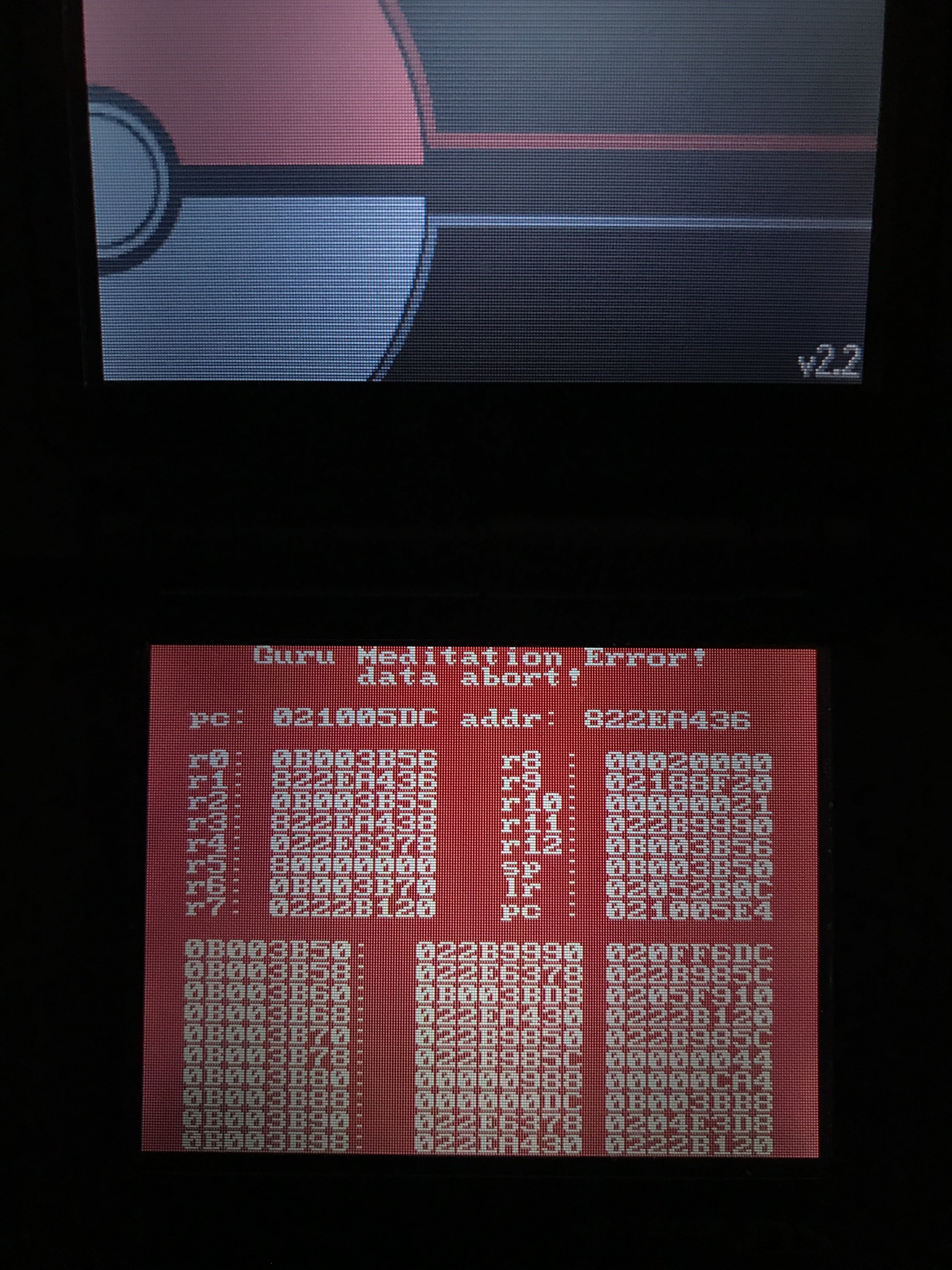

Had this error while it was "dumping save" from my official FireRed cartridge, and my repro Sapphire cartridge. I'm using TwiLightmenu++ on an R4i 3DS +RTS WiFi, on a Phat DS.
Edit: Backed up both saves using GBA_Backup_Tool. The FireRed save works, but the Sapphire save crashes in the same way.
Hmm, that's weird that the FireRed would do that... The Sapphire is probably because some (most/all?) reproductions use SRAM saving instead of the normal flash saves, which aren't able to be read correctly, so if that's the case its unlikely any tool will work with it unfortunately...
If you can try dumping the FireRed in the attached build and send me the "pc" and "lr" numbers if it crashes then I might be able to figure out what's causing it, at least if its able to get a helpful thing from that, usually its not super helpful... Someone else had v2.2 crashing, but I can never manage to get the crashes myself since so I'm not really sure how to fix it :unsure:
Aww, damn. I do have a link cable from when I was a kid, but I only have one GBA, and I don't know anyone else who has one anymore.. I guess I'll just have to find a GBA somewhere to trade them..
Huh. It worked that time. How strange. Sapphire still doesn't work, but that makes sense with the reasons you gave.

Weird, I tried with my carts and all my legit ones worked while my repros gave the exact same error you sent above, so maybe it was just bad contact or something before...
And yeah two GBAs is likely your best bet... Its unlikely that any tools will even be able to dump a usable save file from the repro as I did mess around a bit with that on mine before and they still identify as using a "FLASH1M_" save, but are actually something else which causes dumping tools to just dump garbage... I was able to trade using my repros back when I used them though iirc.
