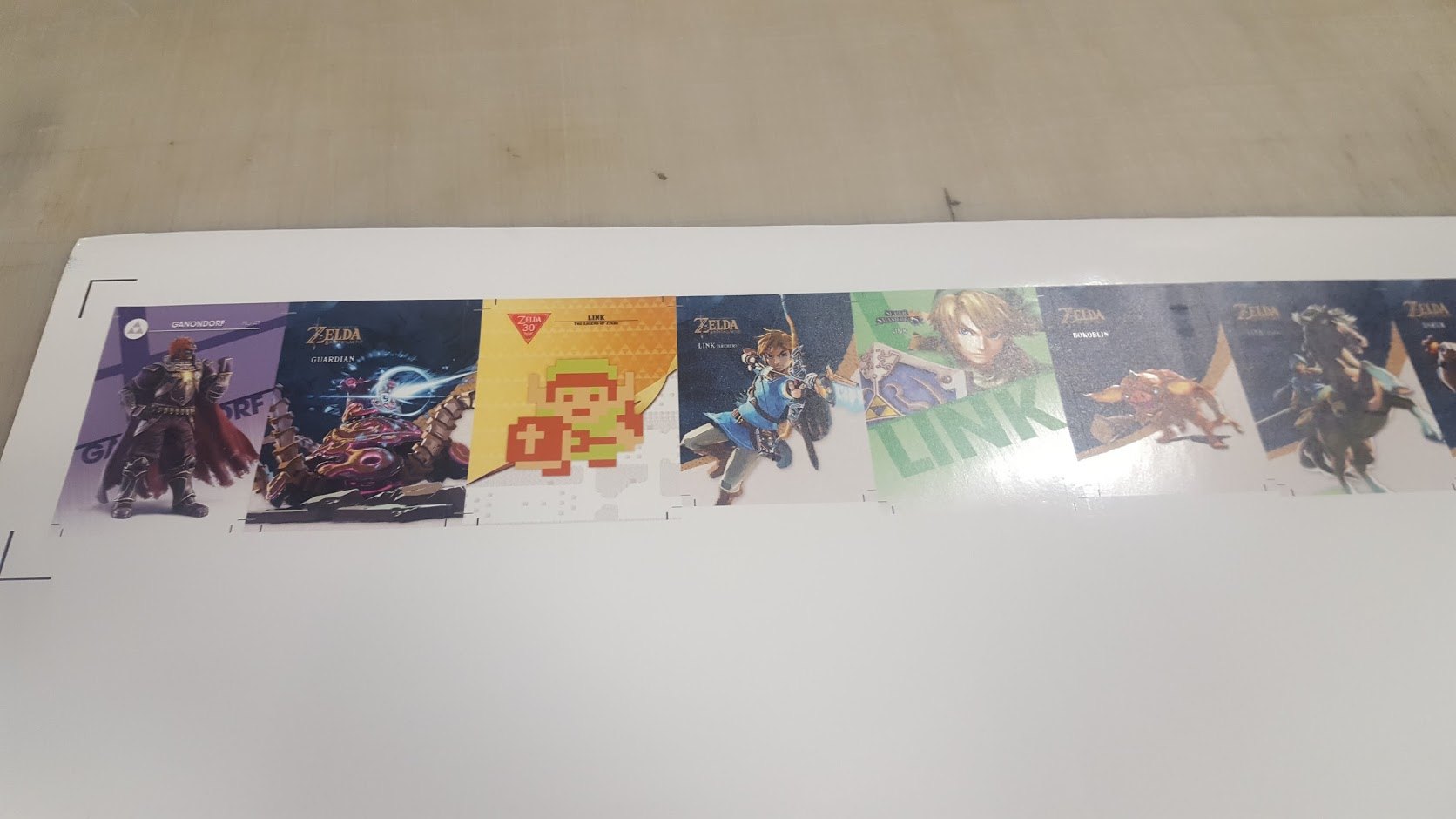

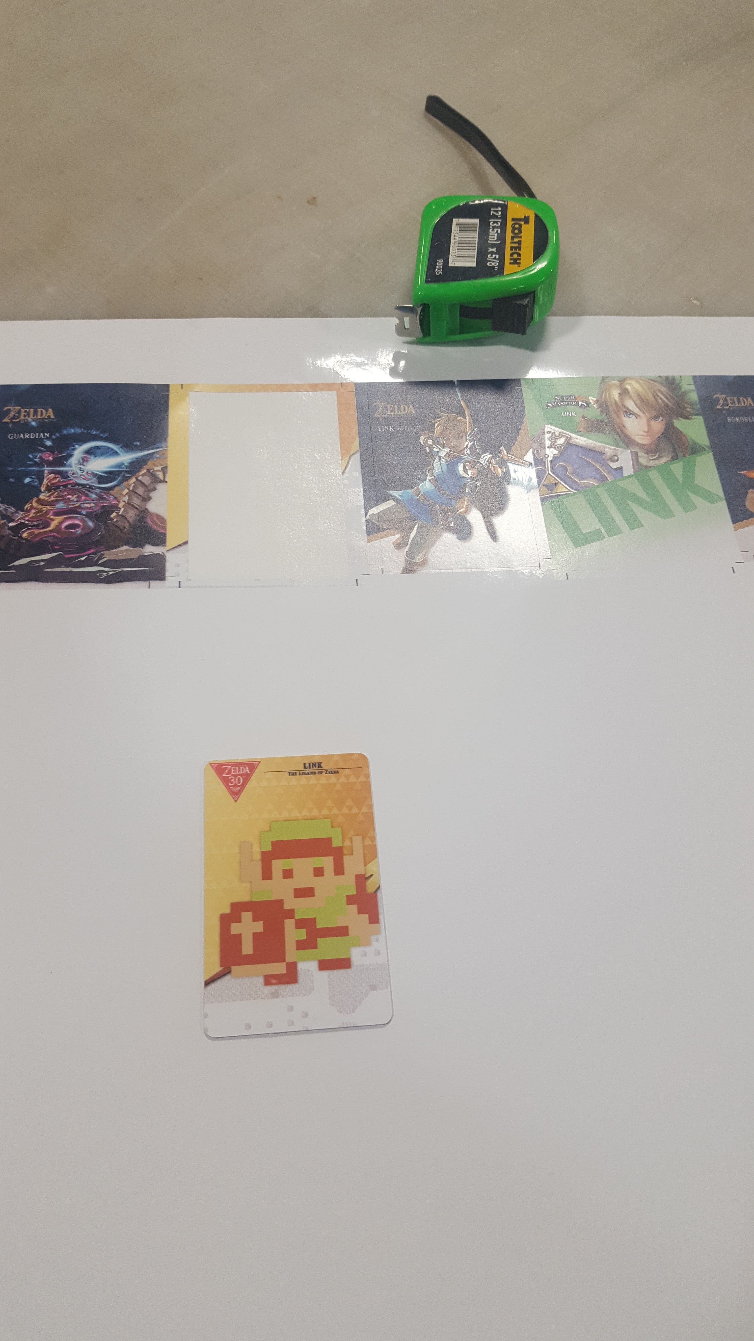

Did you ever buy a printer for the cards? I work in a print shop, have access to a Solvent, UV, And Latex printer. I've tried Solvent and UV so far... The Solvent looks the best, the UV isn't as "Glossy", but that might be the look you're going for. I printed on reflective Material to give it more of a glossy/shiny look for the solvent.
I'm going to bring a card and try to print directly to it with UV, see how scratch resistant it is. We print directly to PVC all the time.. but being handled/scanned a lot, I'm not sure how good itll be.. but I'll do a test!
I printed 2 of each.. one for me, and one for a buddy. I'm going to try UV printing directly tomorrow. If it works, I need to make a Jig that'll allow me to put 10+ cards in at once to print on. The printer I use is a 74" x 10 FT printer... so printing cards 1 by 1 would be a bit of a pain! I can at least test and see how good it works though.
I live in Canada also... If you'd like, I can mail you a set of printed vinyl / laminated. It's not as good as direct, but it's really nice, thin vinyl that's meant for car wrapping... so it works and looks great. Much better than paper stickers printed on Inkjet at least. Least I can do for you since you supplied all these artworks for free! It's made my collection look much nicer.
Wow, cant post images. I guess I havent posted much so it's seen as spam! On /Imgur.co m/a/ekWVM
20171212_081159.jpg - UV Printed and unlaminated
20171212_081351.jpg - UV printed and Applied
20171215_134921.jpg - Eco-solv on Reflective vinyl
20171218_181541.jpgApplied with laminate on (I used the wrong sized images, so I just threw them on even though they cut a lot off... I'm going to re-print and cut them out after X-mas!)
Found a way to post images with 0 post history!
View attachment 108750 - UV Printed and unlaminated
View attachment 108751 - UV printed and Applied
View attachment 108752 - Eco-solv on Reflective vinyl
View attachment 108753Applied with laminate on (I used the wrong sized images, so I just threw them on even though they cut a lot off... I'm going to re-print and cut them out after X-mas!)

Yup.. I didnt notice the credit card ones until this post. I'm Re-doing them all now, sadly.
I just tested with our UV printed... it worked great. It's a little blurry since I set the print height too high, The card was so small it couldn't read the media width... so I just told it it was cardstock. Makes it a bit blurry / bumpy. But scratch wise, nothing scratches off and it looks / feels good!
I'll play with it more today to see if I can improve the quality. I'm "Fairly" sure it's because of the head height, It is a $250,000 machine, so the quality is generally good... I've never printed on credit card material though, so it might be a substrate issue!
I'll message you later tonight. I can print however many you want on vinyl with Laminate, I'll even send you a sample flatbed direct print, incase you want to send me all your cards and have me print directly on them.

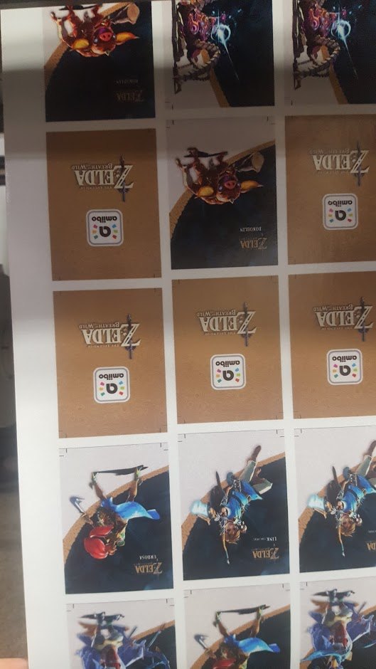

Stopped by the store and grabbed some A4 photo paper, side note; you can fit 9 on one page if you're outside the US and use the A4 paper format.
If i had to do it again I'd borrow a better printer and let someone craftier than me do the glueing, all in all. thanks alot for your work Random11.
