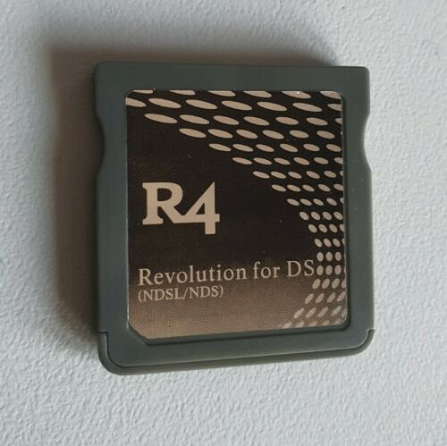

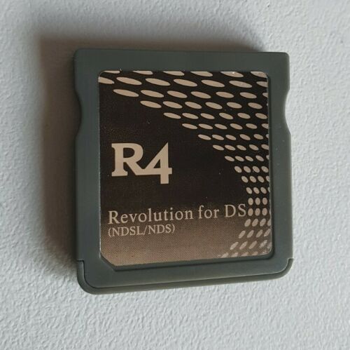

    I been a long time so i just want to say this program works. My R4DS had some bad contact with my 3DS card slot, nowdays it's a little better but i still need to work on it. The program works, i just have to insert my R4 Revolution and boot using the R4DS Launcher. Everything is there, all the games and saves files. I'm using Wood R4 kernel, everything works. Thanks.
