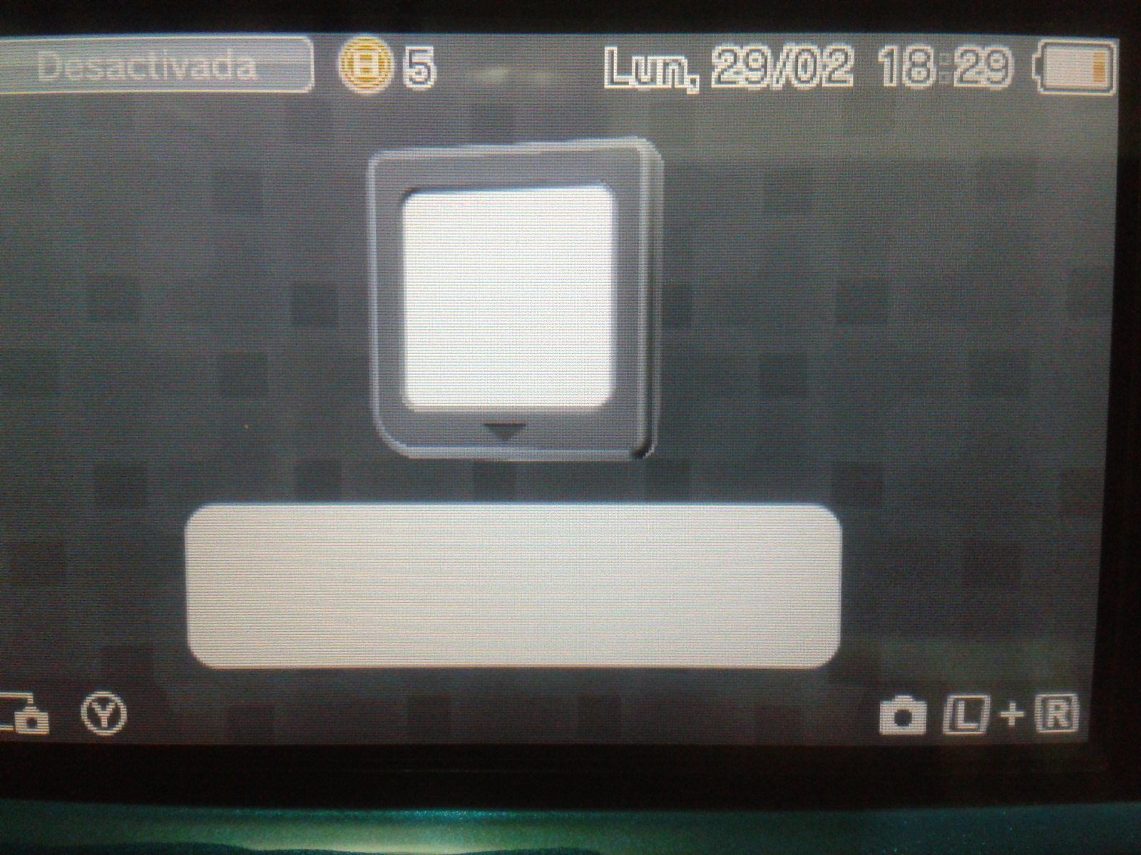

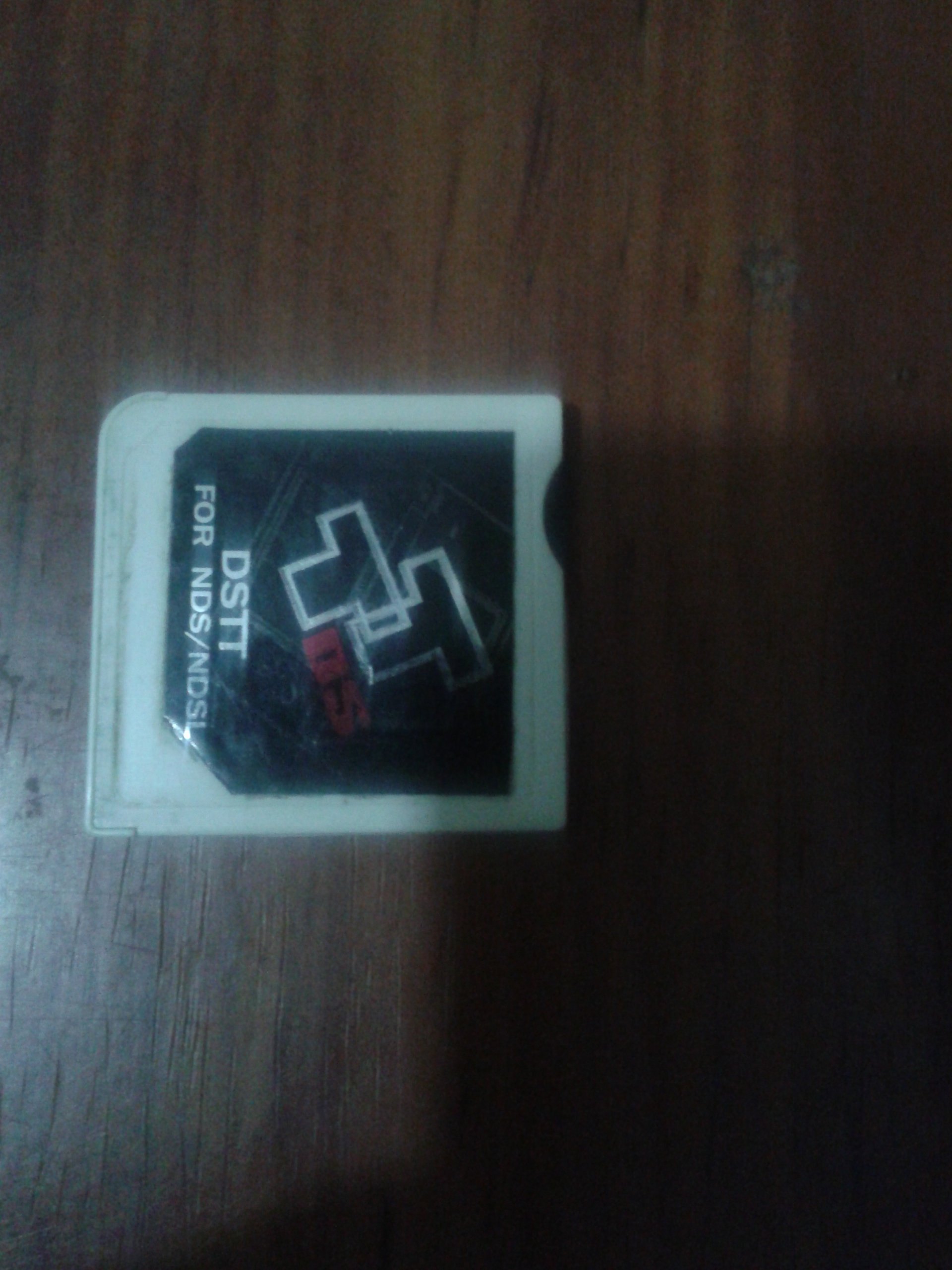

mm i need patch twl firm on sysnand and the emunand or only emunand??? 2016-02-29 18.27.06.jpg 2016-02-27 19.15.59.jpg
