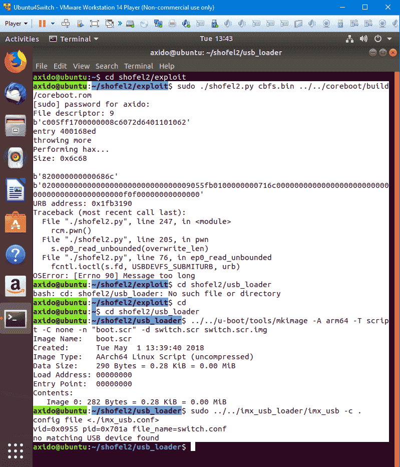

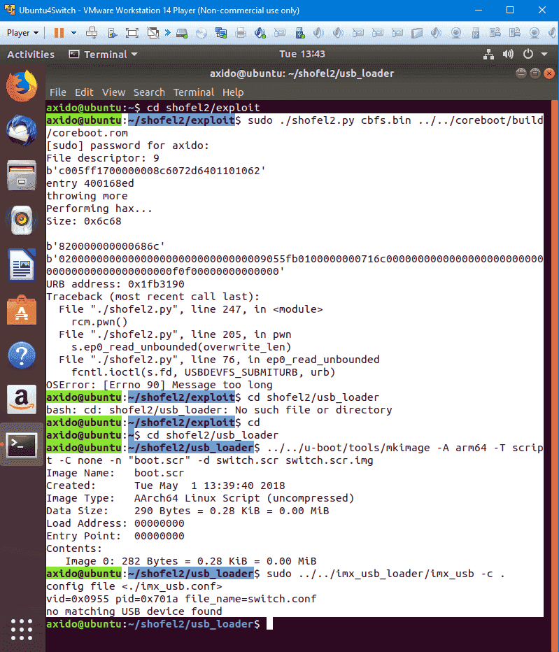

    Could someone please help me with this?
    LinProb.
    As you see it's something someone already asked about a few pages ago. Sadly, the best answer to that was something along the lines of "find out the pid and insert it manually". I found out mine, but I got confused when I took a look at imx_usb.conf. The file does not contain the pid itself, but mostly references other files, some of which don't even exist inside of the usb_loader folder.
    This is the last step before Linux finally boots on the Switch and it would be a shame if this is as far as it gets. So, does anyone have a proper description of the process of changing the pid?

    That happens to me too. Simply remove the USB and put it back before launch the imx_usb
