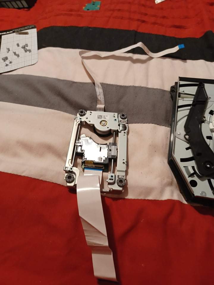

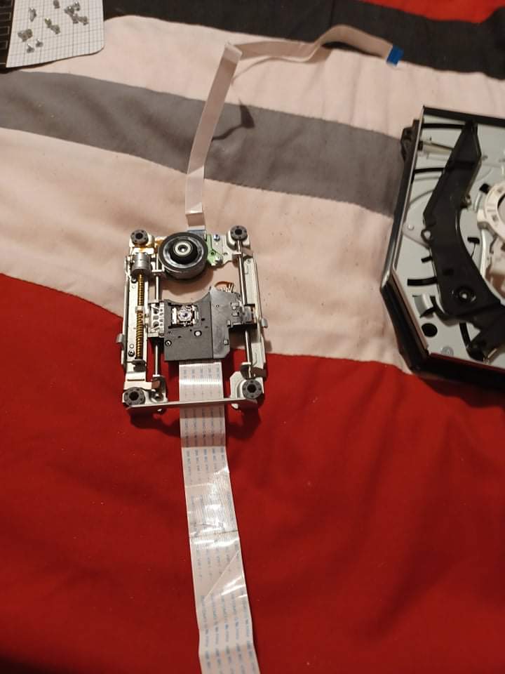

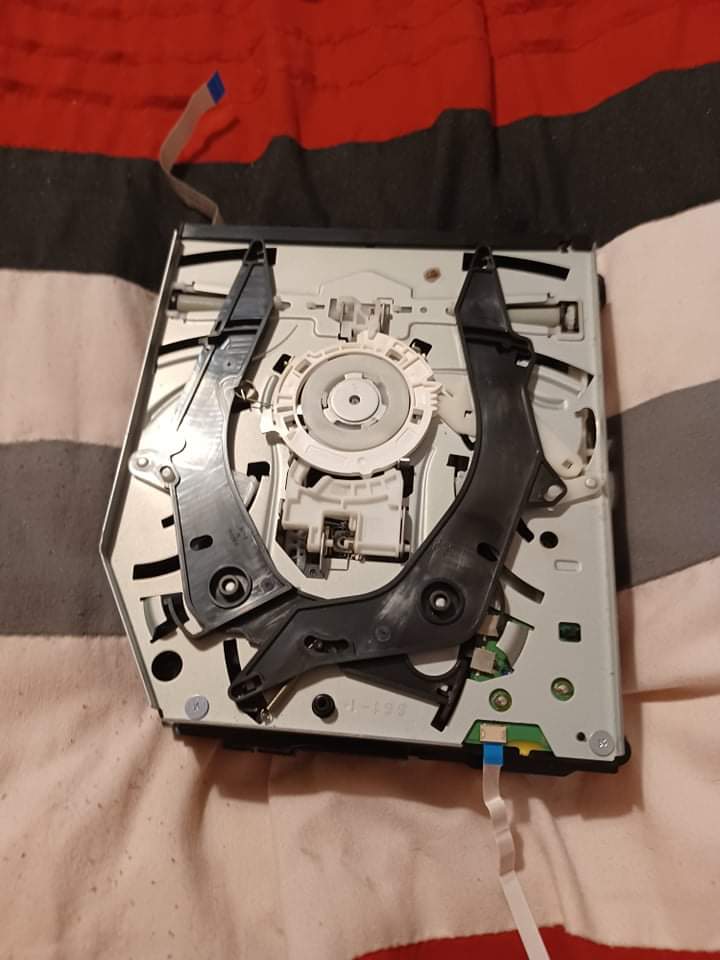

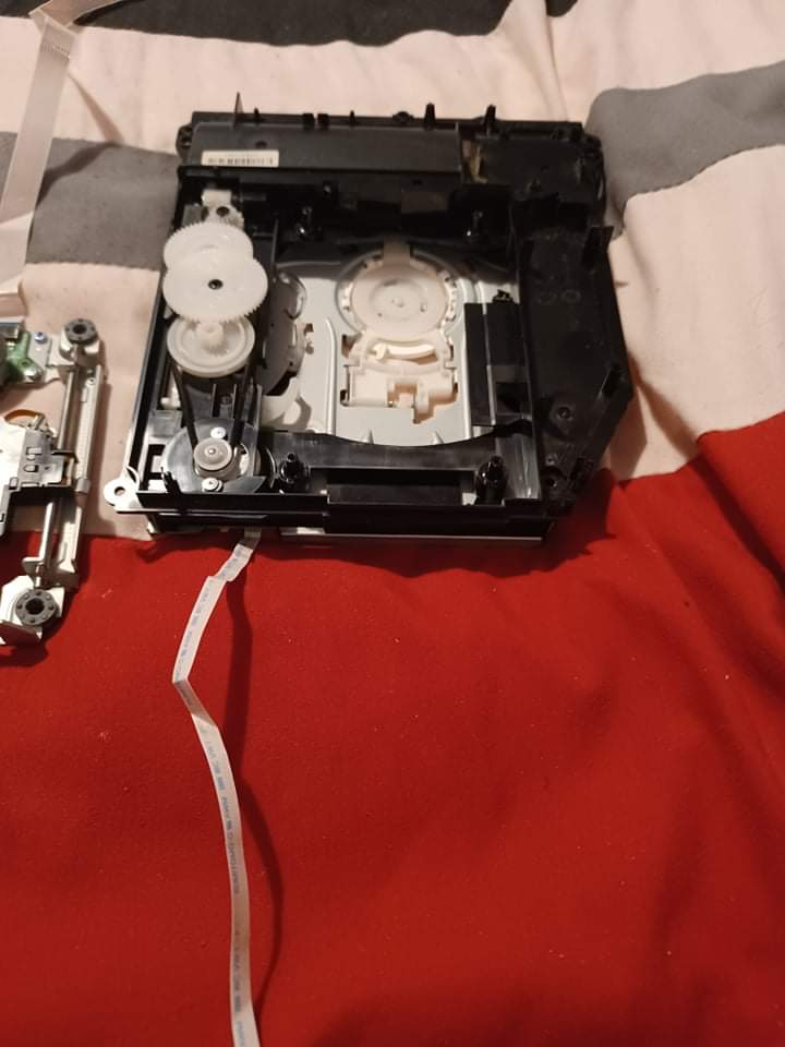

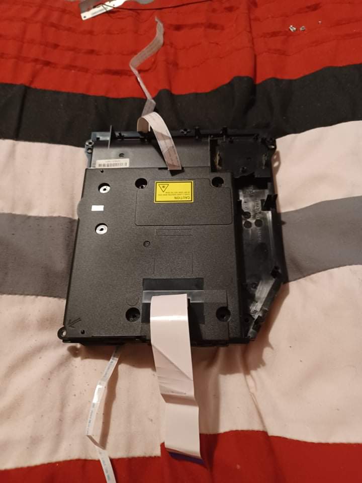

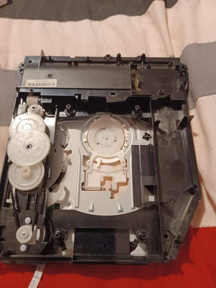

These are the images he sent me.

Spider_Man
May 28, 2015
3,488
35
4,094
Yes, 5.05 Full is very easily googlable, Wololo even has a guide on how to perform the procedure.
I think ive had to recover fw before by safe mode, so will give it a try.
Will it wipe my browser bookmarks that i have for the exploits.
Or does it just redo the fw.
Thanks for the advice anyway, does the attached drive images look right as ive never seen what the inside of a ps4 looks like.

The only models that require a daughterboard swap are the early CUH-100x consoles, later models had the daughterboard hardware incorporated, that’s why I asked which model you own. It’s hard to tell whether one belongs there or not because they haven’t changed the mold for the plastic shell, so you have a spot where the daughterboard would have been, but there’s no board in sight. You will notice that the CUH-1200A disc drive does not feature a daughterboard:
https://www.ifixit.com/Guide/PlayStation+4+CUH-1200+Entire+Console+Disassembly/52475
Whereas the CUH-1001A does:
https://www.ifixit.com/Teardown/PlayStation+4+Teardown/19493
Just on first glance yours doesn’t feature one, so you should be good. It’s missing the sticker that’s supposed to hold all the ribbons in place, but that could’ve been removed. Judging by the ribbon length this is the new drive, but those can be swapped too. The model number of the system will give you a definitive answer, or better yet, a glance at the motherboard. You don’t even need to remove the heat shields, the connectors should be plainly visible under the power supply.
