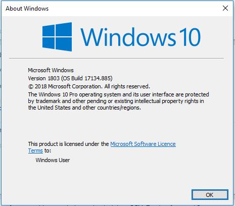

  7. Deobulakenyo
    Deobulakenyo GBAtemp Fan
    Joined:
    Oct 8, 2018
    Messages:
    348
    Country:
    Philippines
    sorry for the late response. i attached the image of my windows version. It is version 1803 (Build 17134.885)

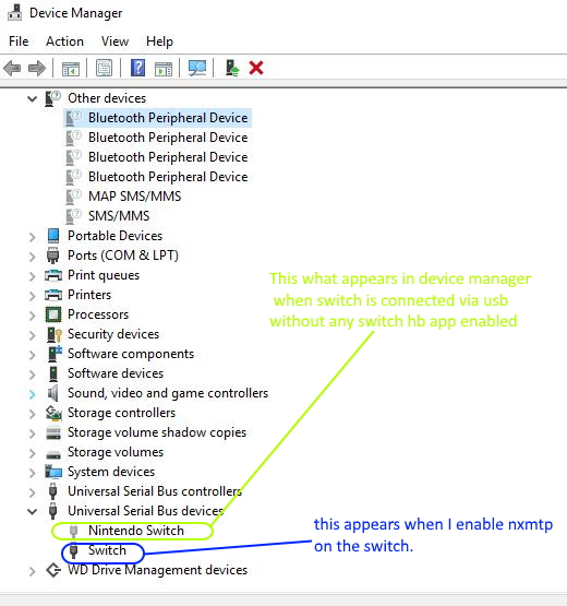

    my switch is on sxos beta 2.8 emunand
    tegra RCM works in pushing payload, even the mounting of the switch via UMTS tool in the tegra RCM app. I can use fluffy on PC to install games on switch via tinfoil over USB.
    i also uploade an image with explanation of what happens when the switch is connected via USB without any homebrew enabled and when i enable nxmtp.
    I was hoping to see switch under Other Devices so i can install MTP drivers for it but the switch only appears under Universal Serial Bus devices.
    Hope more technically oriented people here can help me.
    Thank you very much. Salamat
    Edit:
    *To add, if this is important, I am able to use my android phone connected as MTP to this same laptop I use.
    * I looked at the driver of the switch and it is not wpdmtp.inf but instead it is oem58.inf. i think this is key to the problem at hand.
    *final edit: I managed to solved the problem. I needed to delete the oem58.inf driver and the pc recognized the switch as MTP device

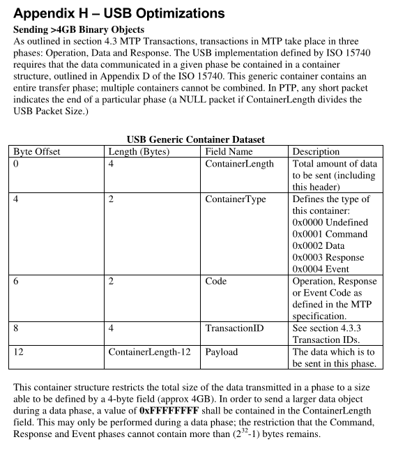

    You're better off using bllawar's tinfoil with nut server for big transfers. The nutfs protocol allows transfers via usb of any file.
    You need to specifically add the nutfs protocol on the tinfoil side and you'll be able to see your pc folder on the switch.
    Is not exactly like that. Many misinformation is shared trough the internet about the mtp protocol. Is not an issue on the homebrew, the mtp protocol supports transfers bigger than 4GB but it must be handled pc side and is hard to handle, windows explorer for example doesn't handle it properly and sincerely i don't know any transfer utility that does. Maybe calibre, but i'm not sure.
    Bassicaly i attached the protocol documentation about how to handle transfers bigger than 4GB, which to be fair is pretty wonky to do.
    I read on a blog before how some dude implemented it using the 0xFFFFFFFF value in the containerlength field, as described on the protocol, and then he cut the transfer using the usb driver itself when all the file was transfered.
    Well, when i say pc side i mean on the senders side.
    lemonmaster and hippy dave like this.
