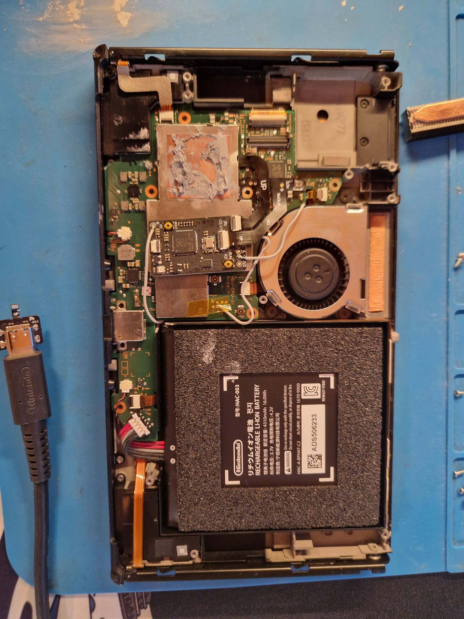

I have a Nintendo Switch OLED modified with a rp2040 hwfly V4 that doesnt boot into Hekate anymore. (just boot directly into OFW)
The actions that brought to this point were these:
I removed the wallpaper with nx wallpaper then i rebooted into Emummc with UltraHand Overlay (installed from hb appstore)
this rebooted to Stock (OFW) and now everytime i try to restart the switch it just boot into OFW.
I already tryied to:
-replace all atmosphere and hekate related file
-reheathing D0 adapter (i also tested all points with a tester)
-reflashing the rp2040
i dont know what else to do, hope someone can help
ps: the led first go blue then green (in video is not really clear)

i checked all pins in diode mode, nand d0 is anchored to the resistors so its not possible it move, clk and grounds are good and others pin are easy
the chip disconnected from everything try to glitch with blue light and green (as in video and always the same blink)
its not even possible to access chip firmware and i dont know why
I'm sorry to disappoint you but from experience there is no need for the adapter to move to fake the contact. Imagine the D0 sphere as a lung when it heats up it expands, when it cools it shrinks, even by fractions of millimeters. If you are lucky, keep in touch if you are not it can give problems of all kinds. for the cmd if the link is not substantial you have the same problem. If you weld a hair wire you have verified contact with the tester but you have signal problems.
If you want reliability over time, the only way is the kamikaze.
And I reiterate all and I mean all the consoles I have worked have always worked with Flex V1 or V2 indifferently from the console with RP2040-Zero without tricks like I2C downclocking
