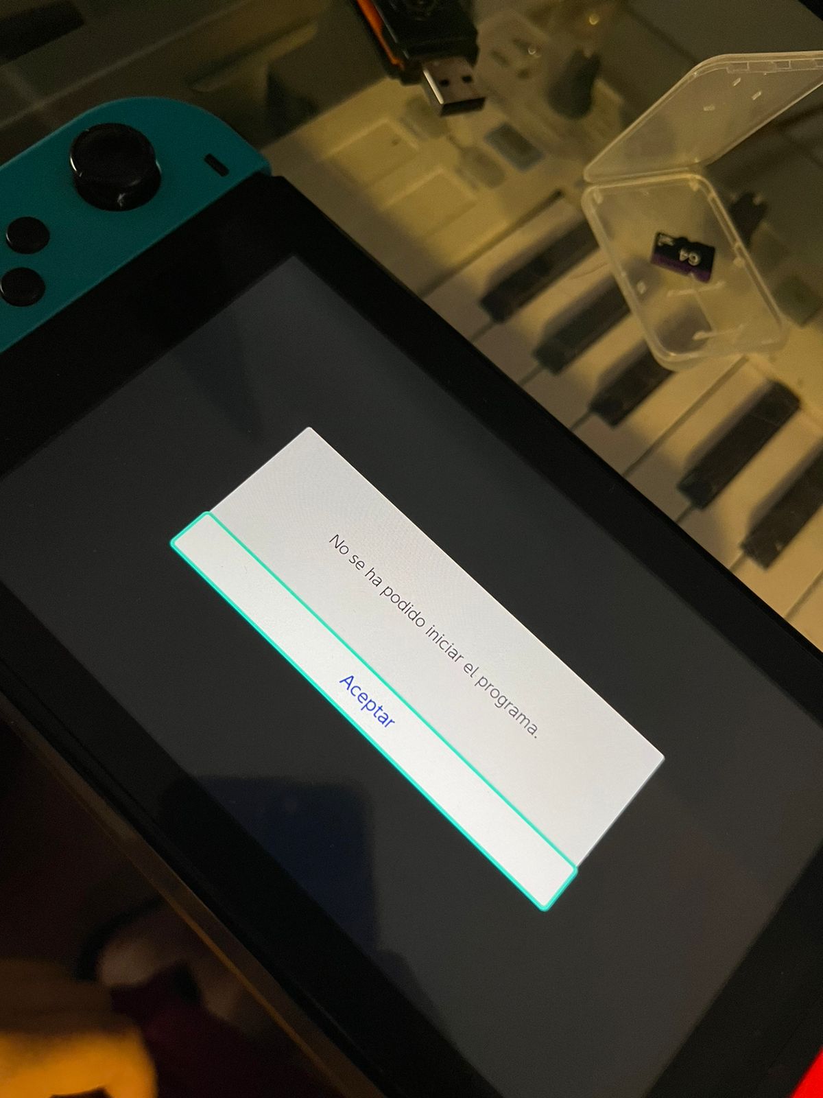

I recieved a nintendo swtich from a friend who has ReinX on a 8.0.0 Switch.
I've tried to switch to atmosphere but I've recieved an
"abort () error 0xfffe".
It seems that the console just starts custom firmware with ReinX but not OFW.
Then, tried to factory reset with Haku33 and then OFW won't boot either.
Tried to launch atmosphere but the error displayed after the Switch logo is: "could not start the software", the same error that appears when you don't have the sigpatches.
Image of the error:
Tried to update via switch recovery mode to 13.0 online (Switch not banned) but the same error screen appears, it seems that the OFW boot is corrupted because I'm stuck in in a bootloop with the "Could not start the software" error after the NSW logo.
Restored the backup I had but now I'm stuck at 8.0 witht ReinX the only CFW working properly

Try rebuilding the eMMC with ChoiDujour.

Hello @Cristobalmess
is your Switch a Quest/Kiosk hardware ?
ReiNX was famous with this kind of hardware, because it was working natively (ReiNX does not check the hardware)
A Kiosk/Quest Switch can't run AMS natively, not until SciresM shows some love for this hardware (it just needs two little changes to add the correct ID for this kind of hardware)
itneeds a patch in a kip form (ams_mitm.kip) or with a forked AMS already patched
I can give you my kip (compiled by myself, I'm using it on my own Kiosk/Quest Switch), or you can give this a try
