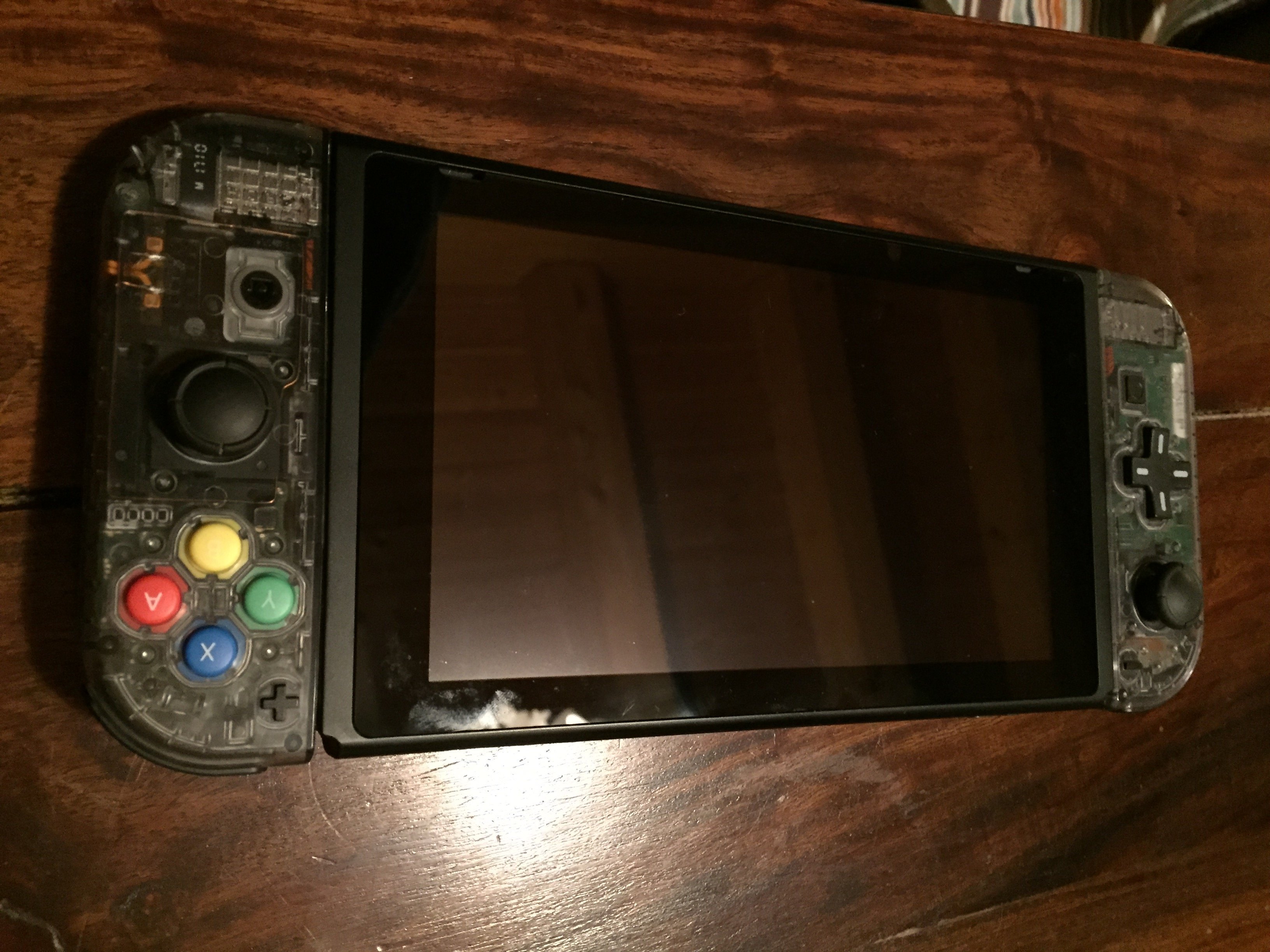

It was a lot more fun to replace the original shells as expected. now I understand much better why N asks for such a crazy price. but hey, I am very happy with the result. I love my new digi controller. But as said by many before, it is no easy job for starters.

I have the blue transparent shells for my switch and joycons they look great. It's just a shame that the moulding is a bit off so I had to shave some on the housing down with a knife to have the joycons lock and also had to shave another piece of the housing to have the right joycon not bulge.
EDIT: For anyone that gets the shells and is wondering what parts to trim:
For the joycons to lock you might need to shave down the part of the shell that the lock button clips in to: https://imgur.com/a/EL5WD7P (https://www.reddit.com/r/NintendoSwitch/comments/8eaq28/metal_latch_not_working_with_basstop_joycon/)
For the right joycon to be flush: https://imgur.com/a/3dYcM (https://nintendoradar.com/forums/to...replacement-right-joy-con-shell-white-colour/)

the moulding here is superb. maybe your blue shells are made in another fab, or they learned their stuff.

What brand is yours? I have the Myriann brand one. My shells aren't the DPAD ones so maybe I have old stock too and the moulding is better with the DPAD ones.

Gotta have that d-pad :) Mine are Myriann too, and the moulding was perfect. My left (green) was obviously from a d-pad set but my right (purple) I swapped with someone else from a non-d-pad set and it has no problems, so maybe there's just different batches around depending on how well each colour has been selling.

I feel the need to enlight you with my experience, after a few months of usage. All functionality and the the mechanics are still fine, thumps up. But there is one little issue I also like to mention. The letter of the yellow button has totaly weared off. Thats just a cosmetic point, I guess can pretty good handle it, but still...there might be others with a different opinion. I had about 3-5h per week playing time.

Yeah most of the markings wore off my d-pad before too long. I kept the original Nintendo buttons in the right joy-con rather than the supplied coloured ones, because I'd heard the coloured ones might wear quicker, also I think it would have been too many colours for my setup.

I will stick to the colored, even if they lose all letters. Though, I hope to find the right buttons:) My D-pad still look perfect...but I didnt used it much...
