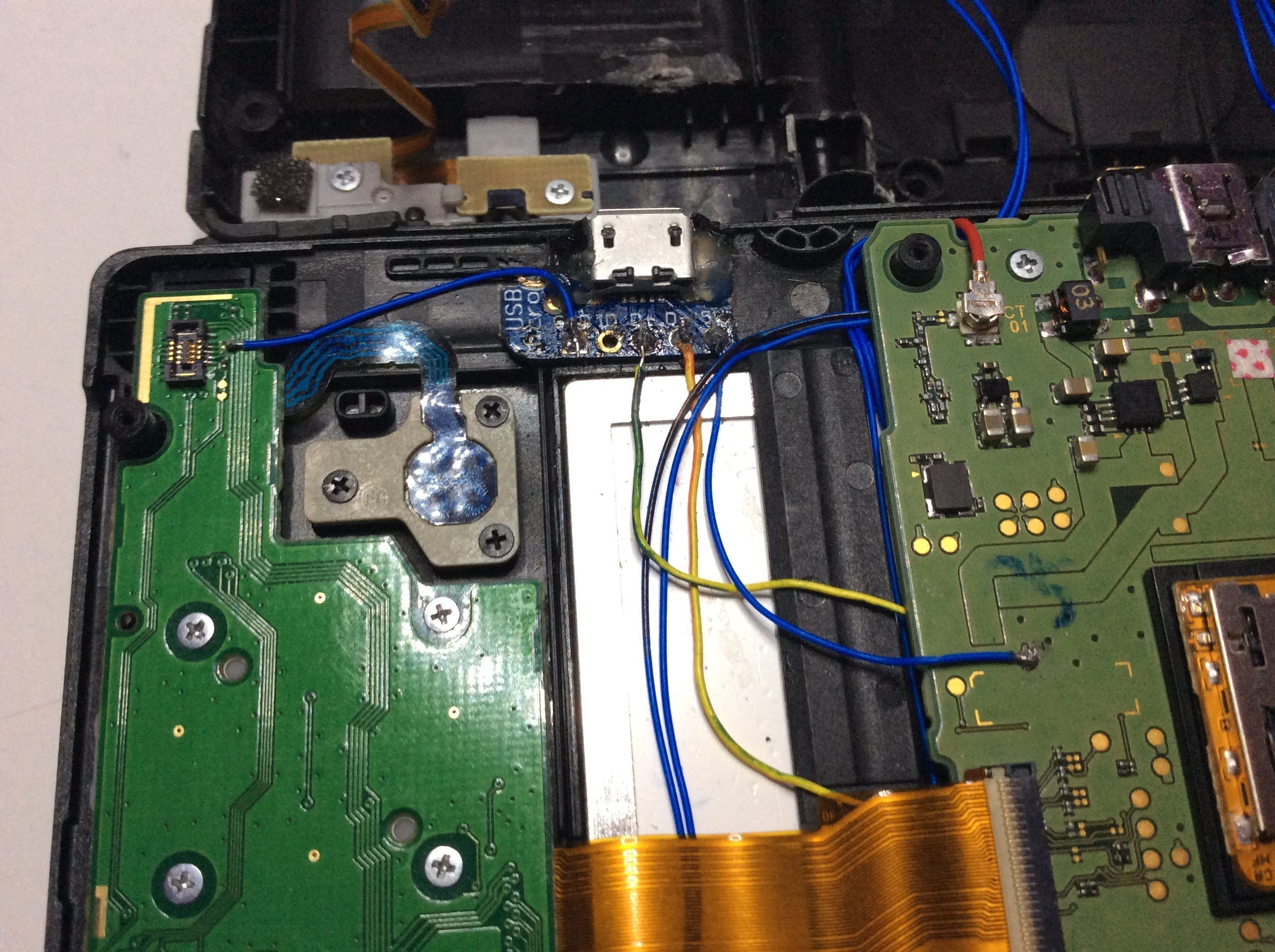

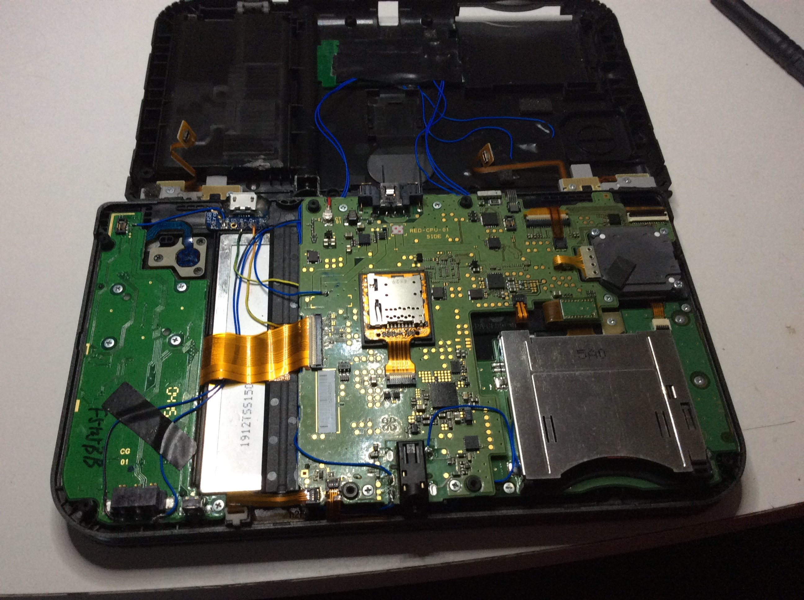

Hey Miler,
i received your adafruit, so your package has bin delivered, i've upgraded my n3ds xl hard mod and now i have this:
but i have two readers now and both won't work, i still wait for my anchor, if that won't work i'll ordere that 3.0 from your site, but atm i have a nice usb hard mod but it does not work very well haha
Dennis G
Jan 4, 2016
673
31
433
Netherlands
This looks better. :)
Just to wait for the Anker's reader and it will be good, I hope for you.
i have shortend my gnd to the same location you use (the triangle) so i have the shortest setup in wires possible, no change in functionality :c
i keep getting,
errcode 00F800EF
FFFFFFFF FFFFFFFF
00000022 00000000
Here can you see the shortend GND
The other wire's you see are not for the hard mod but for a bluetooth transmitter that i build in to the n3ds so stream audio by bluetooth, so ignore those :P
the two yellow wire's are Dat0 and Cmd and the short blue going to right is clk and gnd goes ofc to the left side to the power board to the triangle but i bet you can figure that all out =)
i keep getting,
errcode 00F800EF
FFFFFFFF FFFFFFFF
00000022 00000000
View attachment 47963View attachment 47962
