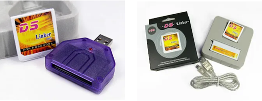

Some older flash carts used nand for storage and do not have any form of removable storage. N-Cards are a notable example. The M3 G6 and Acekard R.P.G are other carts that have nand storage. Though Acekard RPG is unique in that it has both nand and a MicroSD slot.
Most post R4 era cards moved away from this and are almost all MicroSD these days.

Aren't all flashcarts using micro sd for storage ? Or is this like a built in bootleg ? First time hearing about these
There were bootlegs that did use NAND flash, primarily DS Linker/N-Card flashcarts for example.
