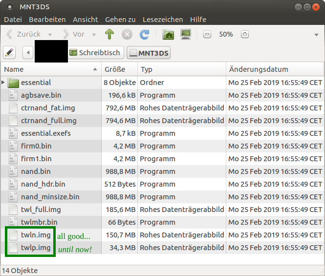

    @CodyWGamer Now... I'm playing around with your problem at the moment and was able to (partially) reproduce this. Not fully, because I'm a coward. This is best explained with some screenshots. The nice program fuse-3ds is able to mount NAND-backups on a computer. The setup procedure took a while, but eventually I got it running on a virtual machine with Ubuntu Mate 16.04.
    This is how far I got:
    1. Setting up an EmuNAND with GodMode9 on a secondary SD and backing up that EmuNAND to a file.
    → pretty straighforward and standard so far

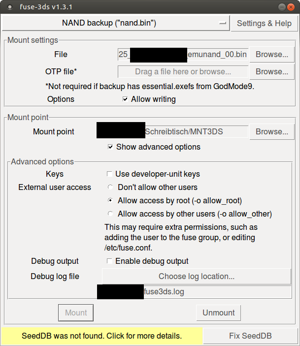

    2. Setting up fuse-3ds like explained on the Github page and mounting the backup of my EmuNAND.
    → not easy, but it worked:​
    01_mount. 02 Mounted.

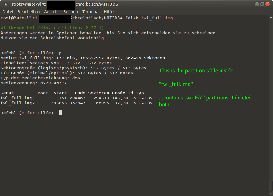

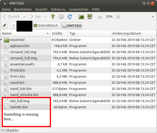

    3. Deleting the partitions inside twl_full.img with fdisk, unmounting and mounting again:
    → as expected TWLN and TWLP are gone:​
    03_fdisk_twl_full.img. 04_partition_table_in_twl_full_nuked.
    4. Restoring the damaged NAND-backup to EmuNAND:
    → TWLN and TWLP are gone on EmuNAND as well:​
    05 EmuNAND_missing_TWL_partitions.

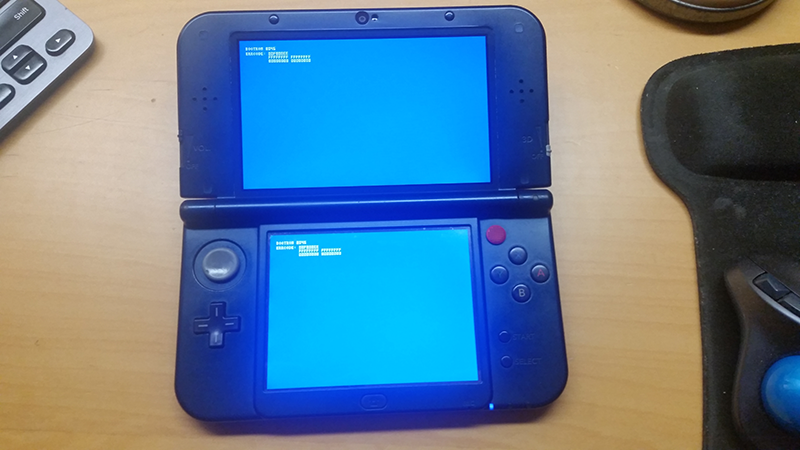

    • [S:] SYSNAND VIRTUAL is the most dangerous drive to mess around with. Period.
    The name VIRTUAL is a misnomer because even though you can't press (Y) (X) and delete any of the *.bin "files" found within it, you can very much badly edit or overwrite injecting them with garbage substitutes.
    While trying to retrace the steps you took, I decided to copy and paste a blank 66 bytes twlmbr.bin with all zeros, ignoring the big and bold red warning stating that changes can lead to a brick.
    twlmbr.bin - bootrom brick.
    For anyone not familiar with what this is, what you have here is the infamous bootrom 8046 blue screens of death brick. If this were to happen to you, you can't access Luma chainloader → GodMode9 from either the SD card and CTRNAND, fastboot3ds menu (if you have this over boot9strap), and Recovery Mode.
    Because this was software based and barring physical damage to the 3DS motherboard, this is something CTRTransfer wouldn't be able to fix. if you don't have a SysNAND *.bin image, you would need to use Lazarus3DS borrowing another like-type (old/new) 3DS decrypted NAND image.
    To recover from this, I had to use NTRboot with GodMode9 as boot.firm on the SD card in order to Restore SysNAND (safe).
