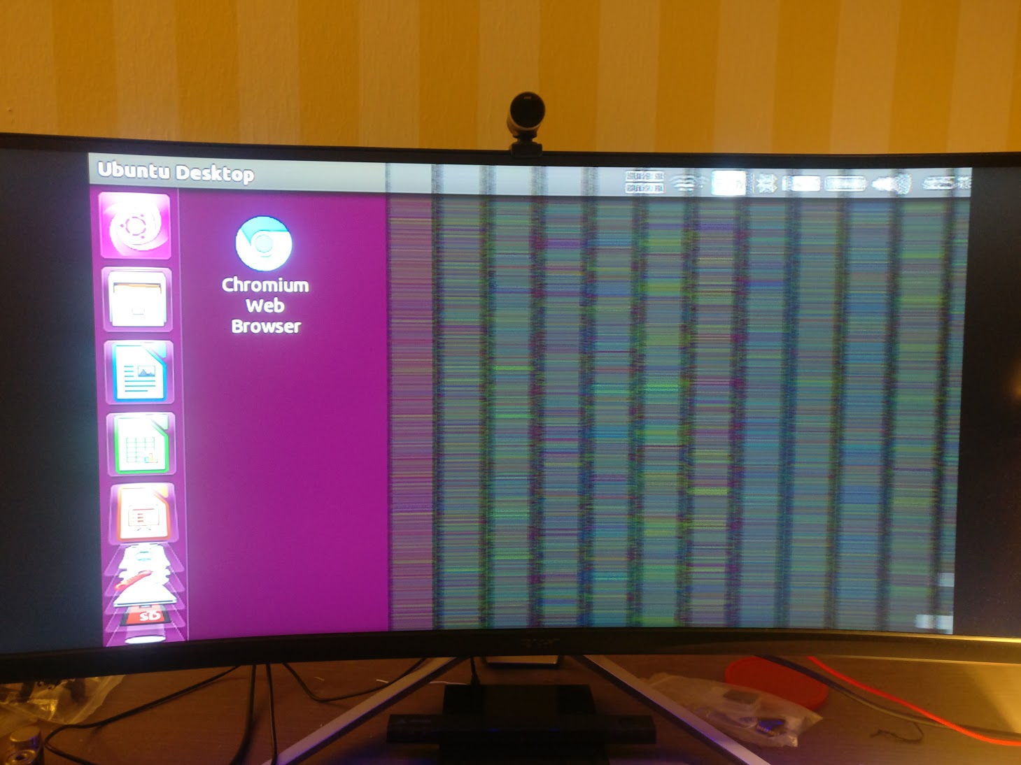

Okay I'm getting there, OTG doesn't seem to work in handheld mode, at least my crappy C to USB 3.1 Anker cable is not working.
In docked mode I got my iPazzPort controller working, but the right side of the screen is corrupted:
Anyone else noticed this or know how to fix?
Thanks.

Try using a different monitor.
