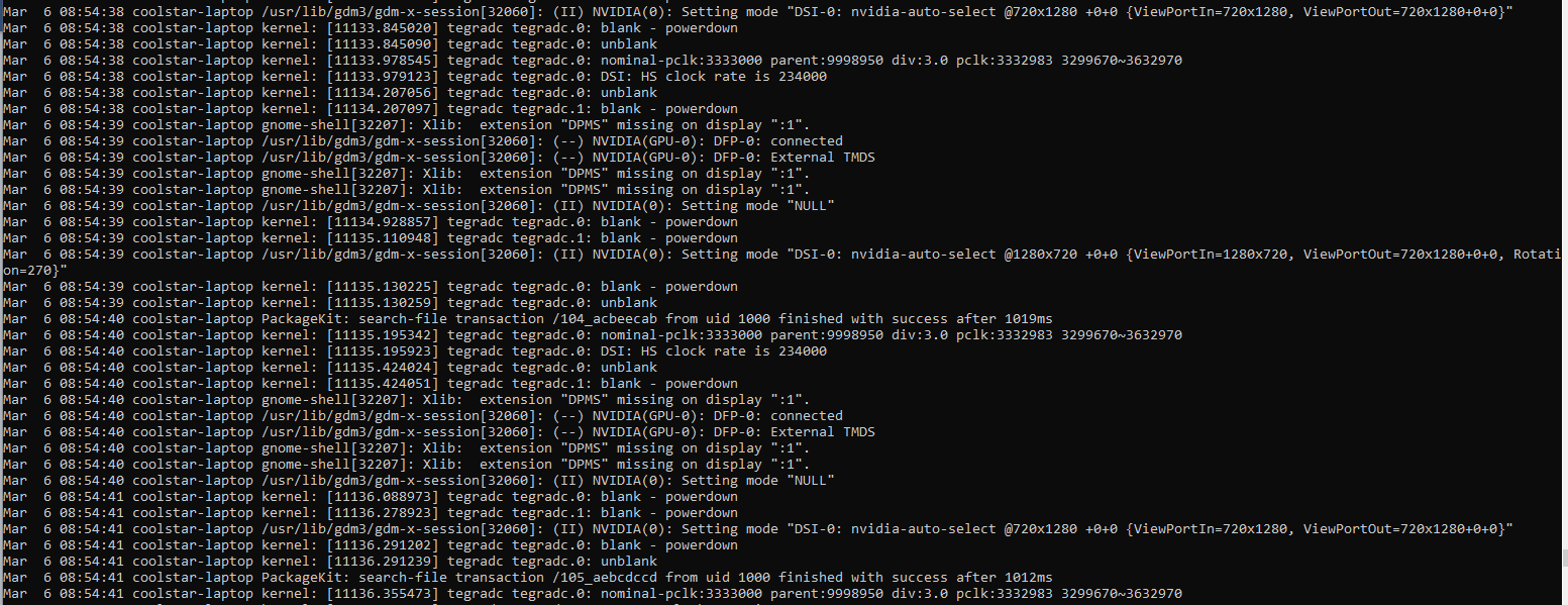

So I tried to upgrade this image from 18.04 to 19.10 and noticed that while it was quite usable docked on 19.10, undocked the display kept flipping every 3 seconds because the NVIDIA driver/Xorg kept setting a NULL mode and then mode switching at different rotations
I know the upgrade to 19.10 isn't really supported.... however I noticed when I re-did the SD card with a fresh 18.04 image, the same glitch happens on the login screen on the stock 18.04 image if auto-login is disabled. There seems to be something that fixes it after the user logs in, but clearly that doesn't seem to stay around if the system is upgraded to 19.10 (and it the bug still is present on 18.04's login screen)
This is the syslog output (it's identical between 19.10 before/after login, or on 18.04's login screen)

It looks like the main issue has to do with Gnome being broken. Switching from Unity to Gnome on Ubuntu 18.04 shows the same broken behavior that I saw on 19.10 (with the internal display constantly blanking/rotating in handheld)
Login screen issues seem to be for the same reason as well. Switching from gdm3 to lightdm (still on Ubuntu 18.04) fixed the glitchyness on the login screen as well.
Going to test this on 18.04 for a bit before I dare upgrading to 19.10 again

It’s (probably) the automatic rotation stuff, it’s super sensitive, you can get it to happen on 18.04 in the “Ubuntu”/Gnome desktop environment as well.
