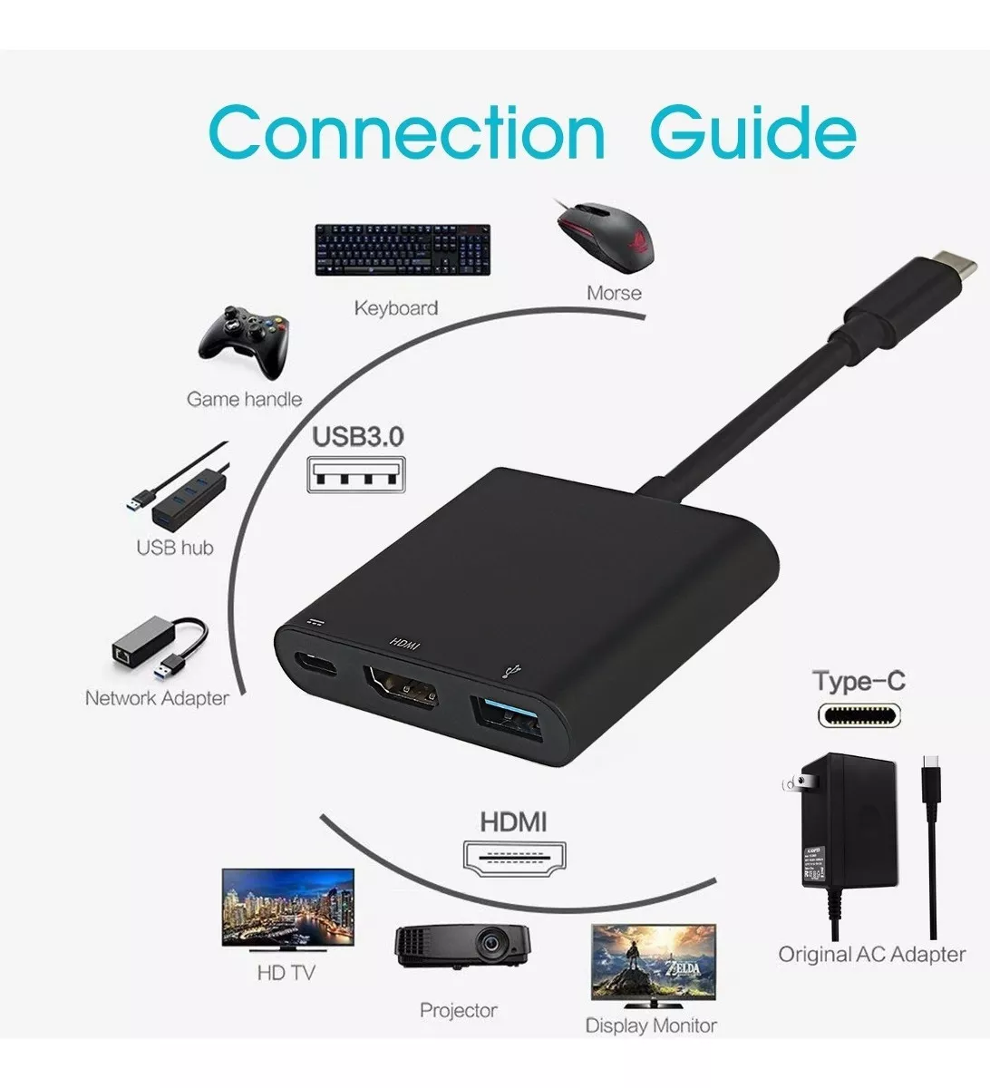

    5. Hm... so would the OTG works when connected to the power using one these switch USB-C to USB/HDMI/Power supply? (dunno if I can post store links here, so image attach)

    3. Only the official dock is supported for usb host mode at the moment. If it isnt the official dock, it is a 50/50 shot.
