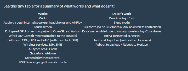

sorry to be a pain just 2 questions, does this support docked mode if so how as mine doesnt pick up. and also can this use the switch pro controller
Ninn
Dec 1, 2006
479
1,629
Japan
No dock mode or pro controller support yet.
Or sleep mode. Will be awesome once it has all those features.
