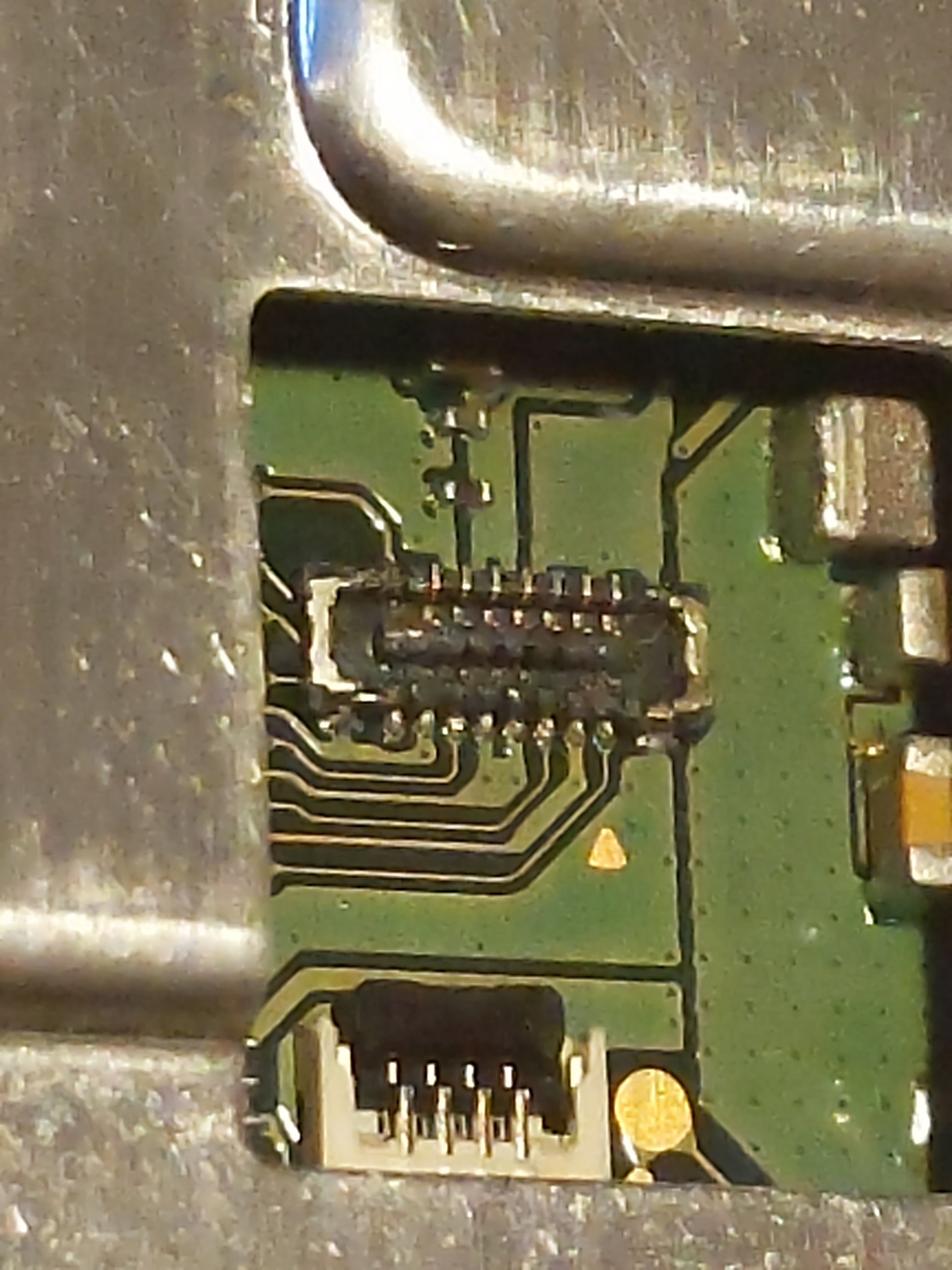

Then someone at the factory must be fed the soldering up. It really looks like it's been overheated when I look at the lit up pictures.
It's of course totally possible to exchange this port, and I would recommend that approach first. Problem however is to find a spare part.
I think that might just be an optical illusion due to the lighting. It almost looks like some upscaling effect was applied (something like HQx) when he zoomed in with his phone camera, because the edges of everything look smoothed out. The port looks damaged but maybe not melted, but the image is so grainy it's hard to tell.

Also can you get better pictures? Try holding the phone/camera as close as possible with it still being able to focus.

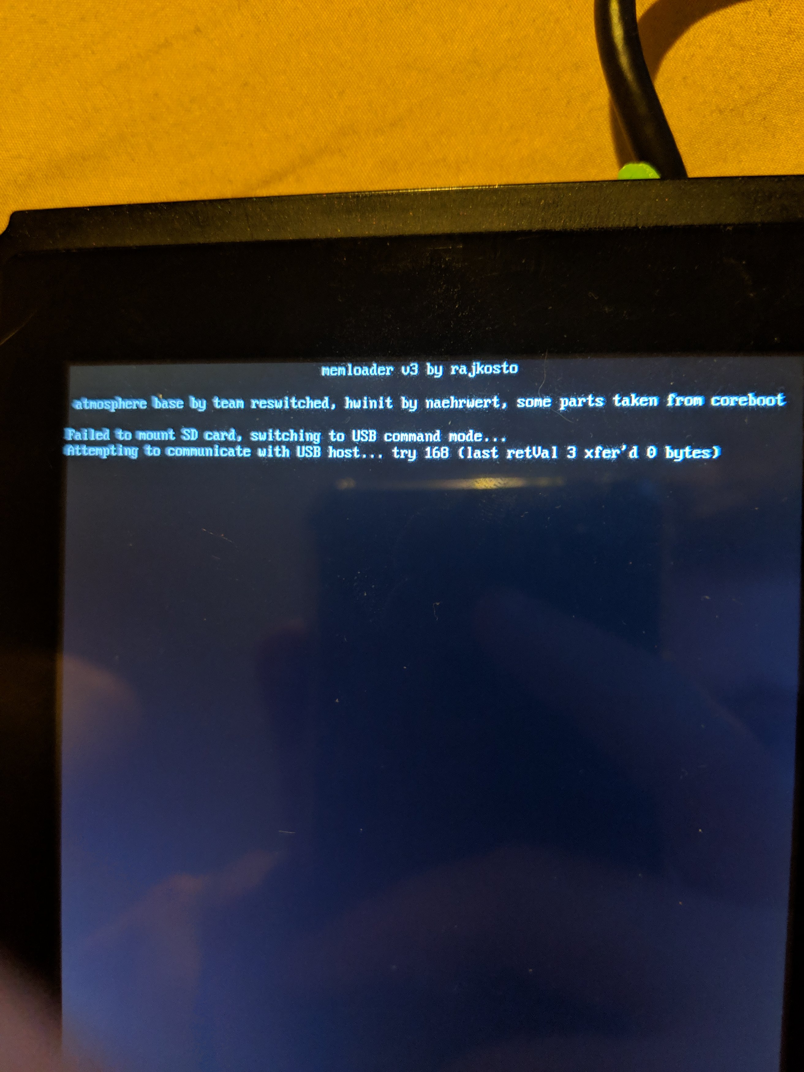

I seem to get this error when pushing Memloader.bin and the switch doesn't show up in HacDiskMount
Yeah I found out it was HQx that was causing the blur look
This is possibly the best I can get it to look on a google pixel 3 xl
That looks more normal, it does look like half the pins are missing though. Are you sure they weren't ripped out and are still in the SD reader module? They can't just disappear.
I think that error is normal if you don't have a SD card. Check device manager if the device shows up, you may have to install the driver again.

I already have the device installed as "APX" under my devices in Zadig and its my current libusbK (v3.0.7.0) driver but it still doesn't show up as a device in HacDiskMount for some reason

Also, I had a look at my old reader that I took out and replaced with this new one and there's no pins attached to it or any trace of pins anywhere.. So they must have fallen off somehow while I was doing something or rather with my switch.
