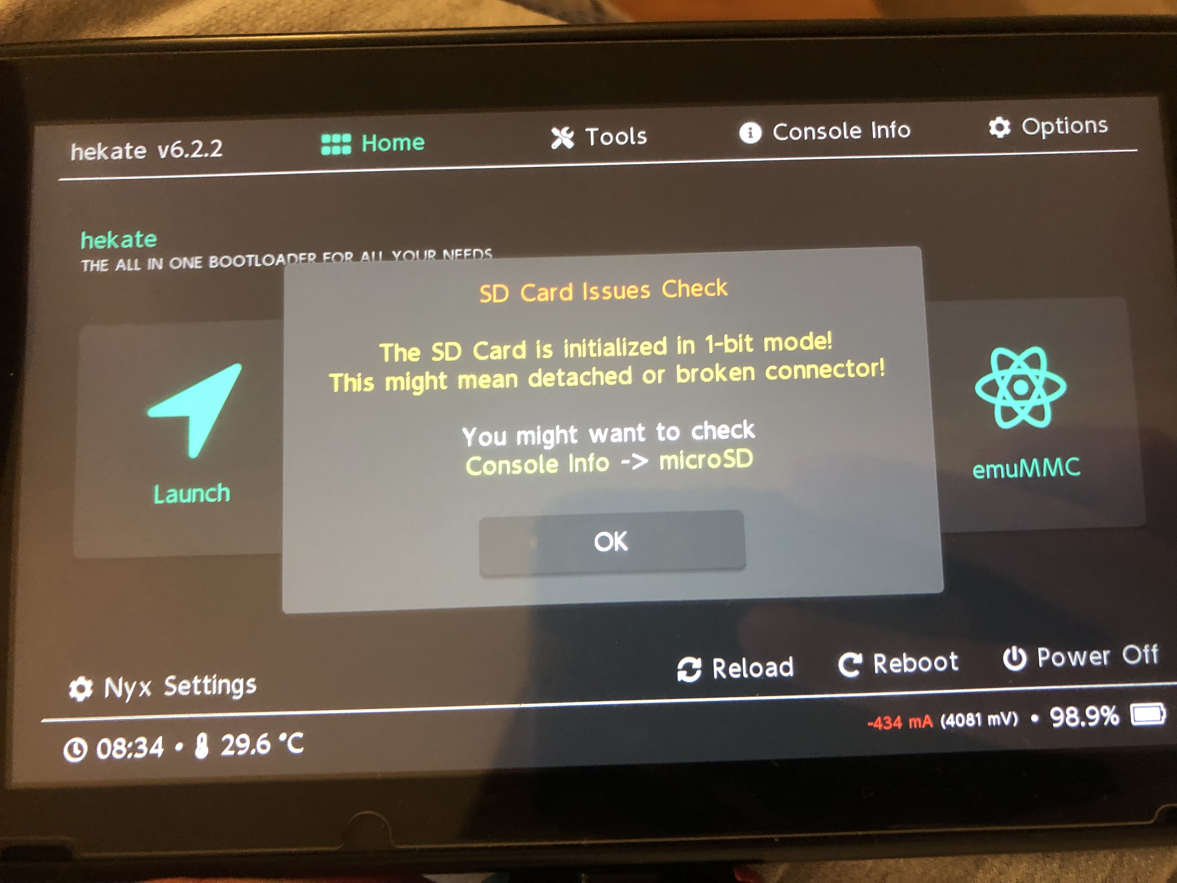

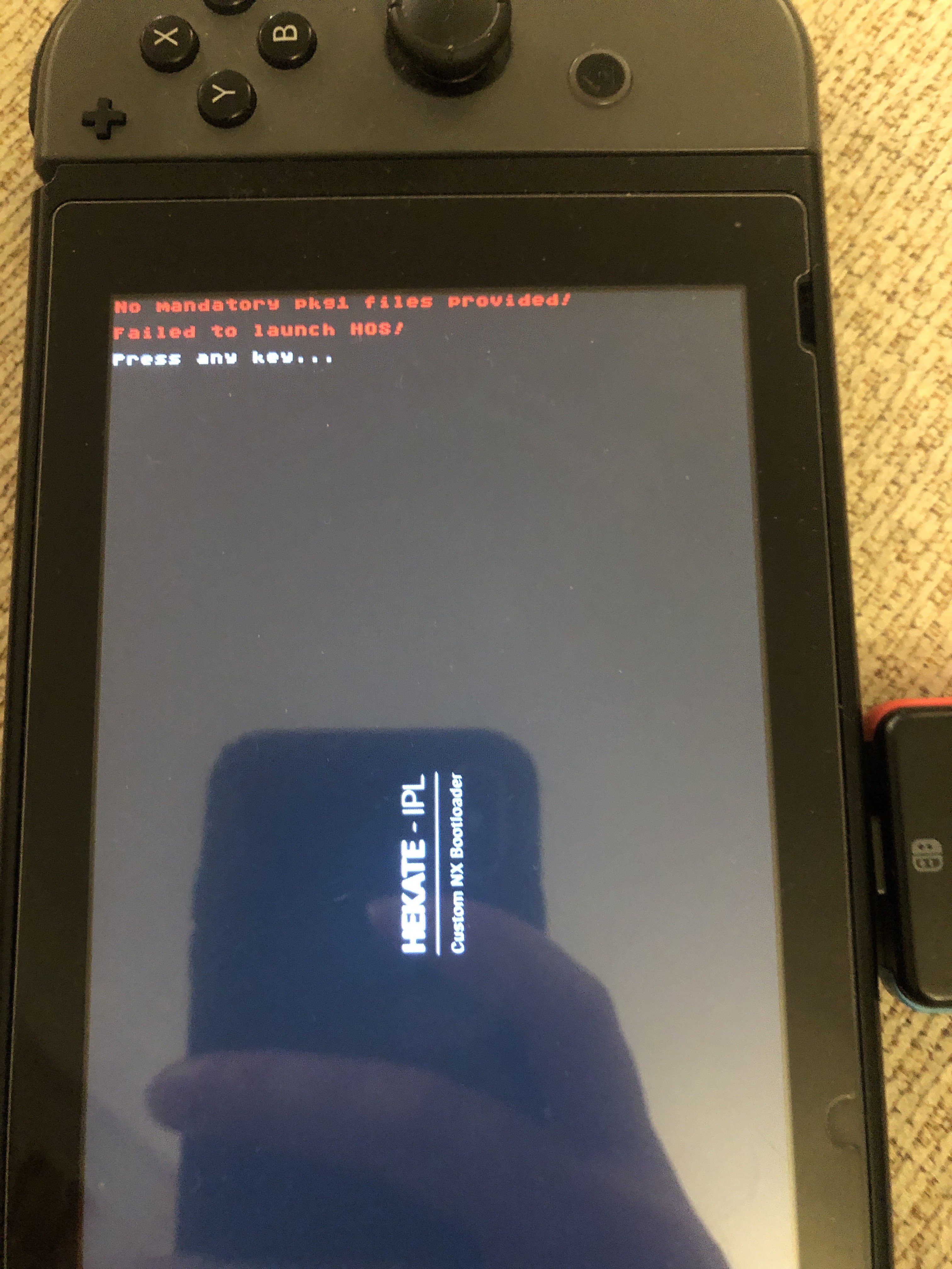

I can only boot to hekate, I get all kind of error messages after updating my switch, one of them is 1 bit mode in hekate that from what I understood is a hardware failure, not even sure how to fix that... and the other one is when I try to boot to atmosphere I get the message in the photo below. I want to format my sd card hopefully it will fix everything, but I don't want to loose my saves. So is there any way I can backup my games saves?

OP, your picture looks like you have conflicting versions of Atmosphere & Hekate.
I told him to get the customized fusee.bin in the sigpatches thread and he said he did, but I wonder if he just got the sigpatches and assumed it was included because it's not. You have to read the first post and get a link to it on some page in the thread.

I am using emunand as far as I know... this is the error I get with the one on the original message of the post.
my hekate is 6.2.2 so as far as I know it should work with any atmosphere right?

You failed to mention the error in your thread yesterday. Your Switch may need repairs.

If you are getting 1 bit mode then you have a SD card connector/flex problem.
