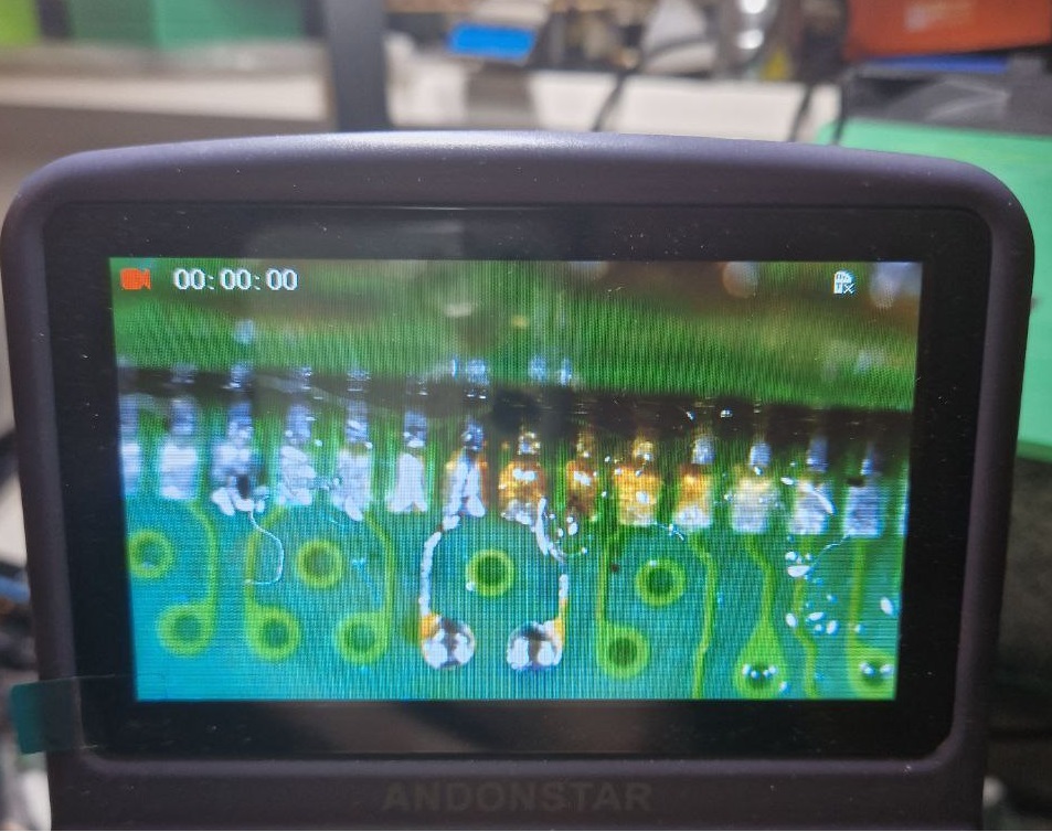

I checked again and found 2 traces to be torn, so I repaired the traces, checked the two repaired traces, they do not touch each other and have a good diode-mode-reading, so back together and: 1080p, yay, but the flickering is still there...
We checked: 2 different TVs, different and a brand new hdmi cable, no flux in the port. The cap is still there and is soldered on both sides. Every component seems to be still there.

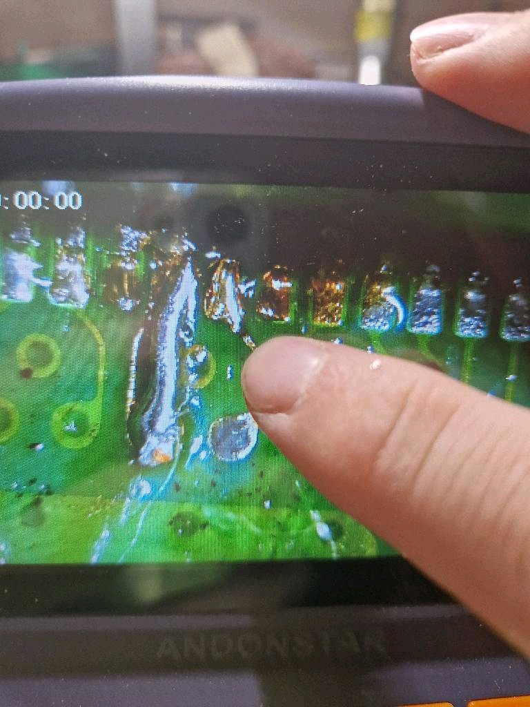

The repaired lines are for the Pins 9 and 10 (like in the picture shown, sorry, no better pic available as of now)
What went wrong guys? I don't know what I could have done wrong... Any ideas? Maybe a faulty hdmi port?
