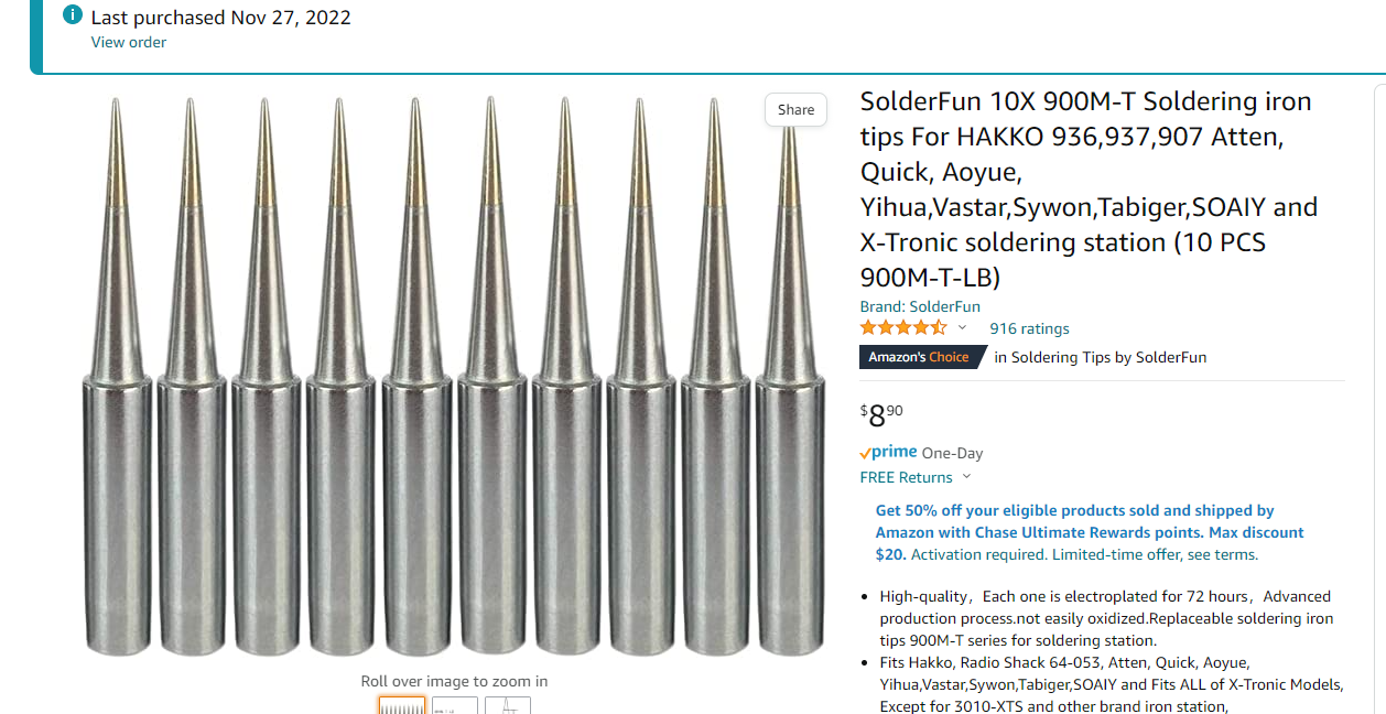

One last thing, what type of soldering tip are you guys using? I seen some people use the IS. Is that better with trying get solder on point D?
Peeta01
May 3, 2007
30
295
I recommend that you use a fine-tip.
Like these?
Reactions: SylverReZ
HelloShitty
Jan 16, 2022
235
123
343
Antarctica
Don't choose the tiniest or finest ones. At least in my case, the smallest I have is not very good or I don't have the skills to use it.
Remember that te smaller the tip the less surface there is to transfer heat. And that was a problem to me! When I thought I could be more accurate with a pencil shape tip, I end up not being able to melt solder properly because there wasn't enough heat on the tip to make it melt. At least it was the feeling I had while using these tips!
Peeta01
May 3, 2007
30
295
Thanks!
Hm... heres the IS tips.
randy_w
Feb 27, 2021
552
33
1,070
Personally I have the best experience with pointed tip and bent tip:
Because everything's so tiny and if you use a chisel or knife tip the contact point is larger than the smd component. Anyway start with a smaller tip first, if you don't like it change to a larger tip
