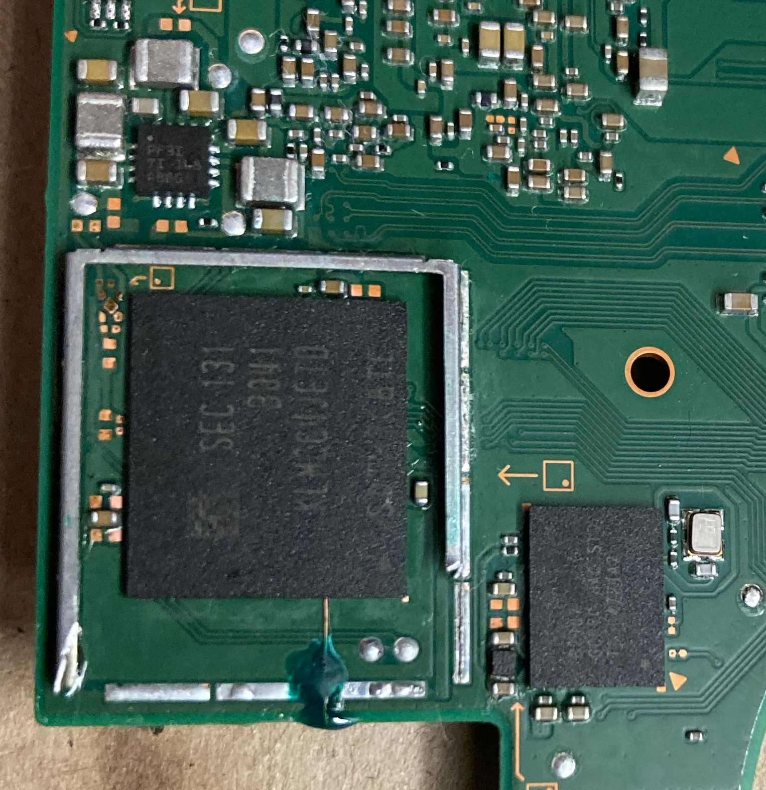

HWFLY OLED install. I can't get the DAT0 connector to connect.

Make sure to add solder mask on the left and right sides of it. I find that 1 joint is too flimsy.
Also, not many people know this but add solder mask on the solder joints as well. If your solder is a little bit too much, it could touch the nand shield and shorting DAT0 pin to ground. Better yet, add kapton take on the insides of the nand shield.
I might had similar problem but not due to excess of solder. I think my problem could be because I soldered the enamel wire in the wrong direction, and then, to route the wire to the correct direction I had to bend it a bit inside the NAND frame! An maybe the wire did unbend itself a bit and touched the NAND frame. Then, I had to disassemble the console again, and make sure that the wire wouldn't touch the frame again (in case that was the problem) and also reflowed the anchor point and tried to give the adapter a tighter push underneath the NAND chip to ensure better contact with DAT0 line.
After that, things have been running smoothly!

I didn't use solder mask, but I used some resin from my resin 3d printer and cured it with a UV light. No idea, but figured it was about the same thing. I put it on both sides of the DAT0 pad, and put a dab near the contact point you scratch off on the board as well. Put it near the connection, but not over top; in case I needed to go back and resolder at a later date.
Thought about using super glue, but read if heated (assuming in liquid form) it can produce some nasty gasses. I know with brake cleaner that's chlorinated, a drop of that stuff vaporized can cause permanent lung damage. Decided resin was safer. lol
I used solder mask in almost every point of the PCB (but not on the mod chip). It made me feel a bit more comfortable regarding the wires to have less freedom to wiggle around and eventually get lose of the solder joints. I know that if the joints are properly done, this won't happen, but it can't hurt adding a bit of solder mask!
Yeah. I could see it putting a lot of stress on solid wire if you did it backwards, bent it, then ran it the opposite direction.
I think I’ll line the inside of the shield with kapton like the other user mentioned; next time I take it apart anyway. Shouldn’t hurt anything and could prevent some boo boos. But it seemed to be a real solid connection and the resin I put on both sides should keep the pad from moving at all. It flowed around a few components, so that should keep it locked in place.

Yeah, in my case it was the inexperience. I didn't think what the direction the wire should take when I soldered it. And it happened again with the GND point but in latter, as it has more space around it, it wasn't that critical.
Other than that, I think I did a reasonable job for the first time.
