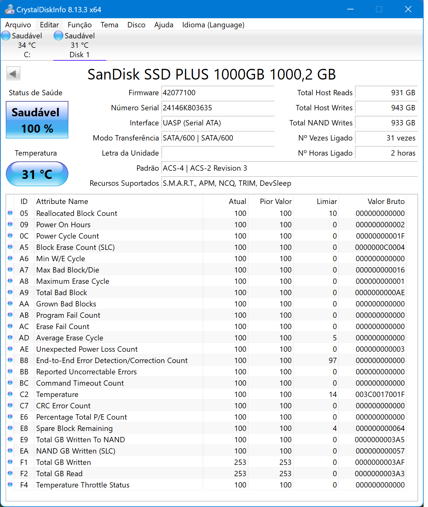

Maybe the SSDs don't support the SATA 1.5Gb speed anymore used by the Wii U.
Maybe you see something in the system logs
Do you know of any brand of SSD that has been proven to work on the Wii U?
(I saw pictures in another thread of a 120GB Silicon Power working, but that brand is not common in my country)

What does Crystal Disk Info say about the SSD when you connect it to the PC?
I had success with a Kingston A400. Also you could try setting it to GEN1 in the SEEPROM.
Maybe you have success with an older SSD from ebay? It's not like the Wii U will profit much from a new one
I had already tried to put it in GEN1, but it didn't work either.
The Crystal Disk Info data is attached

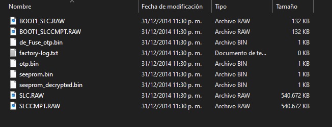

JID
Sep 9, 2024
41
5
Venezuela
I have a white Wii U with a flashing blue light failure, it does not show an image. I soldered the Raspberry Pi Pico to the PCB as shown in the image and backed up all the NAND files.
I hope you can help me
