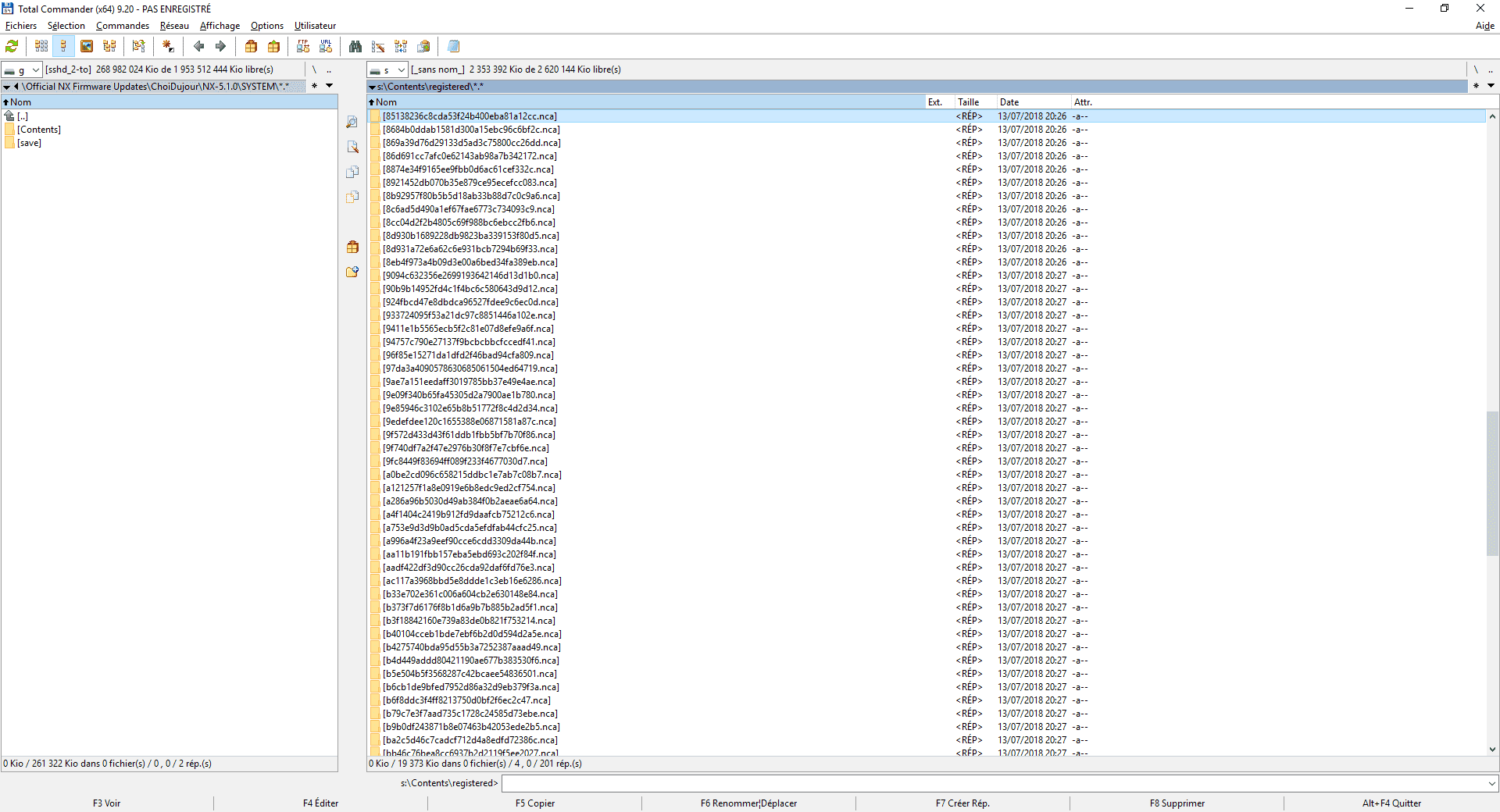

I don't understand something, I cannot update my switch above firmware 4.0.1.
I 'm stuck on a black screen. I used the same methods as to update from 3.0.1 to 3.0.2 to 4.0.1 and I worked but when I try a firmware above (like 4.1.0, 5.0.0, 5.0.2 and 5.1.0) I got a black screen
Andalitez

lacrima08
May 28, 2009
45
395
France
Is this after launching FW for the first time?
Are you sure the black screen you see is not in RCM mode?
Yes, it's the first launch after the end of the guide (ok for firmwares < 4.0.1)
And Yes I'm sure that's not the RCM mode because no backlight and cannot inject payloads, I must force poweroff

try using total commander to copy the SYSTEM files over instead of explorer ? Take a screenshot of the Contents/registered (in total commander) folder when youre done

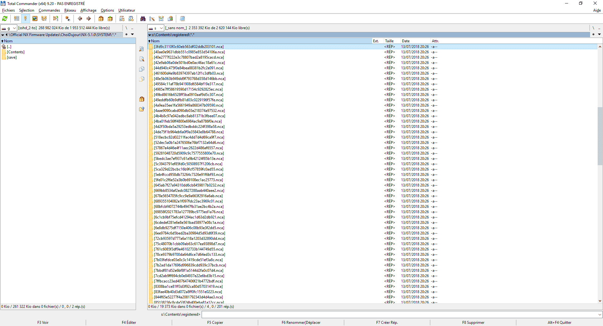

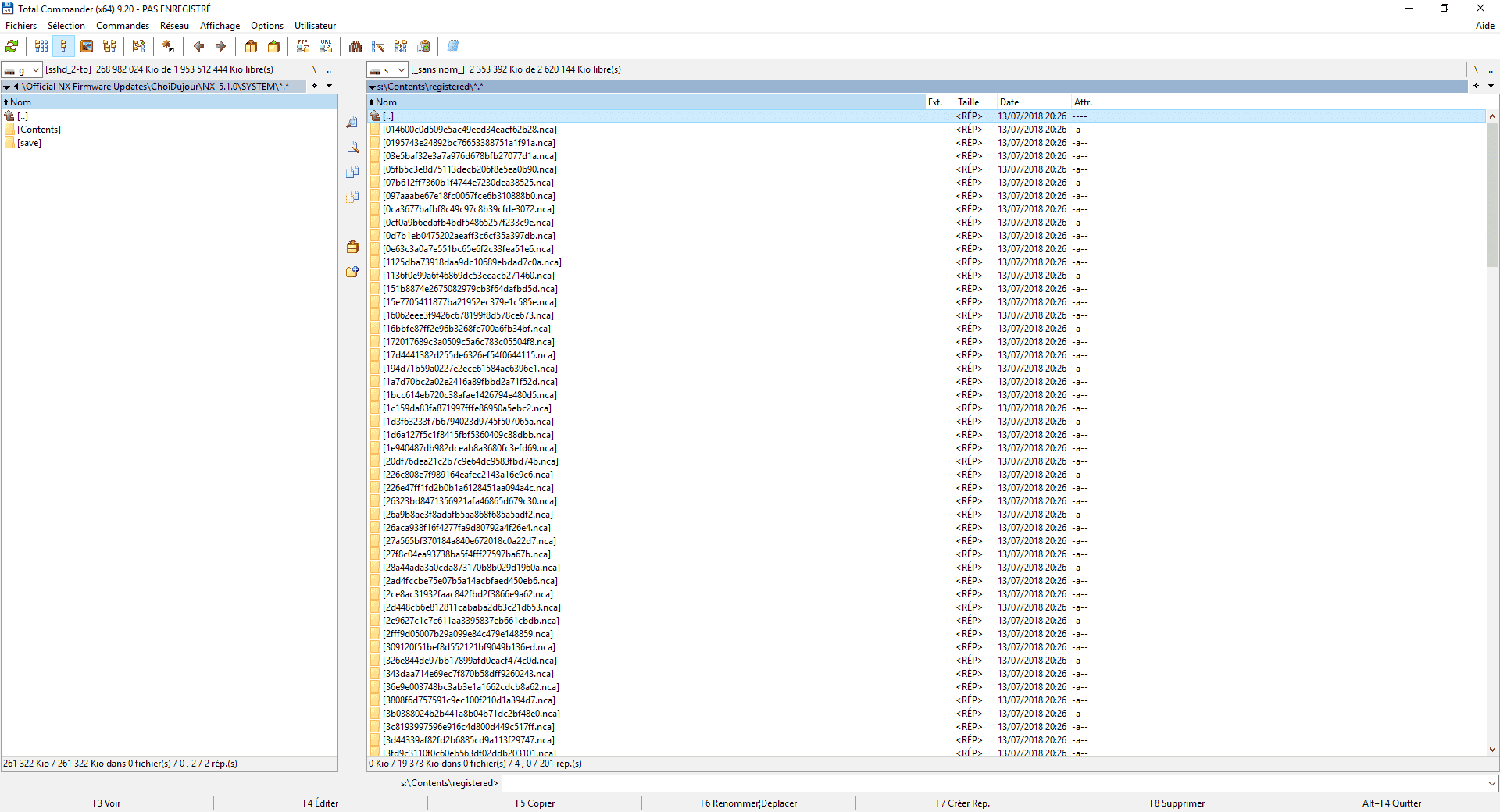

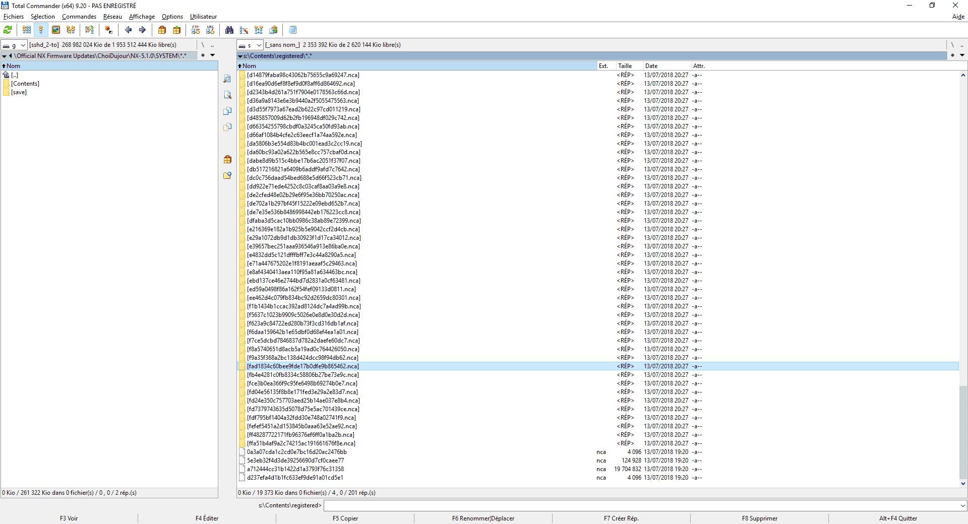

lacrima08
May 28, 2009
45
395
France
It seems to be OK with total commander ?!?
I've the switch logo and now I'm on "First Launch Assistant" (done System Initialize
BIG Thanks @rajkosto
Why it's working with Total COmmander and not with Explorer ? Do You have an idea ?

i mean, if you give it a smaller file, restoring it will only restore whats in the file, leaving the rest of your boot0 as it was (console-specific)
because archive bits.
run winver and tell me your windows version

lacrima08
May 28, 2009
45
395
France
I'm on Windows 10 (pro) v1709 16299.371 (not update because I'll change my SSD soon and will format for new install (v1803)
