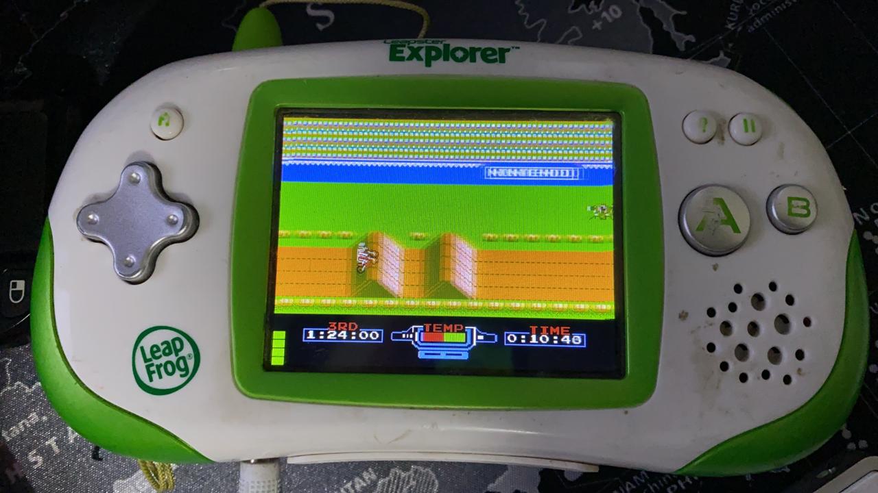

This is my progress on Leapster Explorer with new 2.0 alpha version
I saw screen flickering on the retroarch menu, but not on the games
I think the image don't have the button mapping, so I was not able to push select/start to start games
I used ubuntu 18.04.5
I installed the dependencies (python 2.7 manually)
I replaced python2 by python2.7 on script to make it work
To boot into recovery mode I used ( Hold L + R + ? and touch Power)
A few pictures
