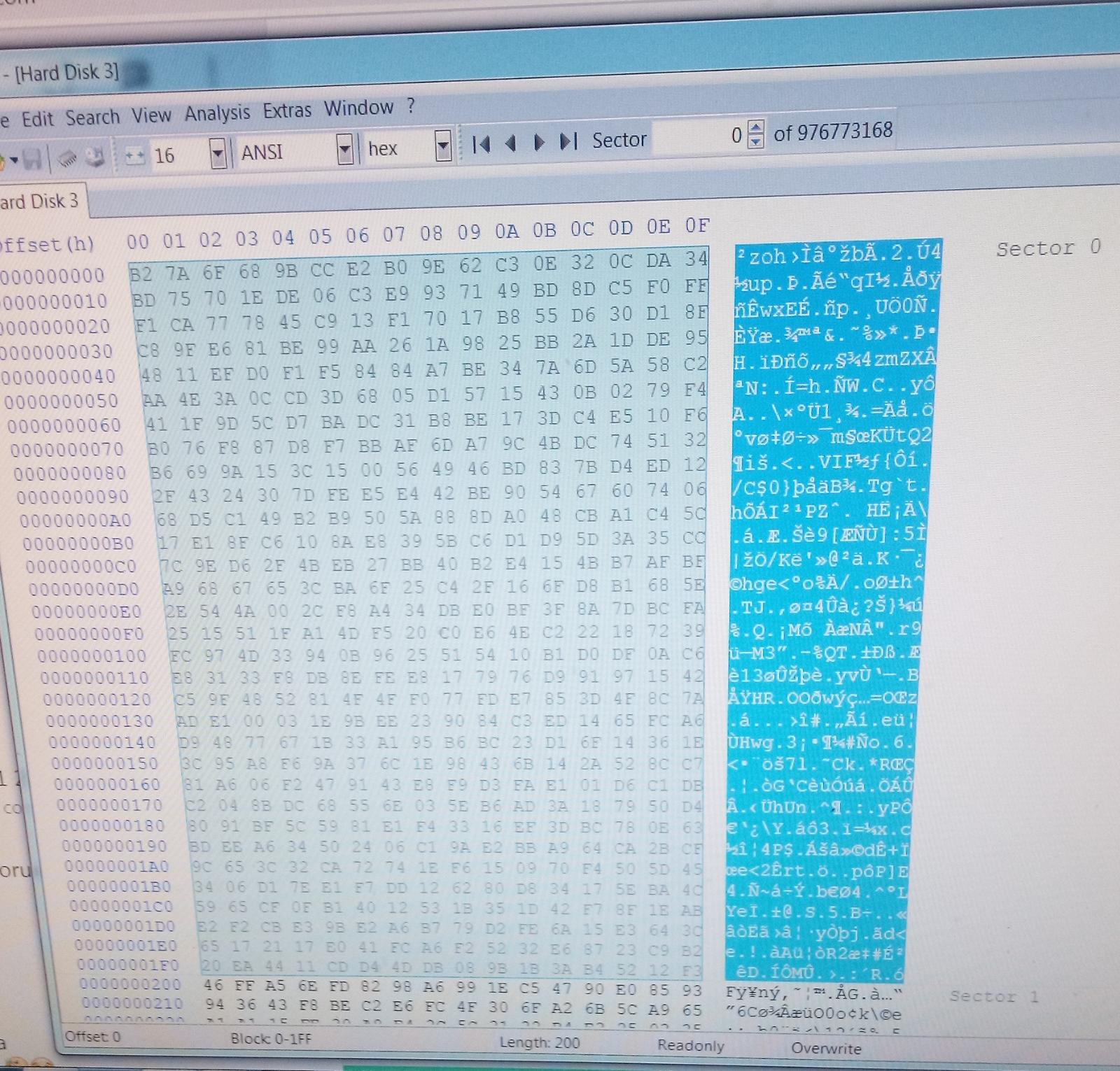

my hdd enclosure broke so i got a new one, but the Wii u doesnt detect the hdd now or even ask me to format it, would replacing the first 64 bit of the hdd with 64 bit from an hdd formatted with the new enclosure make it detectable again
EDIT: just tried replacing the Sector 0 with one from an hdd formatted on the same enclosure, didn't work. maybe one sector isnt enough.
