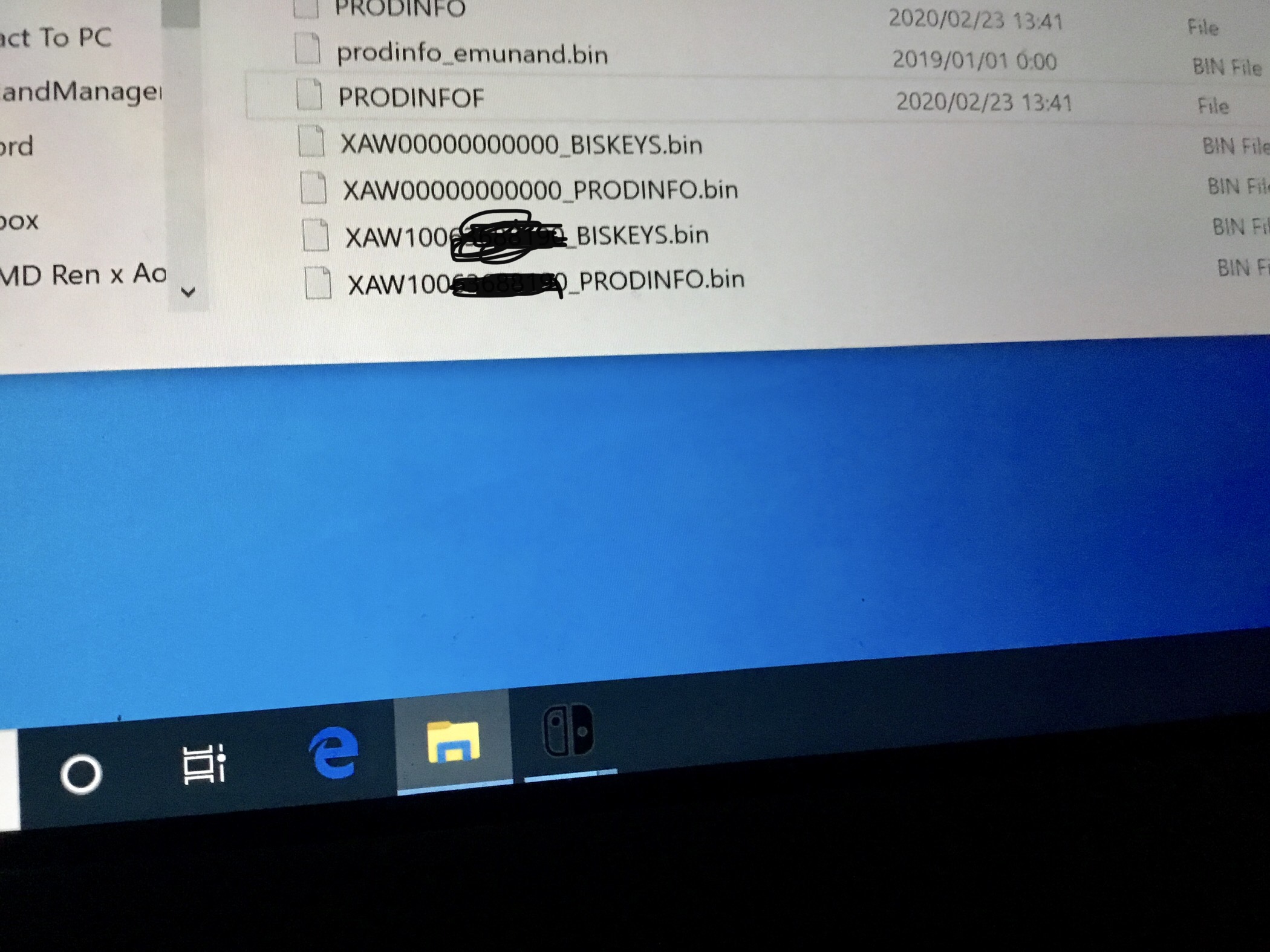

    I have the same problem. According to the owner, he told me that he ran Incognito and accidentally backup the XAW0000000 file. So whenever He runs it, or restore it. It will be in the same state. As the TC posted, I also looked into the SD card and it show the Offical Prodinfo.bin in the automatic backup folder. It has 2 files. 1 with BISkeys and the other with Prodinfo.bin. One has 1 kB while the other has 32kb I tried the step above restore it, it I get an error s it seems to be a different file. So Can this switch no longer go back to it original serial number? Will it no longer work online? I’m sorry. I am a noob to this and have very little experience with hacking. Thanks in advance.

  19. dotmehdi
    dotmehdi Advanced Member
    Joined:
    Jun 1, 2019
    Messages:
    87
    Country:
    France
    Follow these steps :
    1. Make a rawNand Backup from hekate or NxNand
    2. Boot your Switch into RCM Mode then use TegraRCM to mount emmc_rawNand
    3. Use NxNand to a. mount the nand, b. backup the actual Prodinfo partition (just in case, even if its a modified one)
    4. Restore the Prodinfo partition from your 32kb file
    You have 1 out of 2 chances that the backup file has been made after the Switch have been "anonymized", but try it anyways, as long as you made a rawNand backup, it's no big deal to manipulate the Nand at this level.

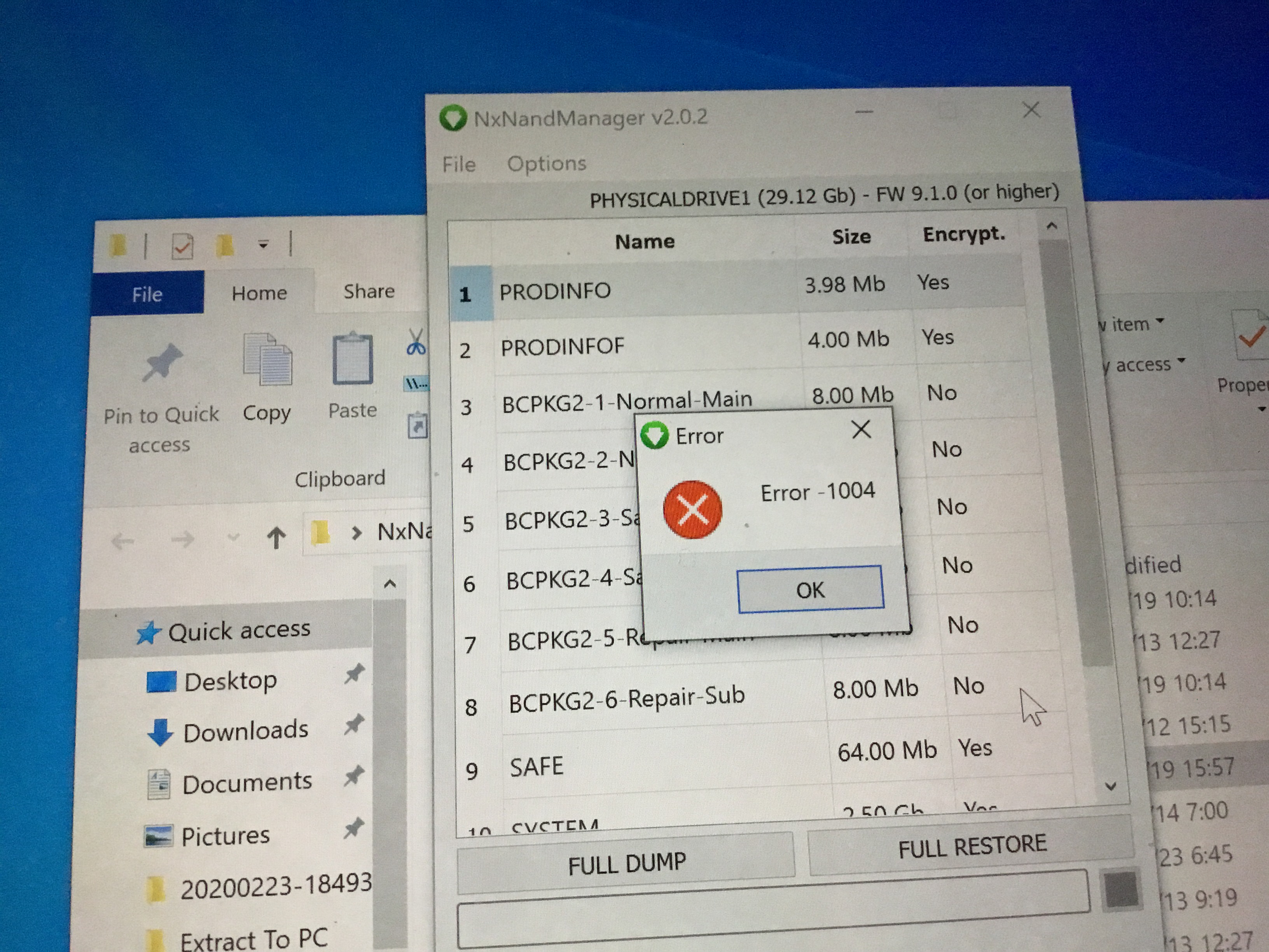

    Hi again. I did exactly as instructed, however, When I try to restore it from the automatic back up from my folder on my computer I get the code error 1004. I also thank you in advance for your help.
