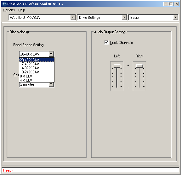

It is not that easy – and potentially even faster rotation.
The speed 1x, 2x,... 72x isn't directly rotations per second, but depends on the position of reading. Fast optical drives (all drives since way more than 20 years) read an undamaged optical disc with constant angular velocity (CAV, rotating with constant speed, reading faster when going to the outer part of the disc) rather than constant linear velocity (CLV, rotating slower when going to the outer part of the disc, reading at constant speed). Speed above about 20 times faster than playing an audio CD (80 min at 1x) can't be reached on the most inner part of the disc by a conventional drive.
Ironically the few drives (or was it just one model?) going beyond the usual maximum of 48x, 52x or 56x at best, spin the disc slower reaching 72x with multiple lasers.
