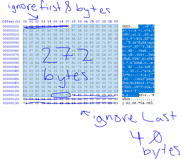

guys can someone confirm what lines from the movable.sed i copy over to LFCS?
mine appear to be completely different. i did a system transfer when i a9lh'd the 3ds i'm using.
i want to dive in but i want to confirm i'm doing this right first.
Basic jist of what to copy over is as follows (sorry for bad handwriting lolol, ignore first 8 bytes (SEED...) and last 40 bytes.
Last 3 bytes of the seed should be 00
Reactions: demounit

I originally did a system transfer with the 3DS I'm working with right now. If the moveable.sed and LFS are different, which one is the one to edit? The LFS with the different data from moveable.sed, or vice versa?
copy the 270bit value from movable to LFC. I cbb looking for the photo of which to select so just find it a few page back
