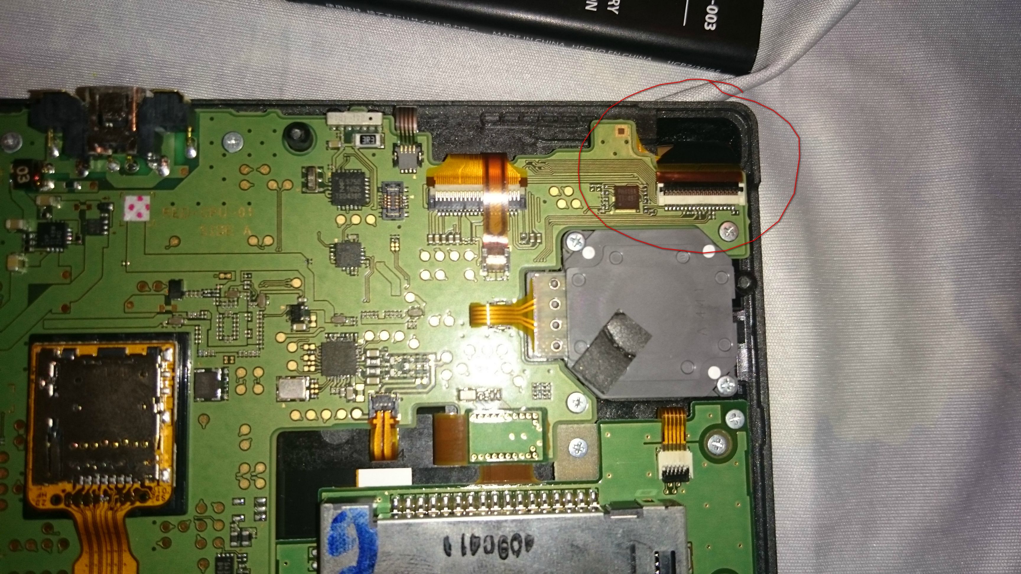

Kevinomancer
Nov 24, 2021
23
Japan
Thanks for the reply. i did try recovery mode 1st but all I see is black screen and got sound back for 2 secs then nothing.
For the other method, I also left the 3ds power on with black screen for 30~45mins but again, nothing happened.
Kevinomancer
Nov 24, 2021
23
Japan
nvm I found a fix. Thanks for the help GBATEMP community.
Turned out it was the camera that was faulty, disconnect the camera should work.
thank again for the fix suggestions.
here is the quote show where the cable is :
Yup 100% Correct all i could gather was the camera on that model somehow interacts with the home menu even if one is not using it??? Wheras on a 3ds or regular 3ds xl it will boot and show the home menu. But if the camera is activated it will promp error turn off the console odd lol... But who needs a camera when you got a9lh bs9 etc etc :rofl2::rofl2::rofl2: @ Ninty there i said it!!!
Should be that one and good luck...

thominho
Feb 9, 2014
39
28
947
Greece
Thank you for mentioning the resolution. Now, if I see the same error I will consider first disabling the camera.
