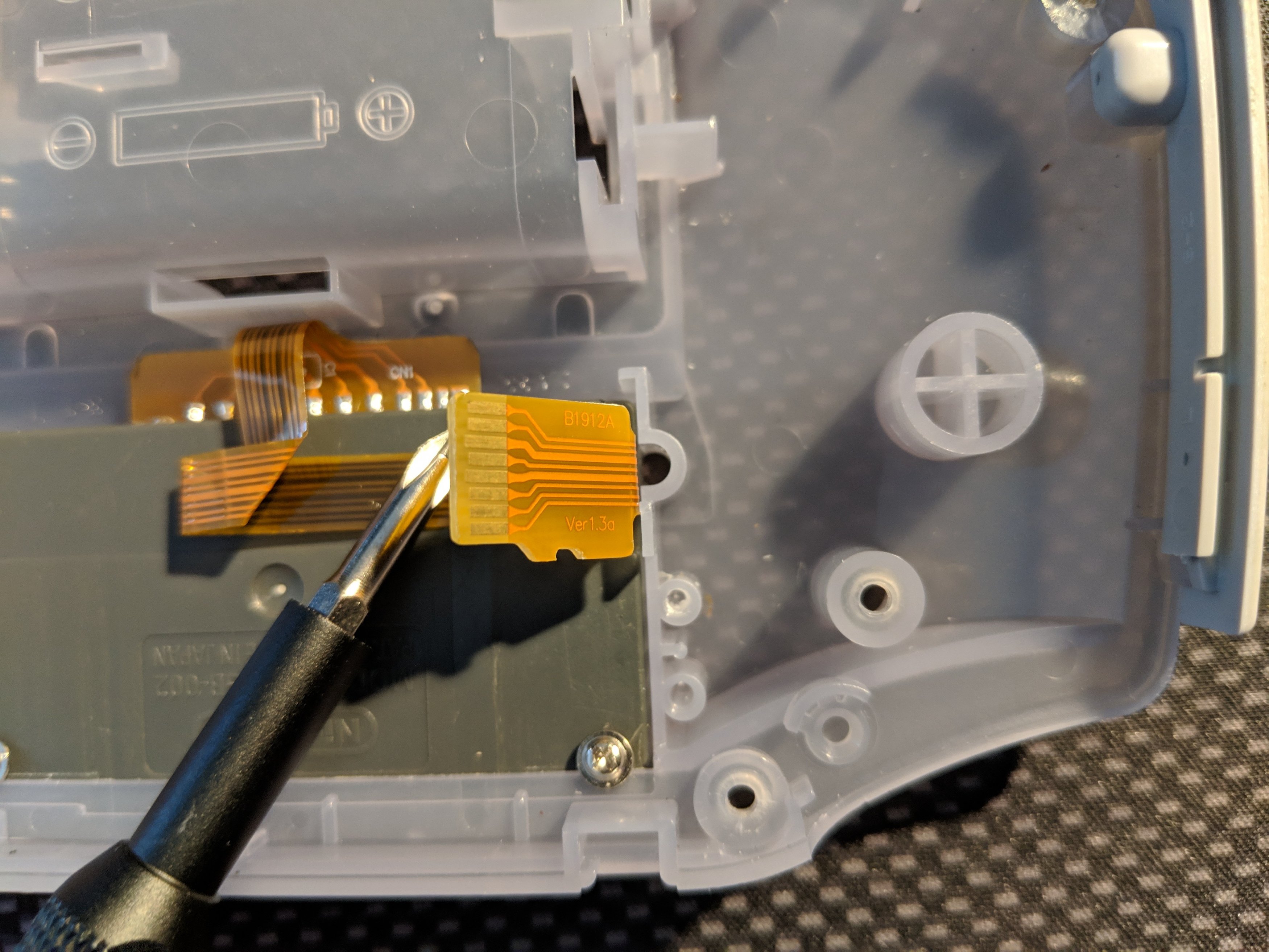

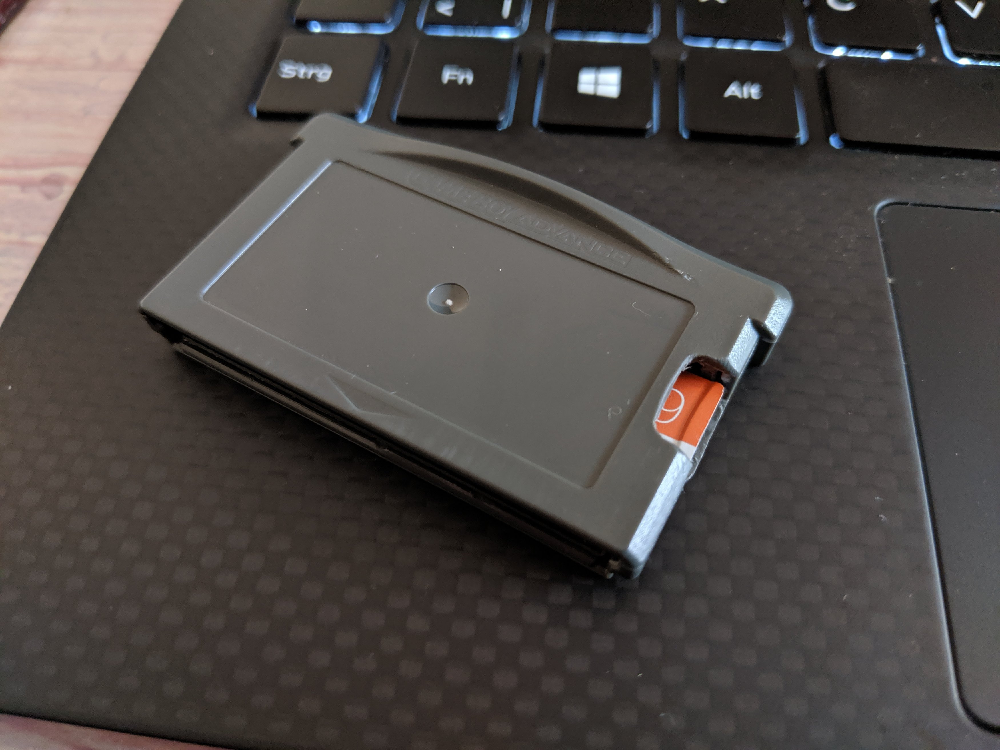

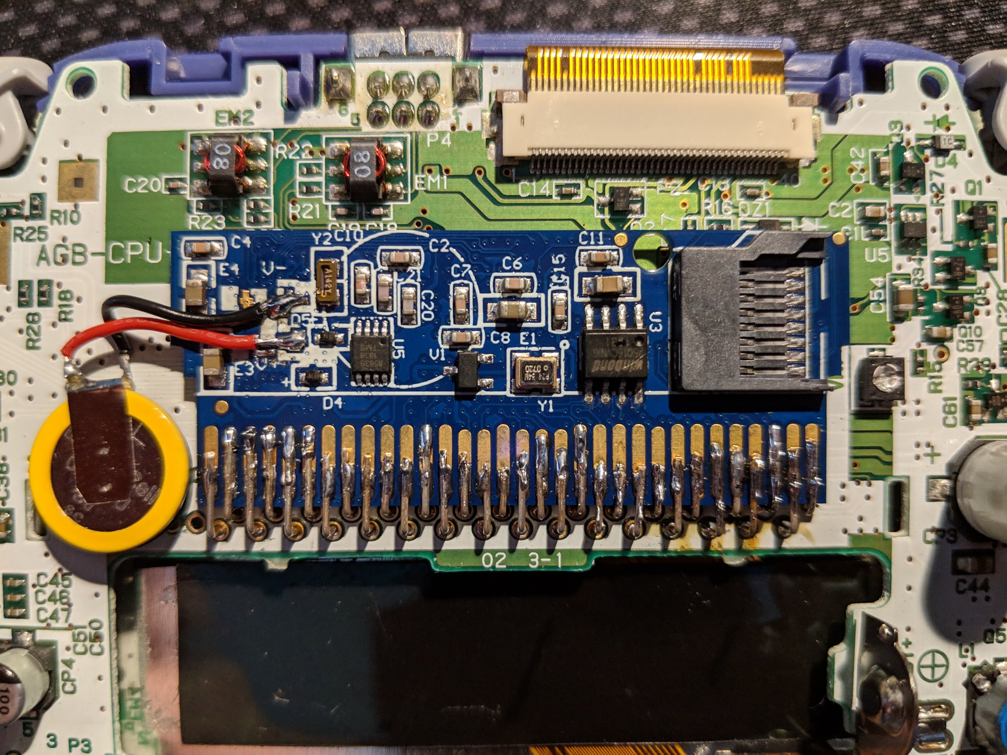

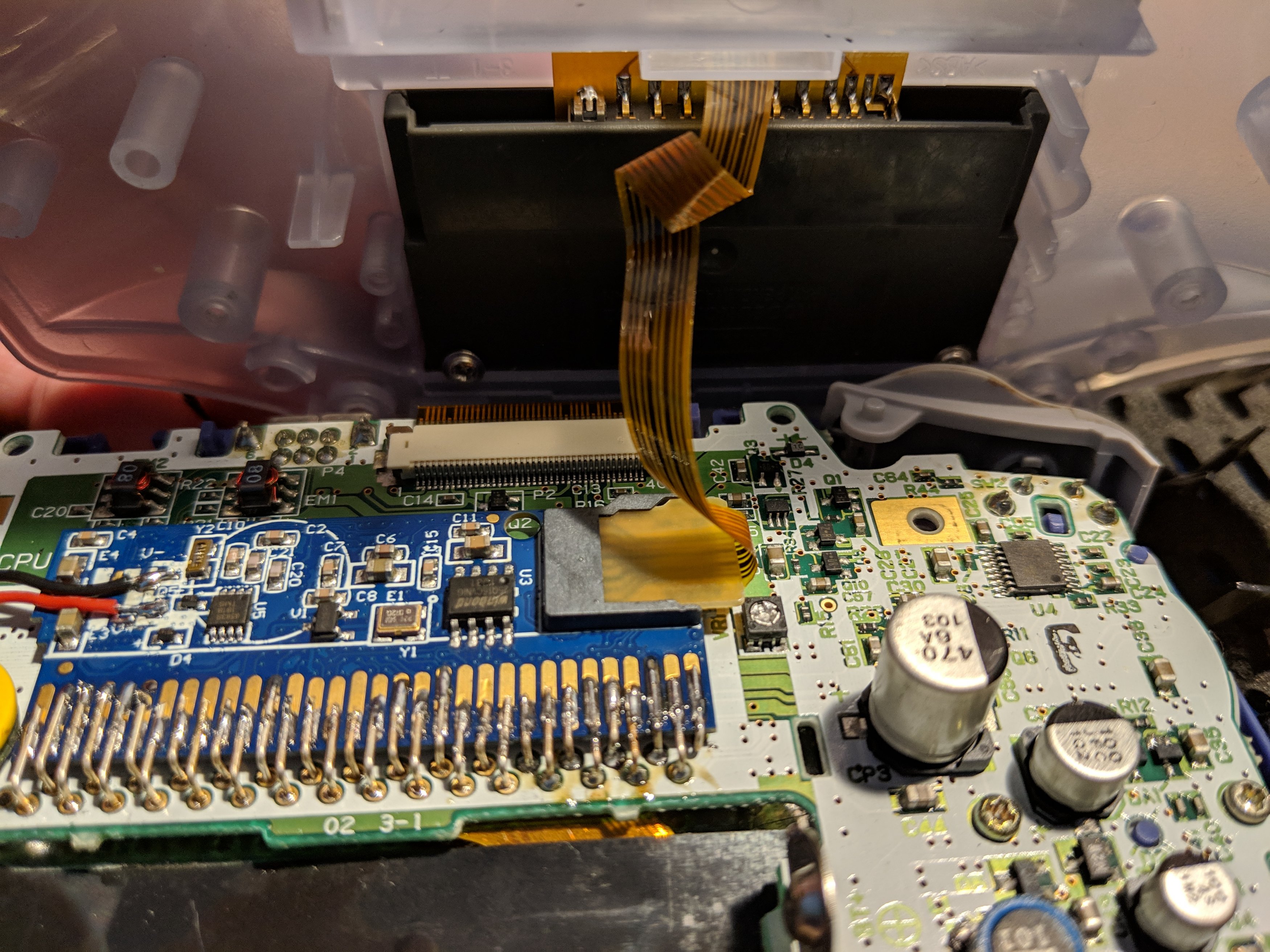

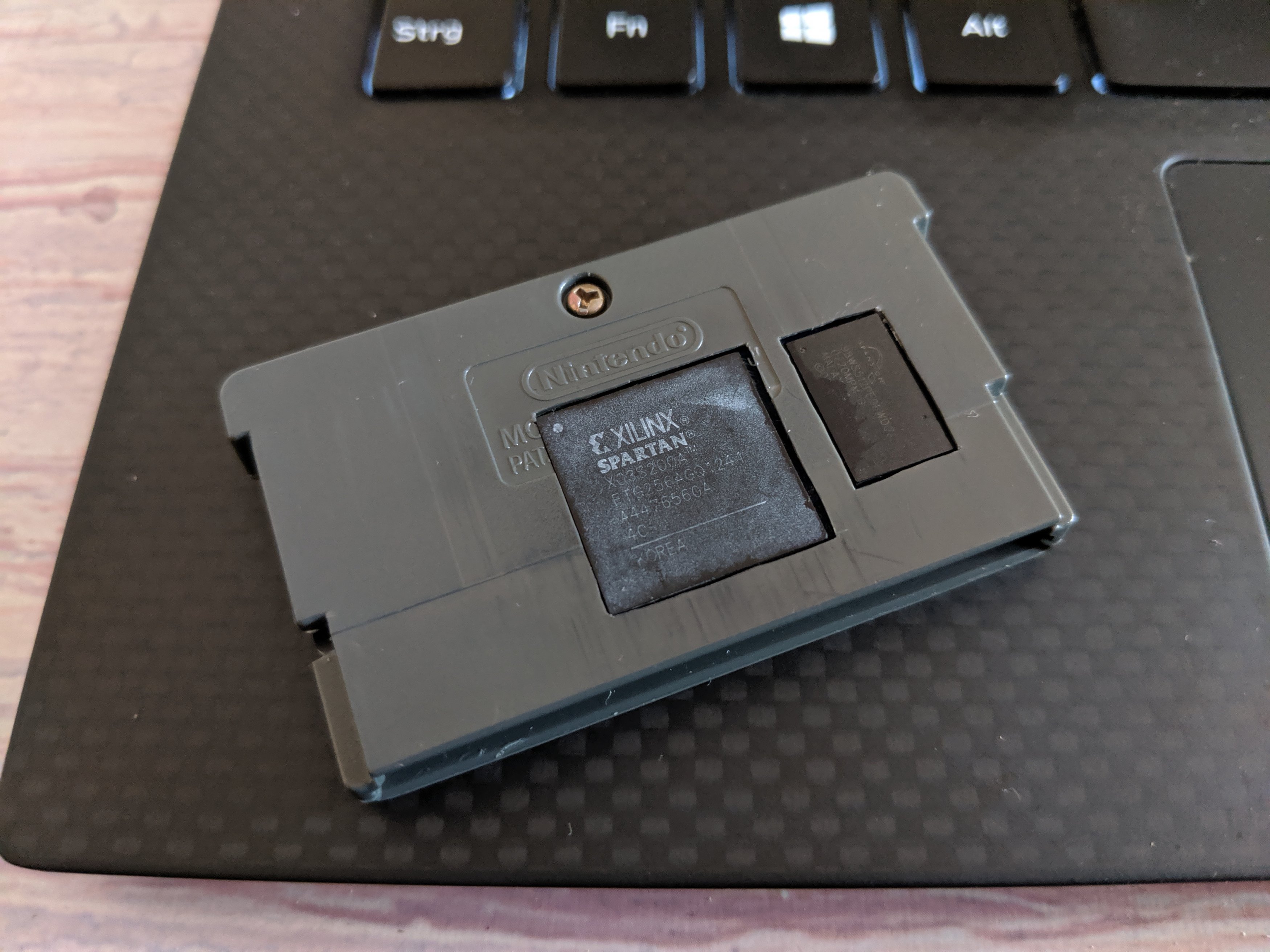

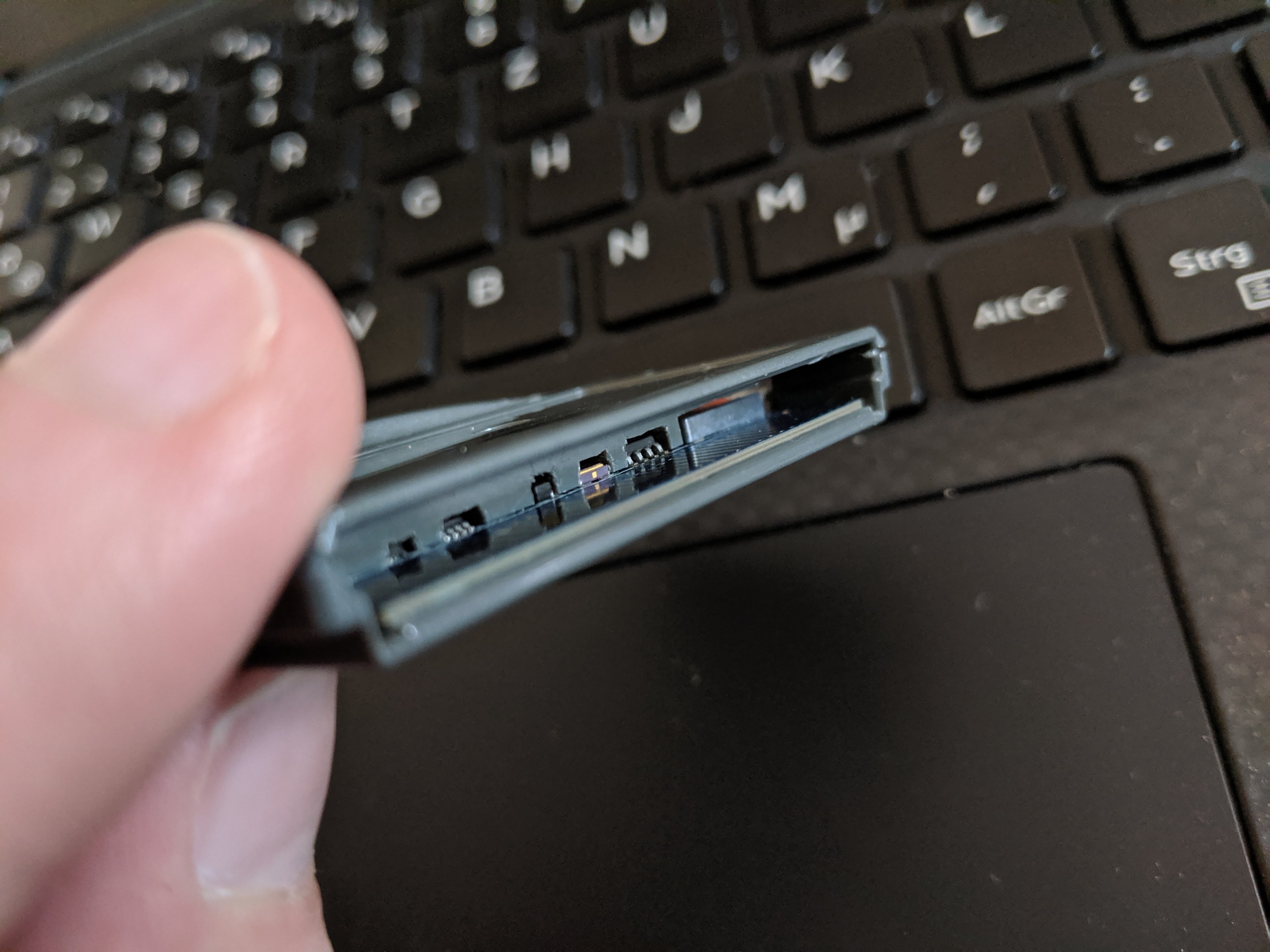

Okay, I got ezflash to boot up with the kernel and FW
the only problem i have is that only ezflash boots and not my normal game carts.
i got a very similar problem with the first release of the ez flash omega.
the case was made pretty bad and the bga soldering of the fpga did the rest. a very few weeks after usage is starts with errors like
Firmware Update V00 found, etc.
after i disaassambled the case is saw that the pcb was bent a little bit and the FPGA is going to lift off.
i was not able to repair it, so i bought new one about 2 weeks ago.
ezflash made a better case, it is not that much strong in the gameboy.
but that doensn't matter in my case. I made an own housing for the pcb from an original nintendo game. because the original case is not perfect at all.
I cut out holes for the chips in the back from the case so there is no further mechanical force on the chips itself:
the second one i hat i soldered it directly into my gba where the cart slot was defect. i used then another old game housing for holding an standard SD Card and used a Adapter with SD Slot and Micro SD Connector, so it can take default SD cards, too.
kind regards
View attachment 166483 View attachment 166484 View attachment 166485
View attachment 166488 View attachment 166486 View attachment 166487
kind regards
kind regards
Thank you so much for posting this.
It gave me great insight into fixing my own ezflash omega. I created my own case for the ez flash omega from an old gameboy boy. I did everything like you but that didn't solve my issues. Then I came back to this post and read "the case was made pretty bad and the bga soldering of the fpga did the rest", I went and checked the bga soldering on the main chip and indeed, it was a mess. What I ended up doing is very carefully reflowing the 3 chips on the board to make sure all the solder joints were making contact. Low and behold, that seemed to have solved all my issues with the ezflash.
I noticed that the freezing issues for me were not caused by firmware but by the bad soldering job from the factory. Now you may ask, how do I figure out if I have the same issue? Try playing your gaming without putting any kind of pressure on the cartridge slot. For me, if I didn't touch the back of my gameboy sp while playing, there would be no freezing issues. I think that also explains why the paper trick works for some people.
Also I do not recommend reflowing if you have no experience, you can easily ruin the cartridge. If you are brave enough to try it out, please remove the battery from the cartridge before reflowing.
