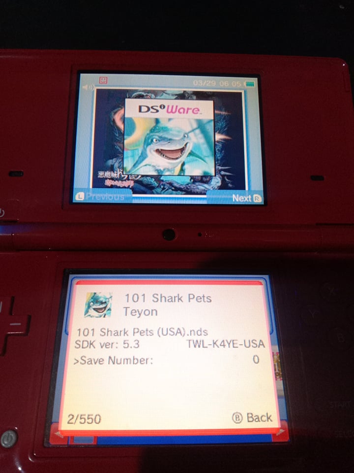

hello, just wanna ask how can i fix this, from version 23.4.0 i got 550 nds games, then after updating my tw menu version to 24.3.1 it just show 316 nds games, i haven't delete any games its still all in there, but it just shows 316, tested any later version after 23.4.0 and its all the same still showing 316 games, and after reverting back to 23.4.0 i have all my 550 games showing again, anybody knows how to fix this, i want really want to update my twilight menu, thanks in advance,

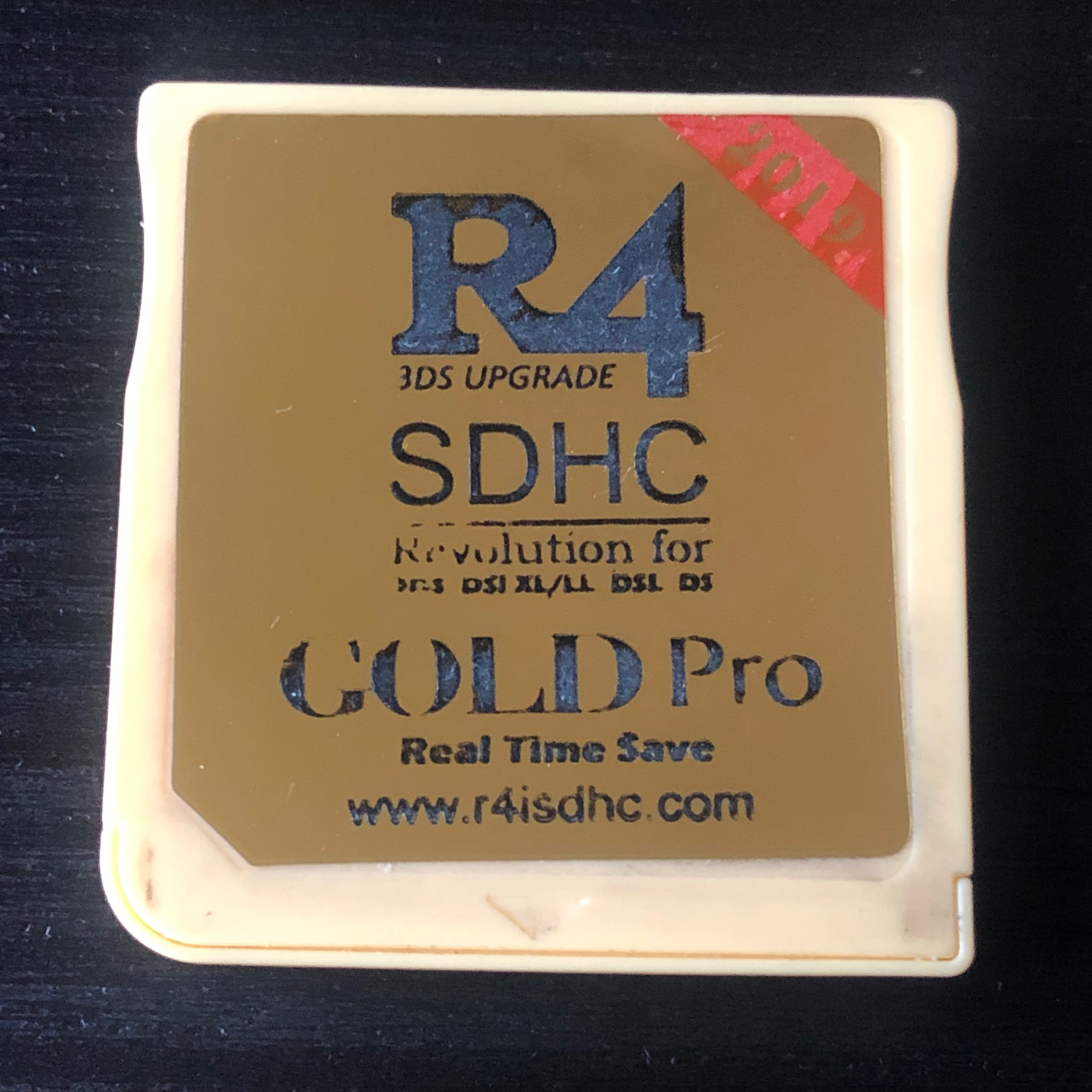

Is there an autoboot for this flash card?
I tried "R4i-SDHC, r4isdhc.com cards 2014+, R4i SDHC Upgrade Revolution, R4DSiXL3D, R4i Advance, R4-IIIi, R4 SDHC Revolution, R4(i) Pocket, R4i Gold (v1.4.1) (3DS) & R4xDS" but I get a fat init failed.
I'm pretty sure I had got it to autoboot on this one some time ago but I had put back YSMenu but now I wanted to try again TWiLightMenu specifically autobooting it.

hello, just wanna ask how can i fix this, from version 23.4.0 i got 550 nds games, then after updating my tw menu version to 24.3.1 it just show 316 nds games, i haven't delete any games its still all in there, but it just shows 316, tested any later version after 23.4.0 and its all the same still showing 316 games, and after reverting back to 23.4.0 i have all my 550 games showing again, anybody knows how to fix this, i want really want to update my twilight menu, thanks in advance, View attachment 303985
Split them into folders, there's now a hard limit of 320 files (not games, any file) per folder since a few versions ago.
That autoboot should work... Maybe try reformatting the SD.
It's a 2GB microsd, if I format it fat32 it gives me that fat init failed error and if I use the formatter it comes out as fat16 and I just get 2 white screens.
You confirm that it's the right folder and those are the right files (to put on the root of the microsd of course) for that flashcard right?
Yeah, that's the right folder. Might need to get a bigger SD, some flashcards have issues with SDSC (below 4 GB) cards.
