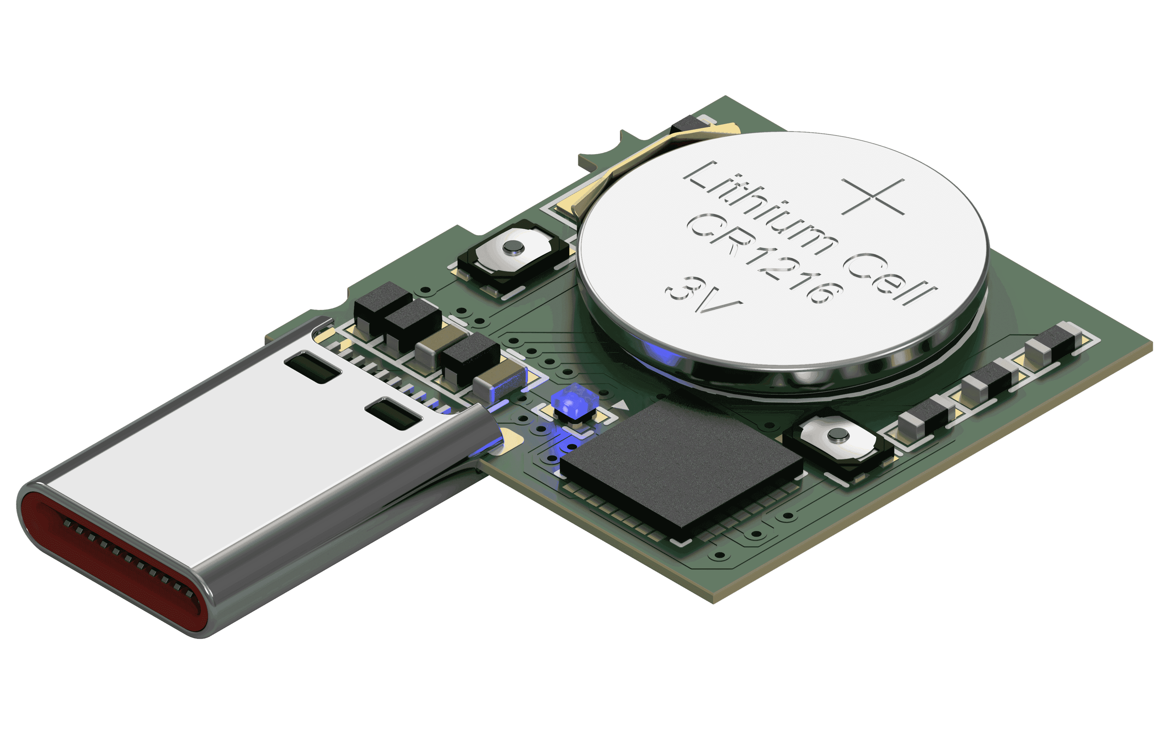

  16. MatinatorX
    MatinatorX DragonInjector Project Creator
    8
    Jul 17, 2018

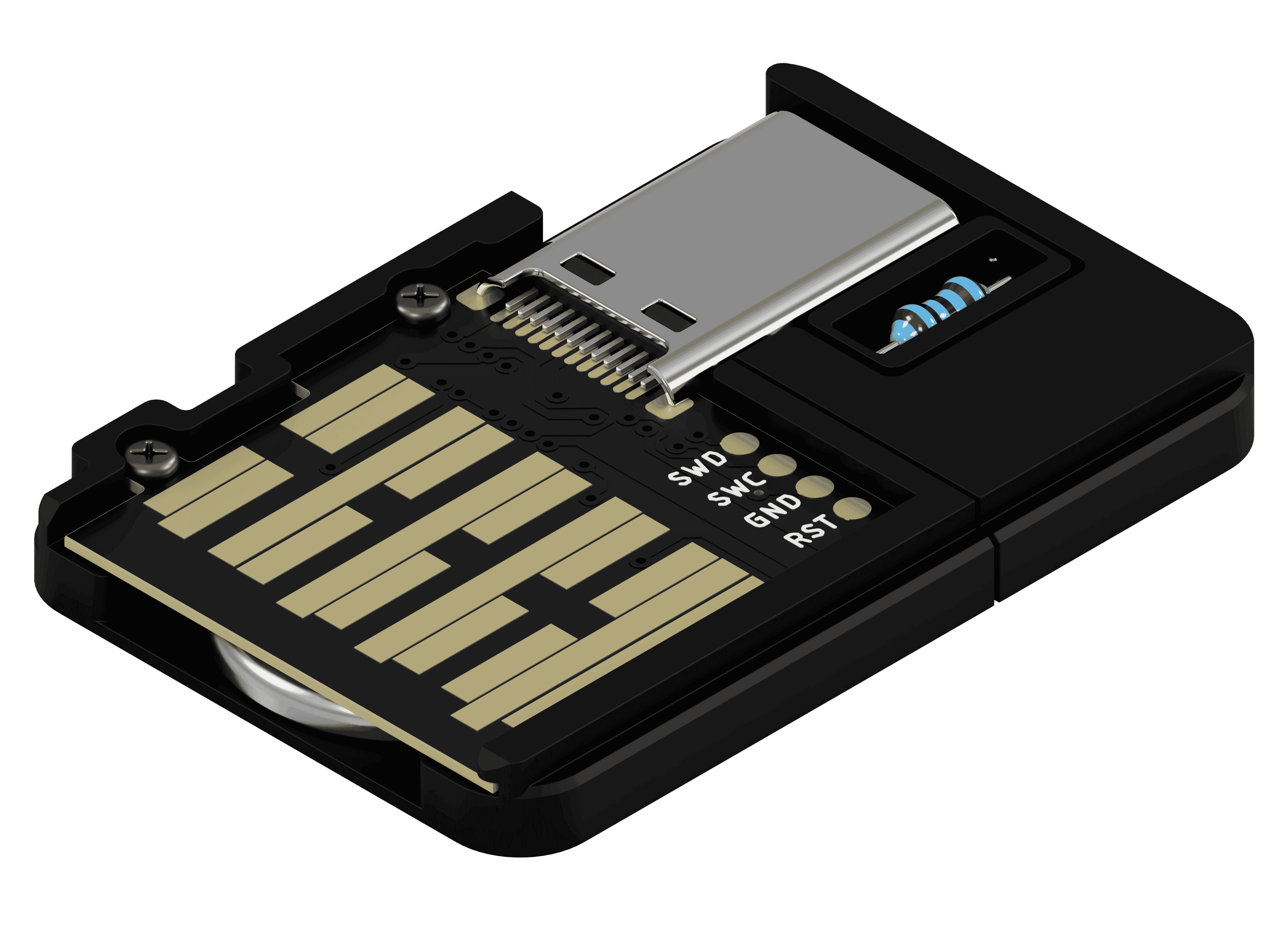

    Some news - no release yet unfortunately. In my testing today with the latest boards everything worked except the auto power-on. I had to move the transistor to the ground side of the power circuit to get it to work, which of course required ugly greenwires and the like. I seem to have forgotten transistors 101 and used the same source for the base and the collector. The PCB layout has already been fixed and the new revision was sent off about an hour ago for manufacturing. In the meantime, I'll be using the frankenjector I built today to get the firmware stuff out of the way. I'm also going to try and get the box art done for the case before the new boards arrive. The game-cart enclosure is already complete and works great. There are pictures in the Discord.
    In other news, I've decided to make a part-picker and reheat oven my Christmas gifts to myself, which I'll be ordering this Thursday and will theoretically arrive a week after. With those, I should be able to get 100-200 DragonInjectors put together, tested and shipped per week. (But even if there was no DragonInjector I'd still buy them for my other projects!)
    Believe me, I wish I was telling you all today that the prototype is complete and testers were going out. I have friends and coworkers asking me every day when they can buy one, and of course I want one for myself! Day job has kept me very busy as well which hasn't helped. In any case, my goal is to get this project out of development before the new year.
