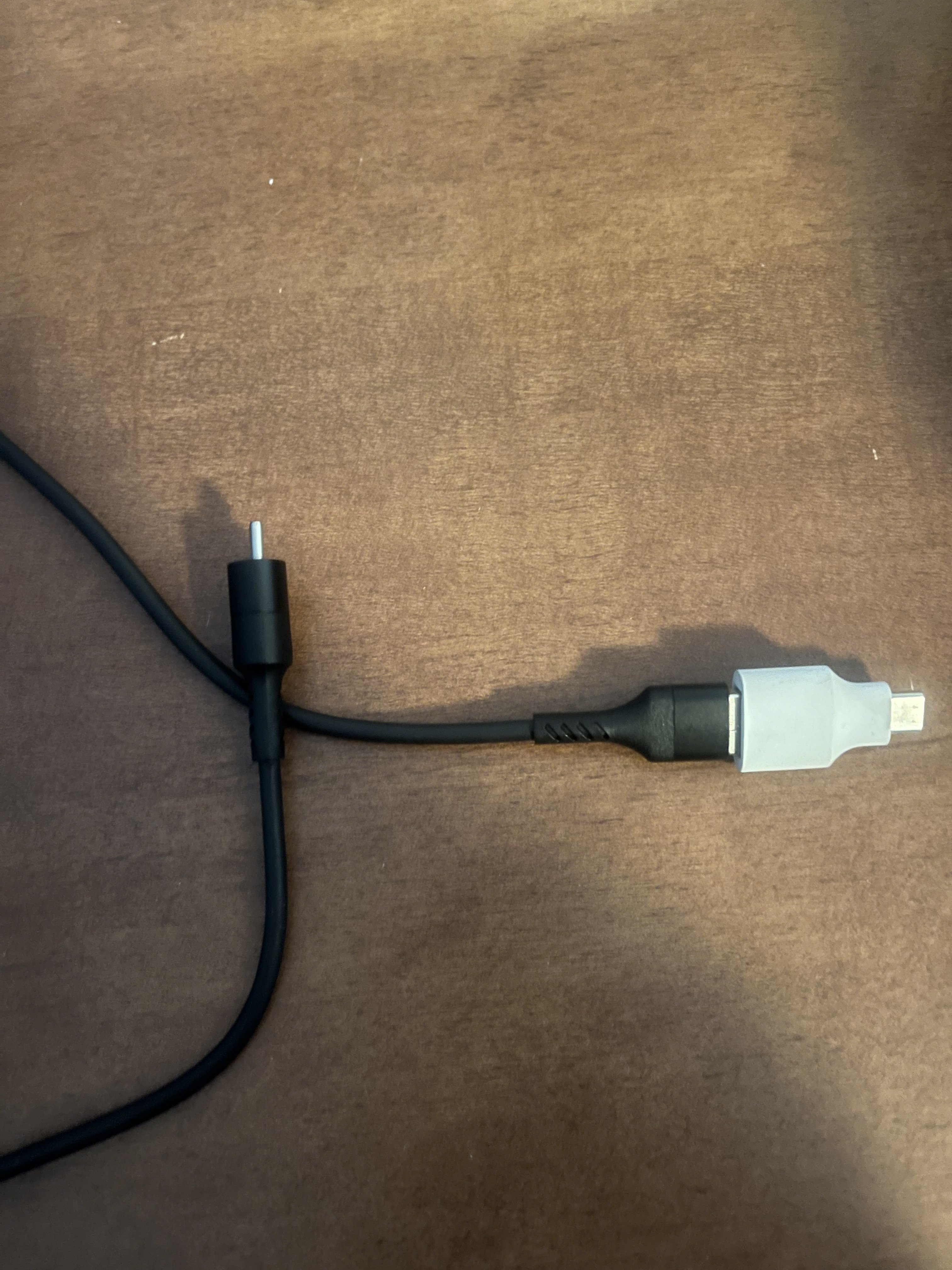

What a weird phenomenon. Does USB-A prevent the Mac from trying some sort of negotiation or something?
I think it works better if you convert from C to A, then back to C.
The setup in the photo attached works reliably. Using a standard USB-C to USB-C cable almost never works.
Yeah, I’m w/ @halfashark on the protocol negotiation thing. I think having the USB-A connect in the chain ”prevents” something(?) from happening that normally occurs on a straight C2C cable.
Could be. I don’t currently have a USB-C logic analyzer to see what’s happening but it’s on the list of things to get.
