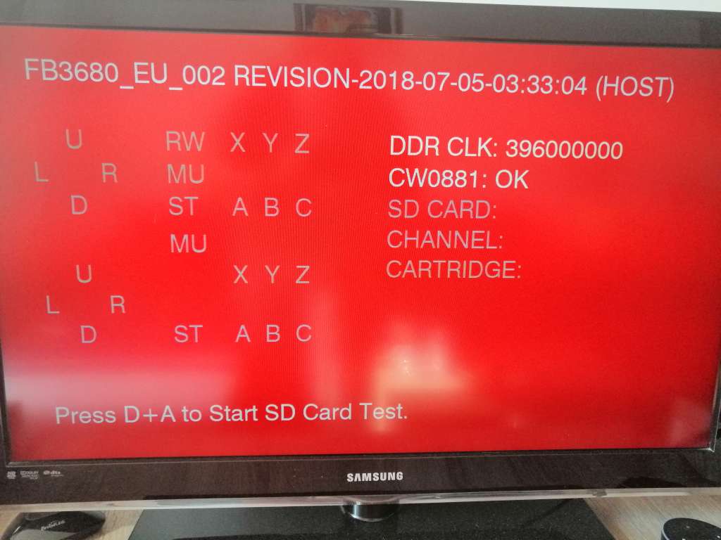

I have bought some second hand at @ames Sega Mega Drive Flashback, i has been good price. But when i connect to TV i got this on screen?
Red screen with some error says press D+A for SD CARD TEST
Anyone got the similar problem, is it possible to fix this somehow, i hear music in the background?
Thanks in advance

@mdancevic I had this problem with one of my units and I could not get it to work. I tried updating the firmware but it did not help. Maybe opening the unit up and flashing using Android Tools might work but I didn't try this as it was easier to just get a replacement.
rrifonas
Jan 28, 2009
258
1,265
I replied to him on the other thread he opened with the same request.
I will send him a full flash and the tools to backup this device (I'd like to understand why it gets stuck in test mode) and flash the firmware.
