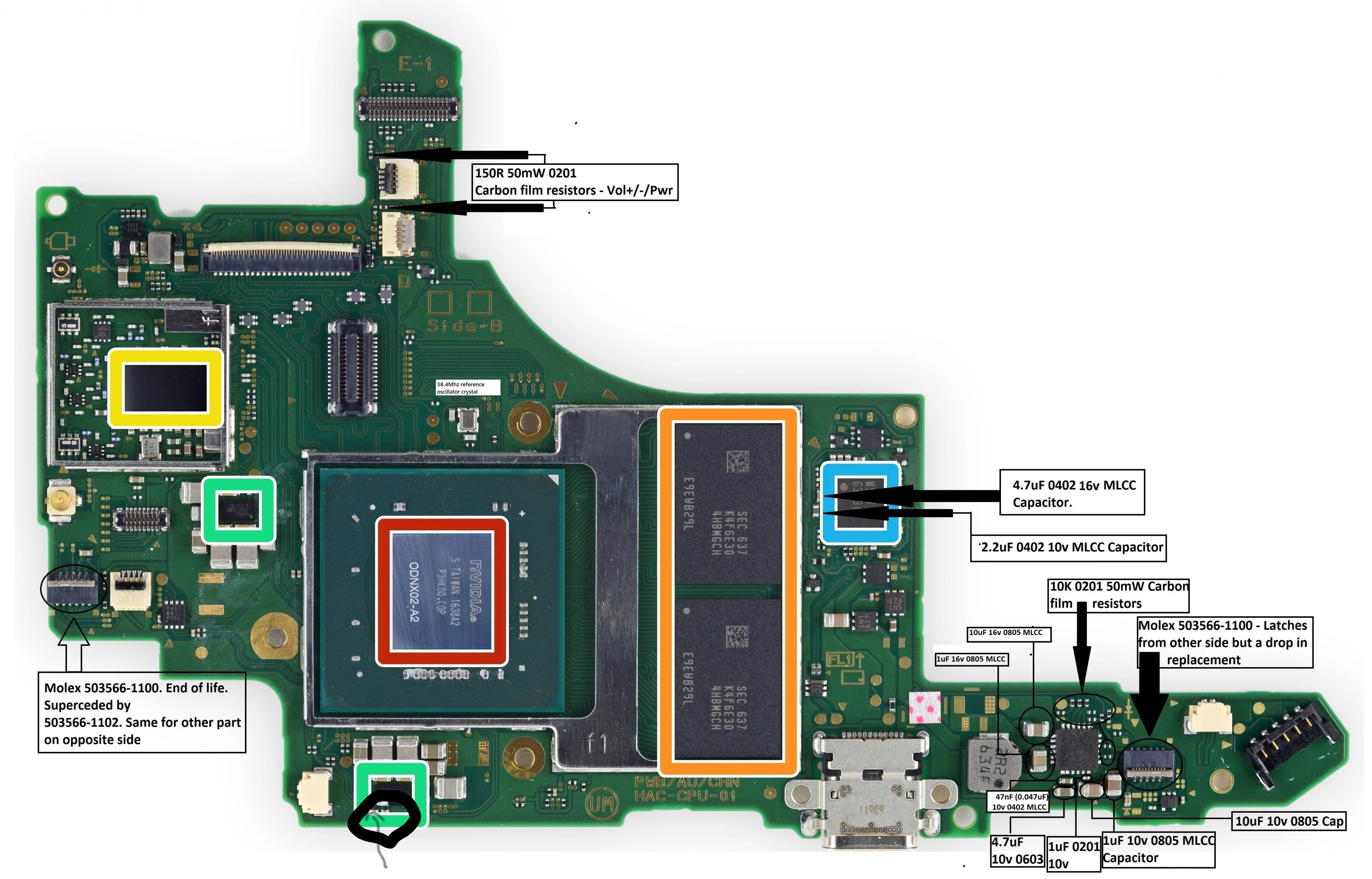

anyone have values for the following components.
Credit to Calvin, Diode mode

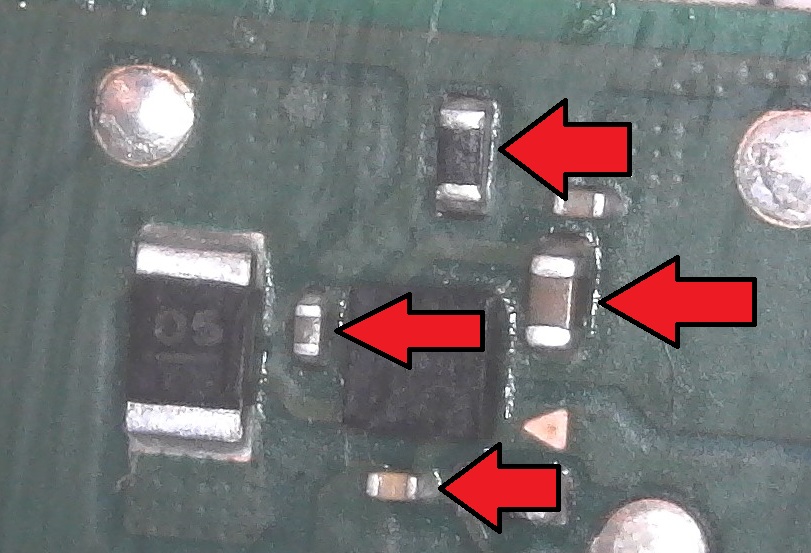

Can someone tell me what the component values are in the image please (from an Erista mainboard)?
According to the MAX17050 datasheet, the two capacitors on the left and bottom of the image are 0.1uF and the capacitor on the right is 10nF.
I think the resistor is 100K Ohm, but I want to be sure before I go ahead and replace anything.
Also, are they all SMD 0201 components?
Thank you.

Any luck finding out what component this is? Got a short on mine too and was thinking to replace it. Also wondering if it may signify failure of another component.
I also have a spare board that also has ground readings on both sides of that component. This board didn't work and I never found the problem. Could definitely be that as the same components on the other side of the board don't read ground.
Keep us updated on what you find.
Reactions: otaconn23

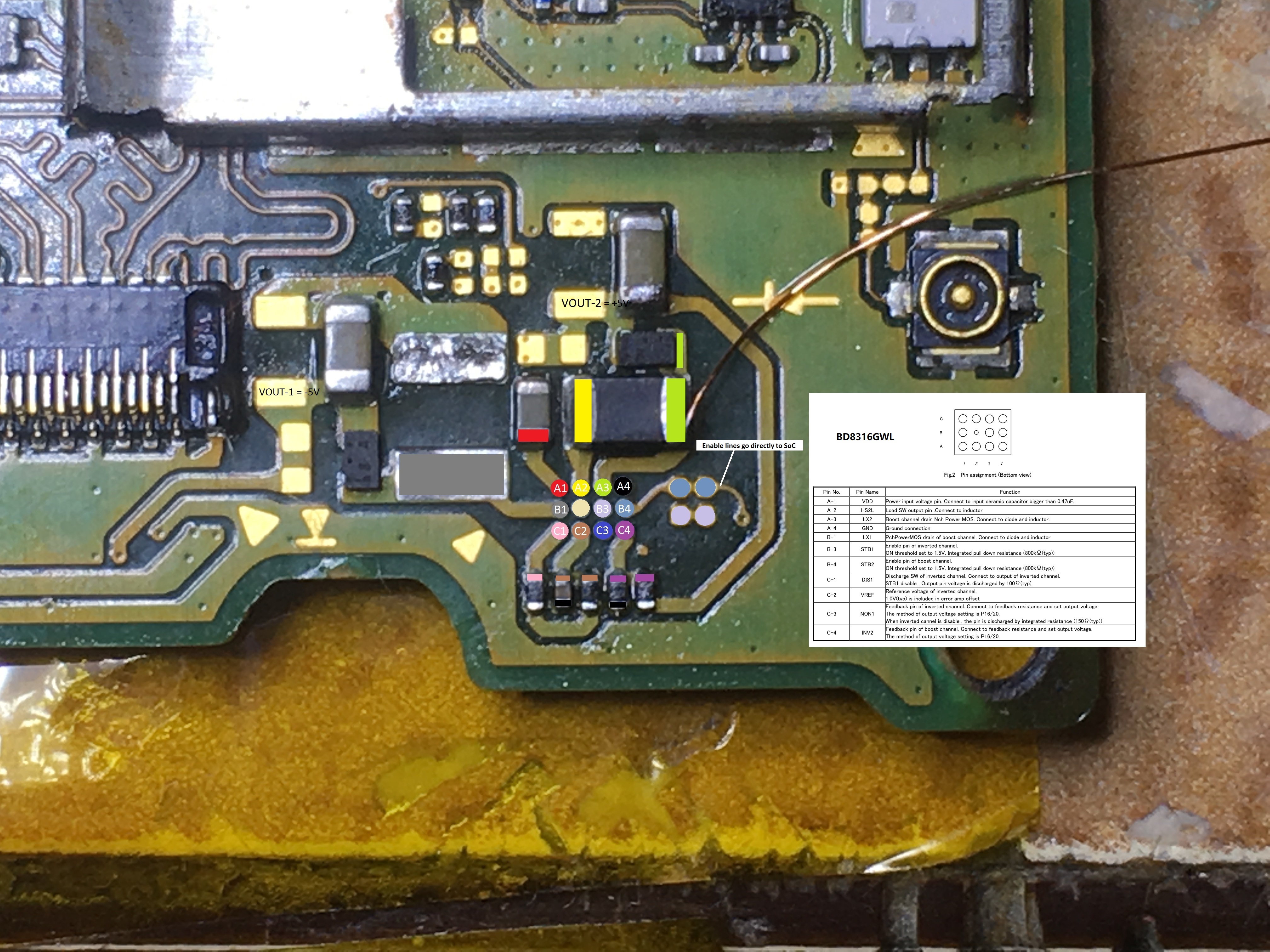

otaconn23
Aug 16, 2020
29
113
94
That is a coil and by design, it goes ground and it's normal there.
Many thanks! So to my understanding, the component in my photo is a COIL and could be faulty because it should not read ground on both ends, correct? If so, I'll need to order the COIL. Should I replace the IC (BD8316) too?
BTW is there a way I can get my hands on a schematic that outlines the components on the board? It would make repairs a whole lot easier.
White_Raven_X
Hack everything, hack the world!
Sep 23, 2019
627
45
1,543
jkyoho
Sep 2, 2020
1,270
39
TORONTO
form.jotform.com
2,201
No, you misunderstand my point. You should have ground reading both end of this Inductor coil. Just take a look at the PDF link from above. the BD8316 IC LX1 LINE(B1 Pad) goes to the coil and goes to ground. SO reading both side ground on this COIL is OK!
What is the resistance across that removed component? Isn't it an inductor?
It a 4.7uH
otaconn23
Aug 16, 2020
29
113
94
Aha, thanks for that boss! I need your advice then pls. I got a stock V1 no charge/boot, no water dmg, battery 4.12v. No shorts to indicate failed M92 or any other IC for that matter. Any tips on how to further attempt to diagnose?
