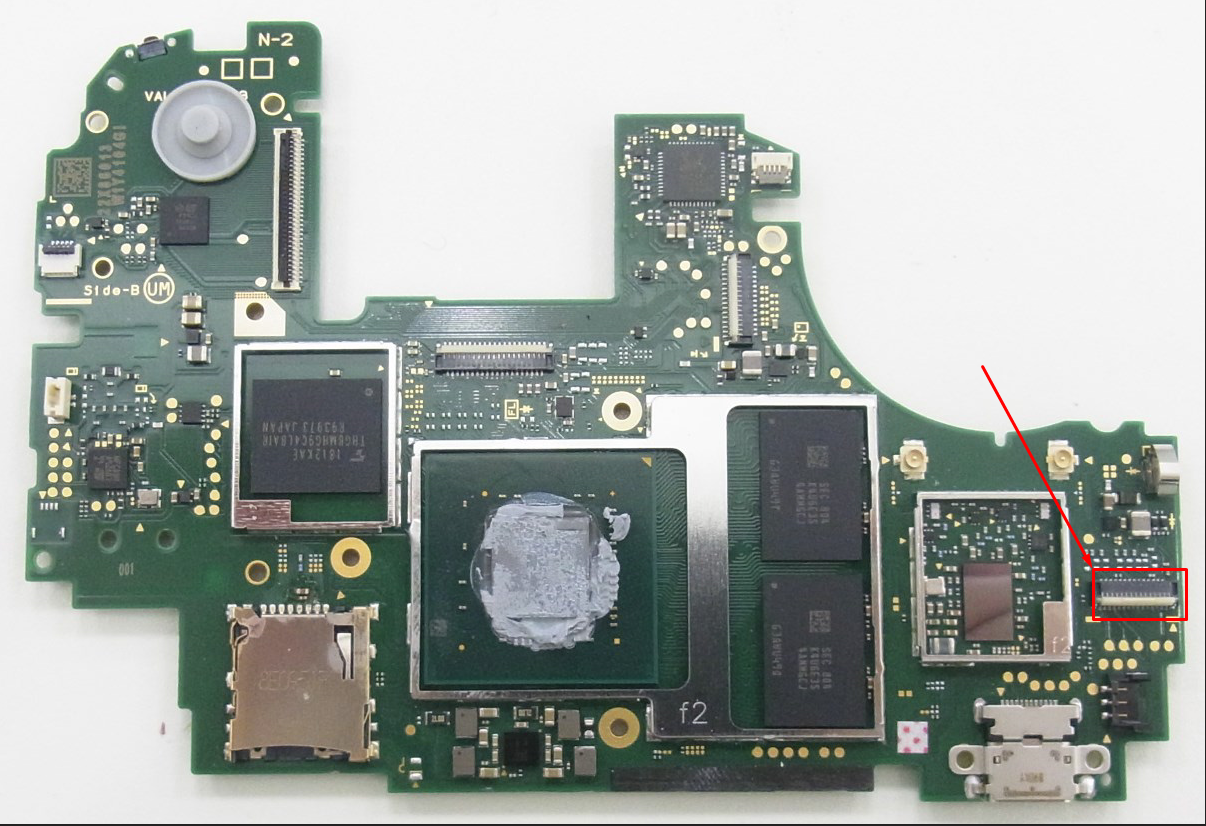

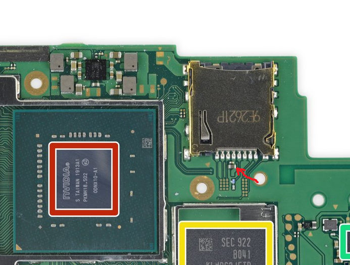

Can anyone help me with the one pointed by the red arrow?
I pried the connector in the wrong way and this one is now missing. I tried measuring it on my good switch and it seemed to have no continuity at all, like an open line. However it doesn't look like a capacitor either. I also have not been able to observe any ill effect after missing it.

Resistor 0.13 Mohm, size 0201, mesured on board.

Set your multimeter to resistance and move the dial until you read something , on my crap unit ut50b i gett a reading on this resistor only on 200M range
My multimeter tops at 2000K. For sure I tried this stop since nothing came up for the others, but couldn't get any reading.
If it was 0.13M/130K, I should be able to get a reading, right?

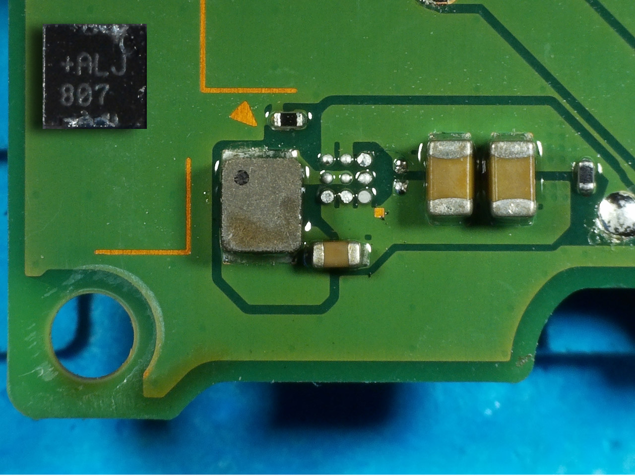

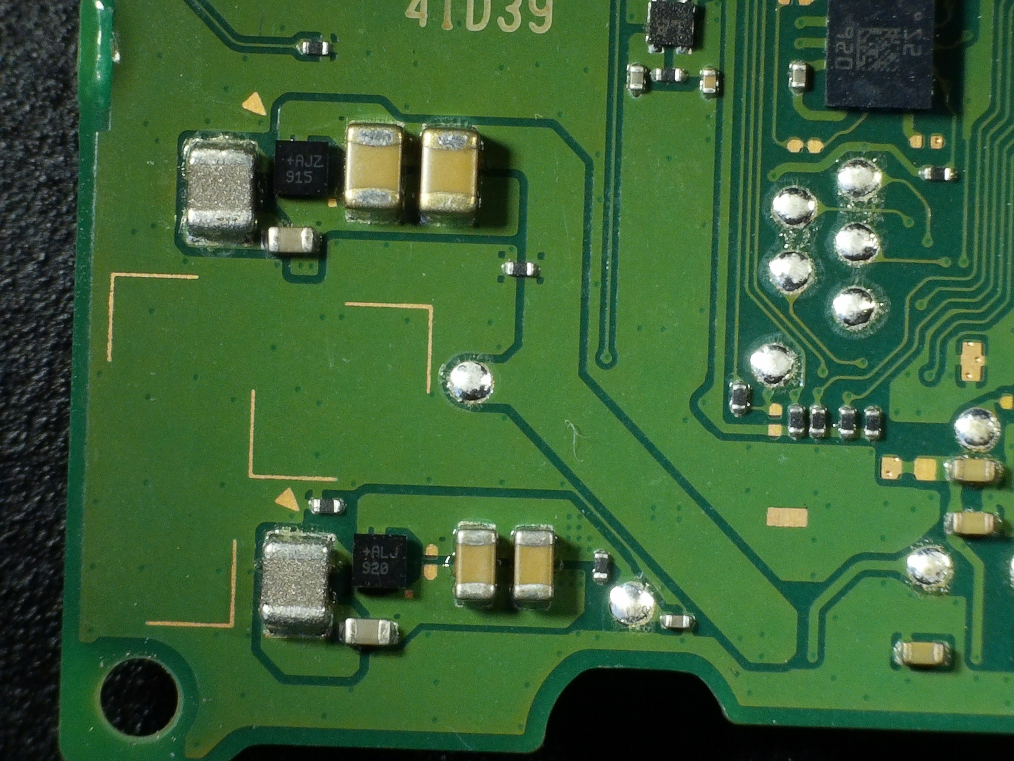

Anyone got an idea as to what this 3*3 BGA chip is?
Pulled from the site you see here on a HAD-CPU-01 board, and with the markings +ALJ 807
MAX17050
I doubt it. The other MAX 17050 chip on the board is clearly marked. This one is on the opposite side of the board. Are you sure? On another card of same design, they are named +ALJ920

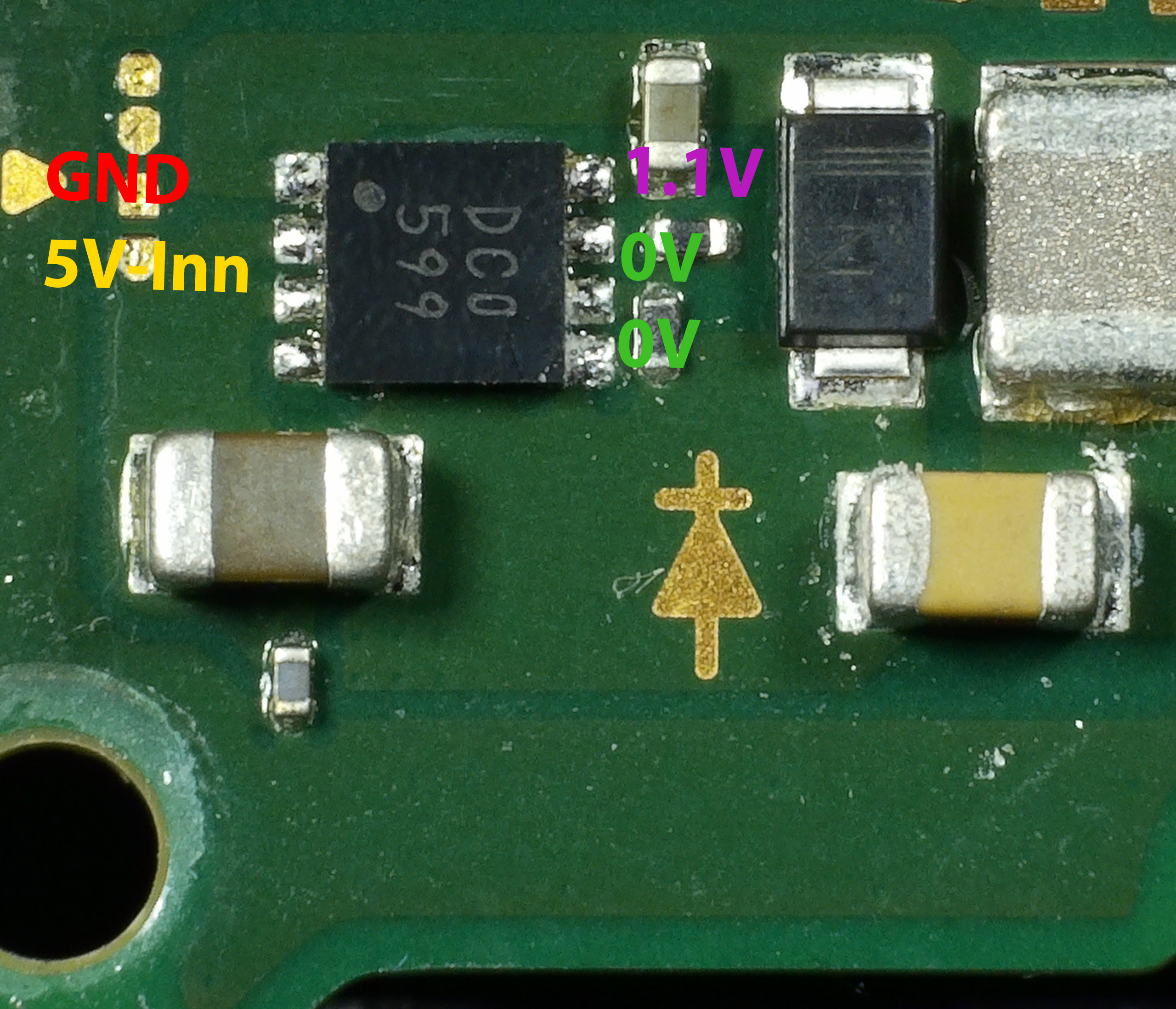

On a newer board, HAC-CPU-10, this is what they use in its place. Voltages shown are with only 5V USB charger inserted to plain mainboard with no battery or other things connected. Another place suggest som kind of buck/boost converter from Maxim (future Analog Devices).
